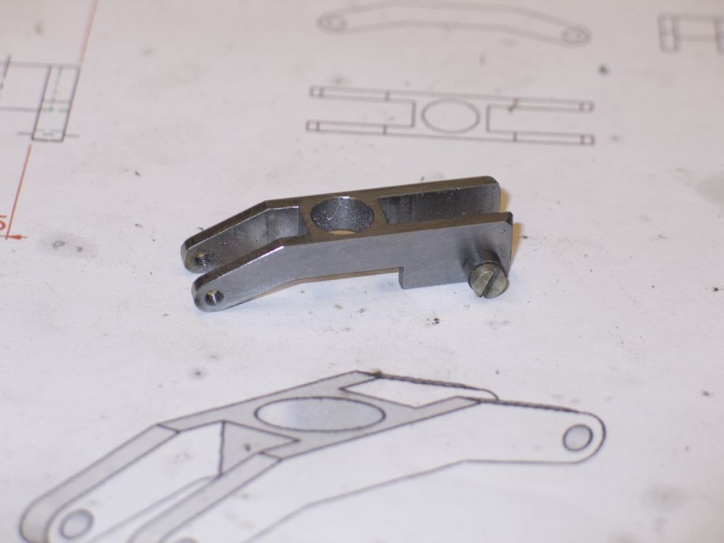

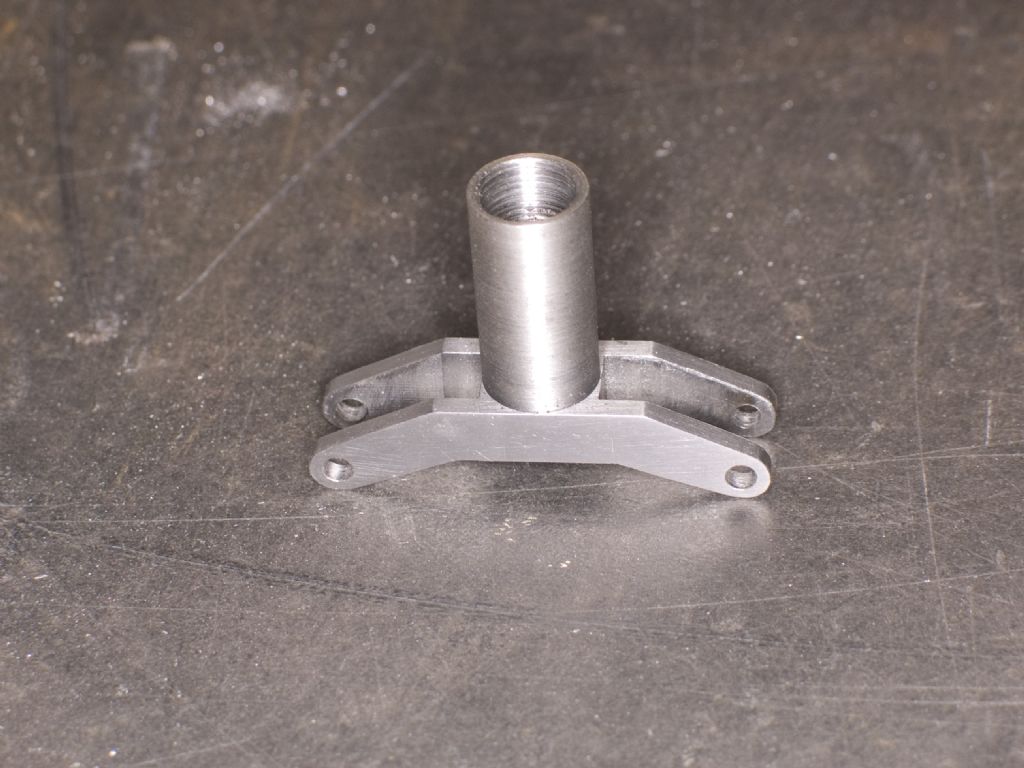

You could make some hardened filing buttons and use a selection of files with progressively finer cuts to get a good finish.
This should give you an idea of what I mean.

1. Filing buttons - I don't harden my buttons, but regard them as sacrifical
