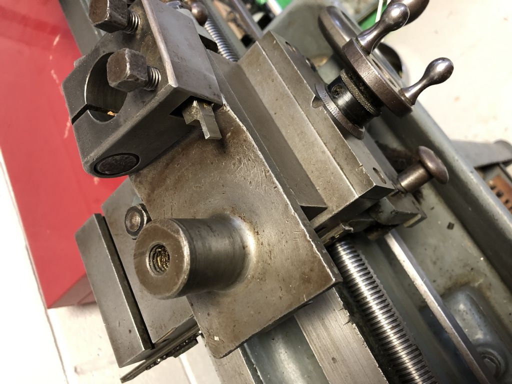

Thank you all for your kind words. Great to have joined such a friendly and knowledgable group! I've got some small bits and pieces lined up mainly jig type fixtures for woodworking. However I expect to try my hand at something more substantial once I've got to grips with the M Type, at which point I'll no doubt come back looking for advice. The only question I have right now (David) is whether you have managed to acquire or make a quick change tool post? The standard "Norman Patent" design I recall being very fiddly to get the correct tool height. Thanks again for the warm welcome.
I removed the old tool post and machined a diamiter to suit location on toolpost then drilled and tapped for bolt.

Thanks David, your mod looks exactly what I need although not sure how to get over the hurdle of needing to machine the machine that machines? What was your solution? Did your post look like the attached? It looks like its threaded 1/2"BSW so not compatible with your M10 fixings?

A possible solution would be to find someone locally with suitable machines! How local is Kendal to you?

My lathe was just like yours and the post was only drilled part way down. I just hacksawed the post down and got a friend to machine the post base and tap the hole through. The hole in the toolpost was smaller than the location diamiter so he also milled that to size for me.
