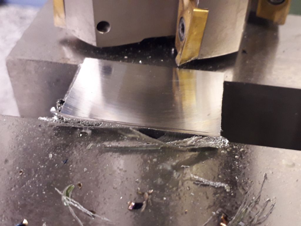

Two videos and some larger photos to go with the review of the ARC Euro Trade indexable endmills and shell mills in MEW 289. Video best viewed direct on You-tube so the captions can be read more easily.
The cutters being used on Sieg X3 & SX2.7  Mostly the 63 & 80mm shell mills on a mix of cast iron, steel and aluminium.
25mm Indexable Endmill being used on Sieg KX-3. It would have taken a faster feed so a bit slow in the video, I was wary of the larger amount of engagement in the internal radii causing chatter but need not have been
Two larger photos of the finish on some unknown steel cut with the 80mm Shellmill on the SX2.7, click any image to enlarge further.
Assortment of materials cut, from L to R - Cast Iron 6082 Aluminium EN3 and unknown steel with the CNC machined 6082 part in the foreground.

What spindle speed Jason? Is it likely to give the same results on a non cnc machine? Thanks.
JasonB26/12/2019 17:33:27
avatar
25215 forum posts
3105 photos
1 articles
Cutting speeds are in all the captions and only the last fancy shape was on the CNC so rest done on machines with a max of 2000rpm, again machines used in captions. Cuts on the SX2.7 also show th espindle speed display
Depending on diameter the face mills were run at 600-800rpm on steel and cast iron and 1750-2000rpm on Aluminium and smaller 25mm dia one at 1750-2000rpm on steel and iron on tmanuals and 5000rpm on te hCNCto give the cutting speeds shown.
