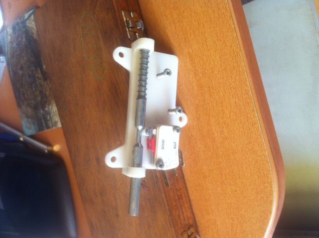

Ramp down times on decent quality VFD units are very consistent, certainly better than (normal) human reactions, so it shouldn't be an issue. You already have motor coast down to cope with. Ramp down time need not be much greater. 5 seconds should be ample, I'd probably try 3.
Consider making a bed stop with a sprung loaded microswitch inside. Connect the switch to the inverter controls and set the stop so the switch operates at the end of the thread. No more worries about stopping the motor in time.
Something like this inside the stop block would probably work :-
That one was stolen from the lid mechanism of a spin drier rusted out after 20 odd years so the concept is reliable.

I planned to use a switch actuator based on the one in my picture with a 6 position turret type bed-stop head having a short spring loaded slide incorporated in the mounting clamp. As is so often the case it got over designed with built in micrometers for easy setting (gotta do something with those half inch travel heads in the useful box) and interchangeable length rods. So its 15 years on its still at back of envelope stage and I'm still doing fine with the dumb 6 way turret I've had for the last 30 - 40 years!

I find the sliding potentiometer idea an interesting concept and worth bearing in mind, however, your bedstop switch is much simpler to execute and will be my first approach once the VFD is up and running.

With the microswitch, you have to position the assembly some unknown distance before the stopping point to allow for the ramping and then judge the exact switching point of the switch (clamp it in place on the 'c' of the click and not the 'k'. As you showed in the picture, the mechanism needs to have over-travel capacity in it. The tumble dryer one is an excellent source.
