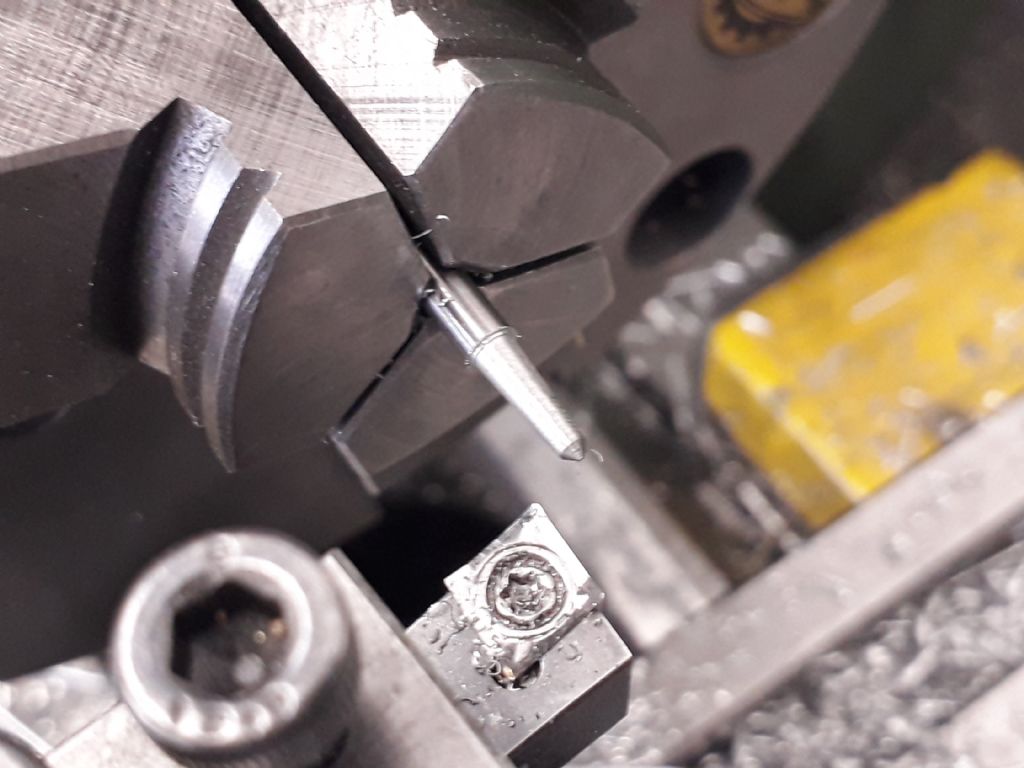

Hi, I have machined EN1A with no problem. The project I am undertaking needs to finish it a 1 and 1/4 inch long by 1/8th piece of round silver steel to be machined. I have now twice bent 2 pieces of metal in my attempts.
There are obvious possibilities like the HSS not being sharp enough and possibly the wrong speed chose. I am using a Sherline lathe with a 3 jaw self centering chuck which is not part of the problem.
to machine a thin piece of Silver steel only held by one end means the cutter has to be spot on.
Any thoughts or tips appreciated.

The most likely solution is that too much of the work is sticking out of the chuck. If that is the case then everything else is secondary. What are you trying to do? Even a light cut will be enough to bend 1/8" silver steel if too much is unsupported.

As Andrew says if you have as much sticking out as you did with that hex stock yesterday then that is the problem. Have less than 1/8" sticking out assuming you are facing to length.

OK More detail but not sure I haven't given enough already as it all comes down to a piece of 1/8th dia eound silver steel that approx half is turned down to fit in the punch I have made from EN!A. So one half of the S>Steel needs to fit in the 2.5mm hole drilled in end of hex mild steel and the other half of the S. steel needs tapering then finishing to a point.
problem is with approx 5/8th sticking out the 3 jaw chuck the S.steel is very keen to bend. On the Sherline there is variable speed the max being 2800.

I'd go with Neil, make the hole 1/8". Or even better just make the whole thing from one bit of silver steel. If you must turn the end down, start with about 3/16" sticking out. Turn it down to the correct size and note the cross slide reading, Move the material out another 3/16" and starting at the un cut point wind the cross slide handle in to the previously noted reading. Machine down another 3/16" and so on until you get the required length. It's not a pretty solution but perfectly acceptable in this application. If the finished shaft doesn't quite fit you can always do some gentle "mods" with a needle file on the high points.

JasonB25/08/2019 15:16:51
avatar
25215 forum posts
3105 photos
1 articles
So staying with my approx 1/8" sticking out this is one way to do it without having to bother making tools to make things which is an ever decreasing spiral.
Saw off a bit of rod just over 1 1/4" long and face off
Now turn what is still sticking out to 2.5mm dia I did it in one pass
Slide the work out another 1/8" so total 1/4" sticking out and reduce the next bit to 2.5mm
And again
And again
One more tine and you should have 5/8" now at 2.5mm dia
Now reverse in the chuck again with 1/8" sticking out, set topslide over to 45deg to give the 90deg included angle for your punch and turn a point
Set topslide to taper angle about 4deg and with 1/4" sticking out turn the taper on that bit
another 1/8" etc
last bit will be cut while holding by the 2.5mm dia
Job done

Thanks Guys I agree the easiest solution would be to increase hole size to accommodate 1/8th S. Steel. however this is a learning project for me to get me more familiar with thev lathe having done little before on it. My objective is to gradually improve so I can undertake more precision machining on the Sherline. With that in mind holding delicate small items whilst machining is critical so solving this immediate problem with a bigger hole will only defer the day I have to solve the issue.
That said machining shorter lengths sticking out the chuck is definitely one way forward. Obviously if I manage to improve enough to machine very small items then i would invariably be using a collet and not the 3 jaw chuck.
Can anyone give me a pointer as to appropriate speeds for such small dia S.Steel baring in mind max is 2800.
I also appreciate I could use a steady rest but for precision work that as likely to be inappropriate as would likely get in the way.

Great post Jason and very helpful. I too manage to reduce to 2.5mm in one go (several light goes) but foul up by having too much sticking out for the taper. I think the 1/8th at a time on the taper will sort it. Question: what insert are you using Aluminium with 0.02 nose radius?

But hos help is greatly appreciated and at last flaws and all I did it.
