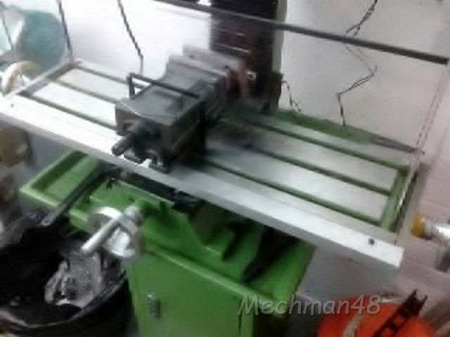

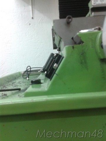

mechman4808/08/2019 08:23:02
avatar
2947 forum posts
468 photos
I have fitted X & Y axis remote read out scales to my WM16, a straight forward job to do. I made a couple of extension spacers to allow me to use the X axis stops,& fitted an aluminium angle to cover & protect the read out head. The X axis is fitted on the front of my machine so I don't lose any Y travel, has worked fine for me for the past 5 years. Well worth doing.
George.
