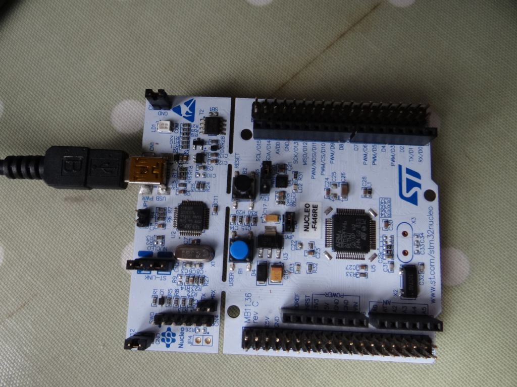

By strange coincidence my Rotary Encoder arrived from China while I was watching the video.
I'm messing with this via Joe Noci's Electronic Lead Screw, and Duncan Webster who is looking at building one. My interest is more in programming microcontrollers than making an ELS but ELS has some nice challenges. Joe in another thread got me investigating ST Nucleo boards rather than the usual Arduinos I mess with.
For £13 the Nucleo F446RE board is considerably more powerful than an Arduino, in particular it should have no trouble counting 4000 positions per revolution as shown in the ELS video. (Be careful buying encoders - I accidentally ordered a 1000 positions per revolution encoder due to not reading the small print...)
Arduino fans can program Nucleo boards from the Arduino IDE and treat them as a kind of super-Arduino. Compatibility is good, even though it uses 3.3V logic, so not all modules will work directly. Also not all libraries are compatible, though quite a few are. Relatively painless conversion for anyone already familiar with writing code for Arduino.
Not all Nucleo features are available from the Arduino environment, for example it comes with a built-in Real Time Operating System supporting threads and other advanced features that Arduino don't understand (yet). At the cost of learning a new interface these can be accessed using an online IDE called mbed. If you are already into C++, likely you might find mbed cleaner to code than Arduino, but not so well supported in terms of hobby libraries.
I found compiling mbed online to be rather restricting, but it's fairly straightforward to download the environment and use it locally either with an IDE like Eclipse (several other alternatives available) or as a raw editor / make project. The latter is particularly suited to experienced programmers. As a Linux fanboy I've not tried mbed Studio because it's only available for Windows and Mac. Looks good though and it's nice they don't force you to use it.
Can you modify your code so that it reads every edge of the quadrature pulses? Then the 1000 ppr magically transforms into 4000 ppr.
And from DC31k (???)
Exactly how it works in my ELS implementation - Actually, I used a 1024PPR encoder for the spindle, and generate an interrupt on the rising AND falling edge of each of A and B channel, giving 1024 X 4 counts. Important for the spindle encoder though, you must use an encoder with a Z channel ouput, ie, an index pulse per revolution. For the spindle encoder in my ELS code, within limits, the higher the PPR the better. Less than 4000 pulses ( 1000PPR encoder) is not recommended..
