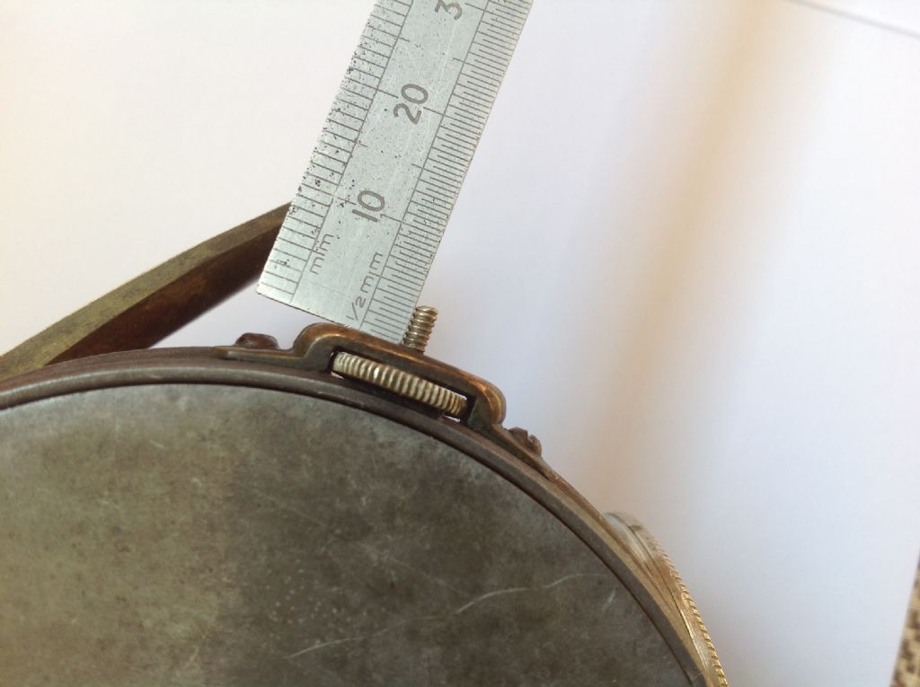

Could be a case of faulty thread identification - it's not easy, what with Whitworth, UN, BA, NC and others in coarse and fine variants. Can you put up a photo of the male thread next to a mm rule so we can eyeball it? (Howto post photos here.)
Nearly Done26/06/2019 17:01:59
14 forum posts
3 photos

Should have said OD of thread is .085"
looks to have 44tpi
Nigel Graham 226/06/2019 21:10:10
3293 forum posts
112 photos
This is a rum 'un....
44tpi is not a standard Whit-form thread. Studying the Mechanical World Year Book 1957, and your supplied information, I reckon the following:
It's actually metric but not from the modern ISO Series.
So:... 7BA? BA is in fact metric, based I think on the old, Swiss Thury thread.
OD for 7BA = 2.5mm. Pitch = 0.48mm.
Enlarging the page to read the photo better...
Pitch by the rule: a gnat's crochet under 0.5mm.*
Dia. measured = 0.085 " = 2.16mm but could be accounted for by over-rounding when cut, and by wear in service. The thread does look as if it's seen a year or two.
So I reckon the nearest standard to the photographed screw is 7BA.!

Looks a bit metric to me too! What's the item? I'm wondering if it's antique, continental or perhaps a trade specific thread.
This table identifies some arcane possibilities. Whitworth Instrument & Thury are both candidates.

Its a rum'um. That thread was cut c1910.
strangely the nearest thread on gauges I have is metric .6 60deg but that's a 3.5mm ISO !

Thanks Dave I'll take a look, it's off an old English Fishing reel.

Posted by Nigel Graham 2 on 26/06/2019 21:10:10:
In an attempt to calibrate the aforementioned gnat's appendage:
I reckon five pitches to be 2.947mm [ish]
2.947 ÷ 5 = 0.5894
So [allowing for perspective effects, and general incompetence on my part] I think the pitch might be either 0.6mm or 43tpi
BUT if it started life at 5BA, it must be very worn.

Looks like a Hardy Perfect strapped tension adjustment lock nut, most threads on these are BA except the centre locking screw in the spool and these are either 1/8th or 5/32 LH Whitworth. The thread does not look worn to me so I would make a new nut from nickel silver or brass -- the were made from either material but usually match the adjuster which on your reel is Nickel Silver.
Worth noting on many of these and gun locks the threads are very near but often oversize due to wear on the dies use -- interchangeability was not a issue back then.
