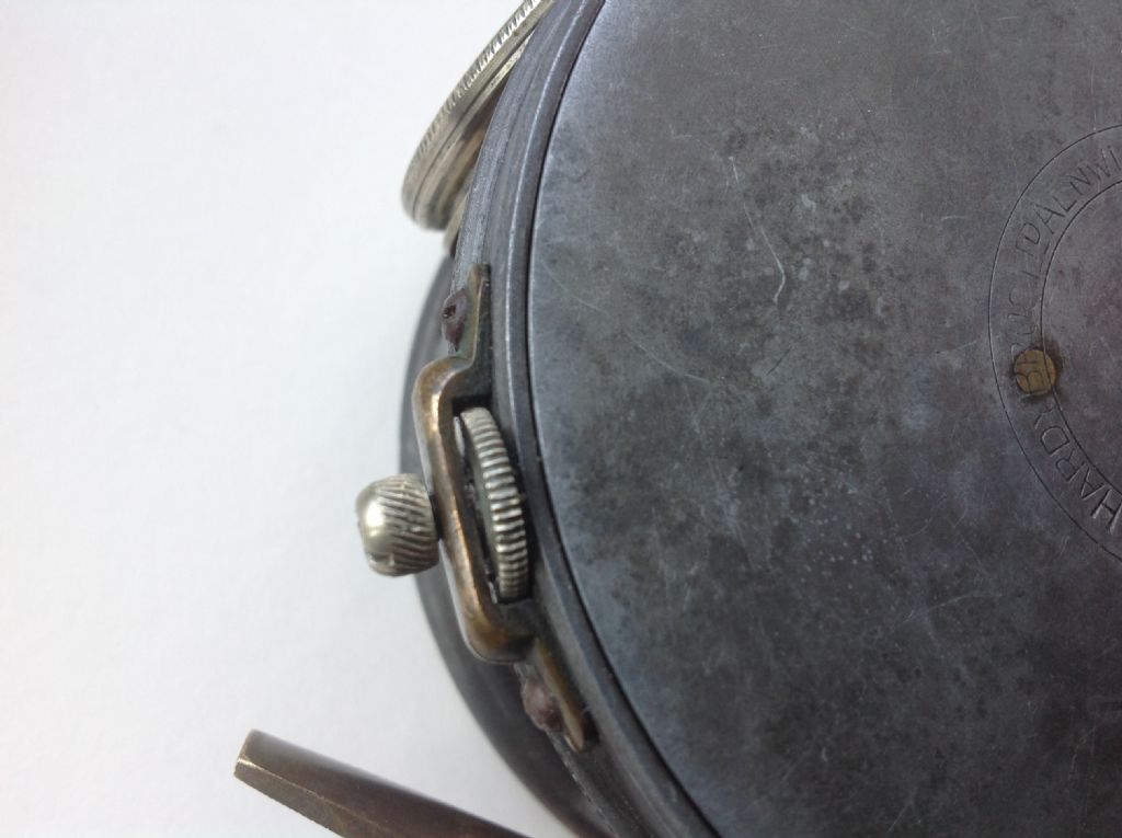

Yes John is correct it's from an early hardy perfect. I did do some research before getting the nut made and even ran a brass 8BA nut down it, but that nut was not very thick
I think John could be right about oversize due to old tooling. I think I shall try an 8BA die on the stud and see how it feels.

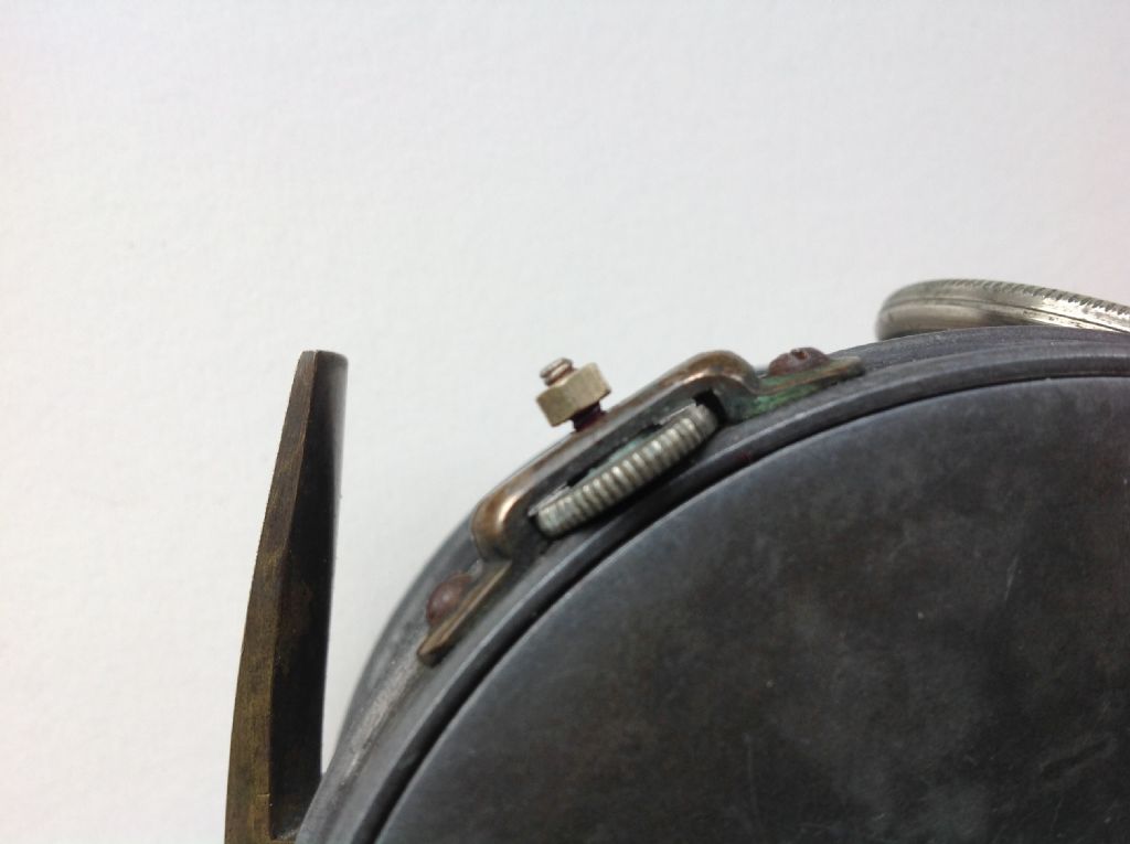

Should have said OD of thread is .085"
looks to have 44tpi
