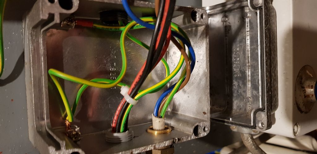

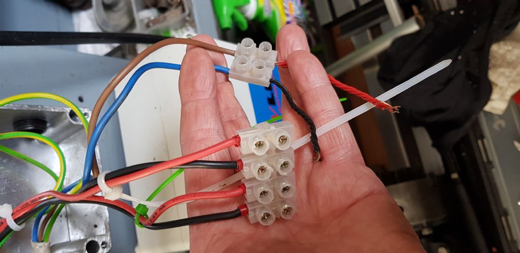

1st photo shows the wires to the old switch feed wires and pairs of the forward/reverse. I have marked the pairs of wires with two different coloured cable ties.

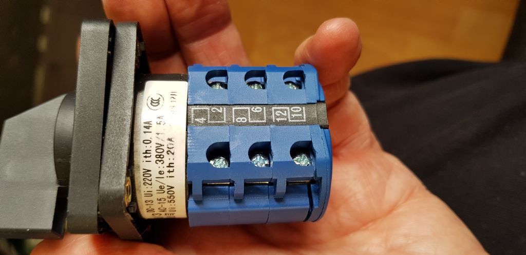

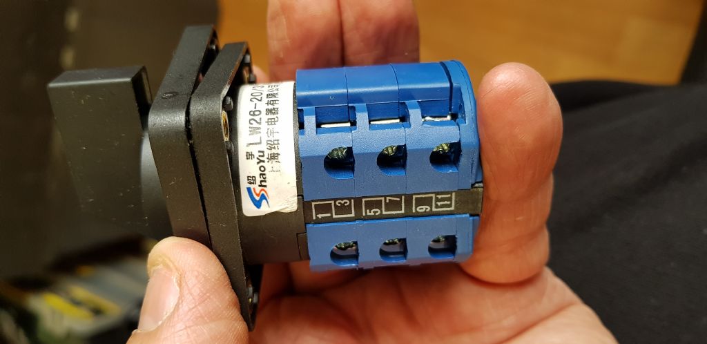

Second and third show the replacement switch with LW26-20/3 which was sold as a three phase switch.

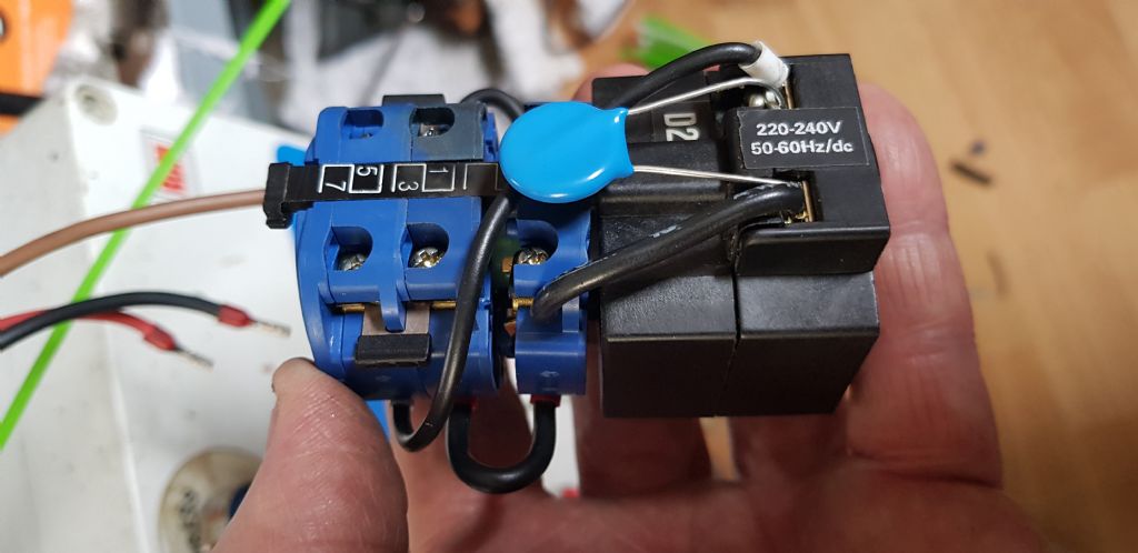

fourth is the old switch with a capacitor. I have several shots to show all the wiring for this switch but not sure if they are compatible?
Possibly the /3 refers to three switch positions rather than three phase?

looking at your last photo
the original switch incorperates a no volt release ( I expect the black part is a 220/240V coil )
I would of thought the 3 blue cam switch elements may of been wired like this

The new switch is not suitable as it does not have a no volt release coil. This is a safety feature and it is likely that the emergency stop will not operate without it.
Robert G8RPI.

Thank you both for your replies. It makes sense as there is an extra part on the top of the original switch. I guess I will be looking for a replacement as the old one does not latch. Is there a chance you could point me to a suitable replacement please? Lathe has been sitting for a month and I'm getting withdrawal symptoms now 😥 Sorry for late reply.

20190524_011827.jpgI have given up looking for a new switch and despite thumbs for fingers I have rebuilt the original switch. The switch is still not latching but as is soda law the Lathe wont spin now. Probably user error I guess. OMG I struggle adding photos on this forum. Text too it seems. Does this match what you thought in your previous post and diagram John? Any help would be welcomed., chomping at the bit to actually use one of my many Lathes 😂
