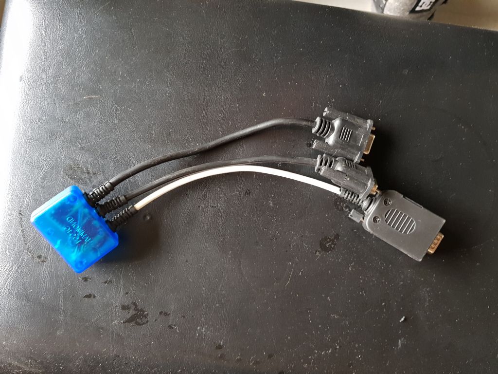

Hi all,
I've recently added a Ali-Express DRO to my Archdale 18" Mill. I was facing the problem of only having one Z-Axis and not knowing whether to attach it to the knee or the quill, so I bought a 4th glass scale from the seller and added a scale to both axes.
The DRO display only has one input for each axis, so I got an arduino nano via ebay along with a small enclosure and some RS232 cables. The two input cables attach to the scales and the output goes to the DRO display. The arduino calculates which scale is moving in which direction, sums them for an absolute position and then outputs that to the display so both the knee and quill can move in opposite directions at the same time and the DRO Z-position will remain correct.
Component parts came to about a tenner + labour time of assembling it and figuring out the code. It's possible to move the scales fast enough to out-pace the arduino and 'lose' steps, but my scales are 1 micron rather than the usual 5 micron so that's effectively limiting the maximum speed by 1/5th and even at that it's still capable of keeping the position correct up to about 100mm/sec so as long as I keep the quill retract speeds sensible I think it'll be okay.
The arduino gets its power from the 5V output pin on the DRO which supplies the glass scales, so no batteries / plug is required.
I'm an absolute amateur when it comes to the arduino stuff so it may be possible for someone to make the code much more elegant / run much faster but this does me for now.

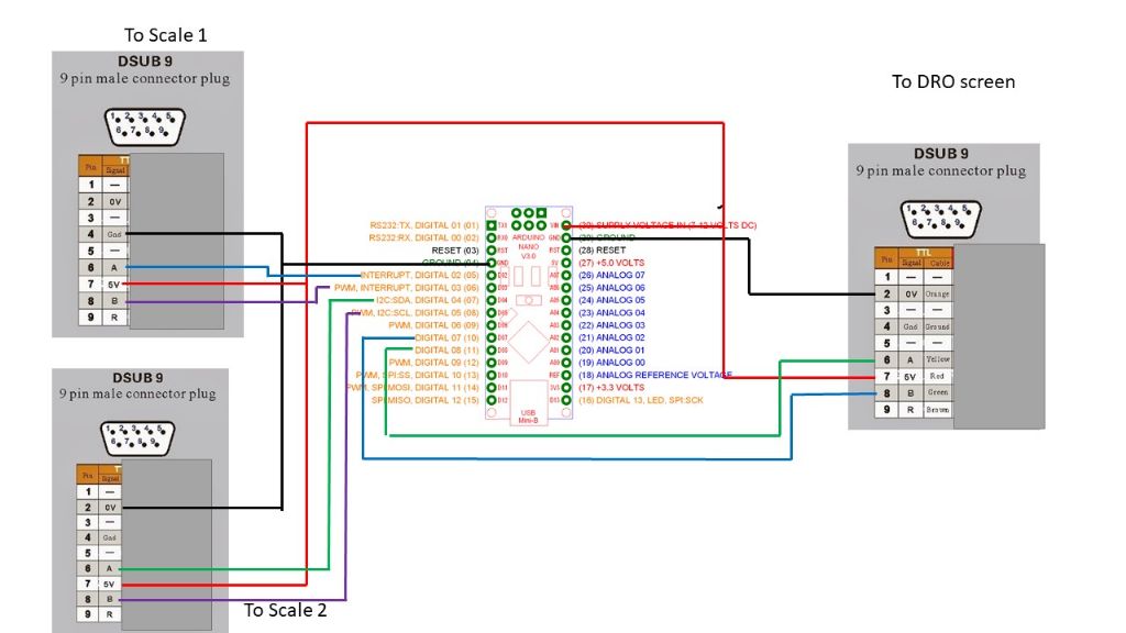

Kealan O'Carroll05/05/2019 09:35:56
9 forum posts
6 photos
Hi chaps,
As Les has said, the wiring is in the comments of the code, but Ive put a diagram below.
As per Dave's comment you might be better off with an arduino mega or something with 4x interrupt pins if you want it to run faster

I've just completed adding the quill scale to the column scale. It ran without any problems except it required a change in direction. I am using 5 mincron scales and it counts correctly even when I release the quill handle.
The pictorial wiring schematic does not correspond with the comments in the sketch and I used the connections in the sketch.

hi all , new guy here , have bought a three axis dro and have been looking at the idea of the axis combiner to give the the columb and the quill a shared z axis on the dro
i cant seem to find the sketch david is talking about and i am slightly worried with how the ground lines are hooked up on the schematic
scale one and the plug going intoo the dro has the ground (pin 4) hooked up to the ground tab on the arduino
but scale two has the zero (pin 2) hooked to the ground on the ardiuno , is this correct ?
have all the stuff needed here to make one but dont want to make a misstake soldering the thing up and after plugging it in release the magic smoke

A 'sketch' in Arduino-speak is what I'd call a program. The comments at the start of the program/sketch and the schematic wiring diagram (called in Arduino-speak a 'fritz' contradict each other in a minor way.
I used the screen in the SUBD9 cable from the display unit daisy-chained to the screen of the cables going to the scales, making sure there were no possible loops which can pick up hum.
Provided you don't do anything silly like connecting the 5v to ground I don't think you can do any damage. All the Nano connections to the scales are inputs and, I'd guess, the pins on the display are also inputs and the worse that can happen it won't work!

ok so it doesnt matter if i use zero (pin 2) or ground (pin 4) to connect the power out from the dro to the scales and the arduino ?

I'm not sure which pins you are referencing. There are at least two different SUBD9 pin-outs from/to the scales/display so the connections need to be checked for your setup. The website or manual should give the pinouts but . . . .
My display unit connections on the SUBD9, which are all that I used, are
pin 2 0v
pin 6 A+
pin 7 +5v
pin 8 B+
Pins 6 and 8 are the two quadrature signals and the other pair the power.
There is a PE (protected earth?) connection on pin 4 that is connected to the screen but I don't think it's a good idea to use it for the power because of the risk of earth loops which can cause electrical interference.
I rewired the plug from my quill to match the X, Y and Z plugs so they are all interchangeable. The screen is not connected to 0v wire anywhere external to the display unit but does contact the metal case of my Nano box and the screens of the two Z scale cables.
It might. Although 0V and Gnd are the same on the Arduino, they may not be on the DRO, which is providing the power. Makes sense for the DRO to put power between the 0V and 5V pins, but the Gnd could ba just a cable shield. As shields are often only connected at one end to prevent earth loops, the Gnd pin may not complete the circuit Try it and see - no risk of smoke because the Nano just won't power up if the DRO Gnd pin is floating. Or test it with a multimeter.
Electrical safety earths, signal earths, and RF earths are all a bit different, but as a rule of thumb it's not a good idea to carry power on an earth line. So if a plug has a 0V pin, use it, not Gnd. However, just to keep us on our toes, printed circuit boards often label the 0V line as Gnd, Vss, or other things. The Nano is an example of 0V = Gnd.

guess i connect the shielding together to prevent radio interference and connect the 0's together and to the zero on the arduino board , that way all the cables are hooked up the same way (to the dro unit) and the power side from the dro side will power the arduino like it does on the schematic so it should work the same way as a single glass scale would

seems like its the same pin out as the schematic , i have a chineese dro on order and my guess is that the pinouts are the same throughout as they advertize it will work on multiple chineese glas scales
like i said in the former comment i probably just make a 4 way central connection from all the three cables combined for the 5v pin and another one of the 0 pin and connect those with the fourt branch to the power input of the arduino
the A and B connections i connect as described on the sketch and as an extra i will twist the shielding of the three cables together (but whont connect it to the arduino )
that way the power side will be the same as it would be if it was the cable directly from the glass rule to the dro (just split up) and the signal gets processed by the arduino like it should too
allso thank you for youre help
