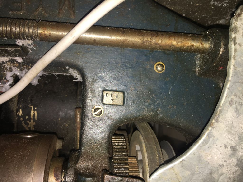

Mark, the serial number on the ML2 was stamped on a raised boss on the front of the bed approximately half way down below the headstock. Incidentally the Oilers were picked out in red paint, these weren't the type that we see nowadays just counter sunk holes in the castings.
Aha, that’s exactly where the number is that I’ve taken to be the serial number. It has a Z stamped on it, and underneath that either 311 or 811. Need to clean it up and look closely to be sure which.
mime has no red paint around the oilers. Could you post s photo by any chance? I’ll try to figure out how to post photos and put up the serial number boss.

Here’s the serial number boss. I don’t understand why it’s come out the wrong way up though. It shows the colour of the paintwork too...Serial Number Boss

Mark, sorry I can't post any photos as I sold the lathe probably 25 years ago and I never did take any close up shots, so everything I'm saying is purely from memory. Fortunately long term is good but don't ask me what I did yesterday! Your photo is exactly as I remember mine with the exception of the two brass round screws, that looks like a later addition/modification. What are they securing?

Hi Phil, not to worry, thanks for your input, it’s been a great help. I don’t know about those screws. The lathe does have a bent tin guard over the pillows and change gears, perhaps these were for a previous version. When I strip it down, if they’re not doing anything useful, I’ll likely remove them and fill the holes.
