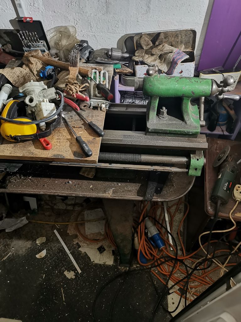

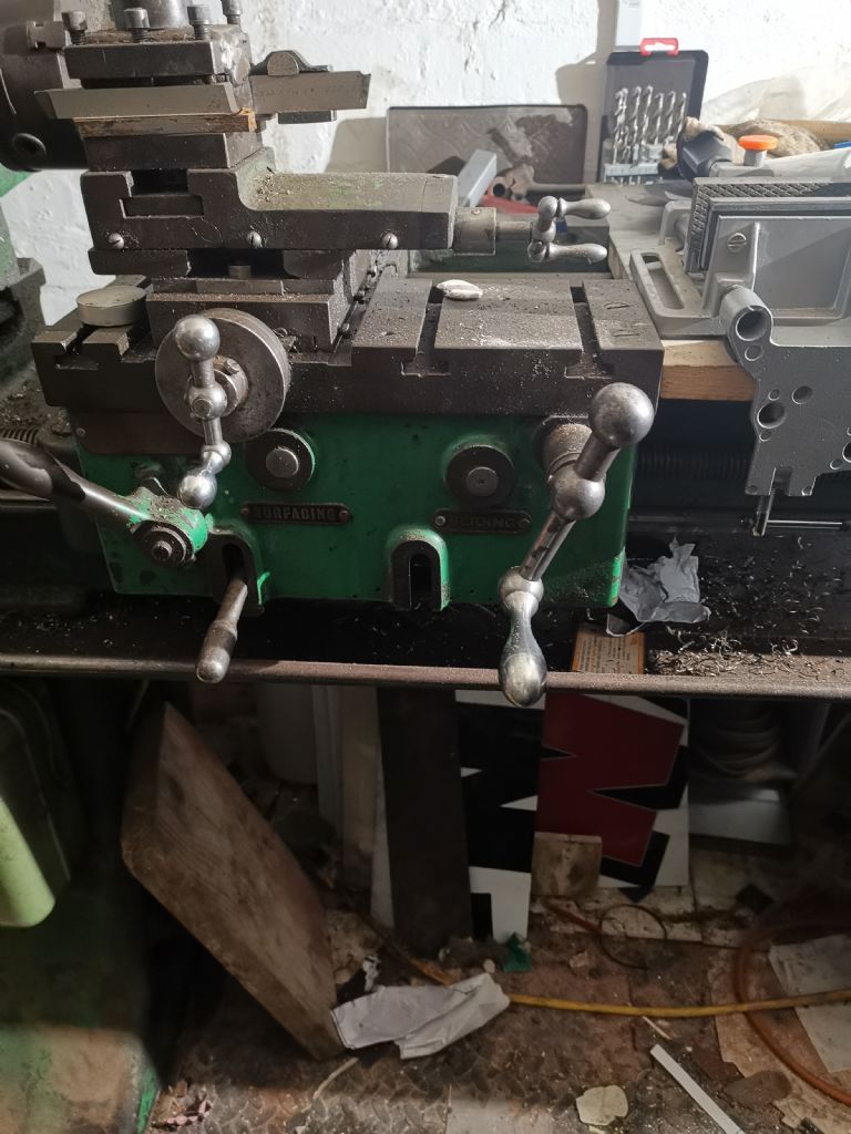

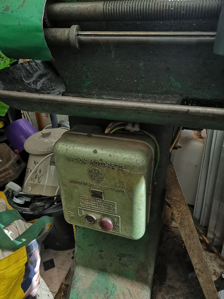

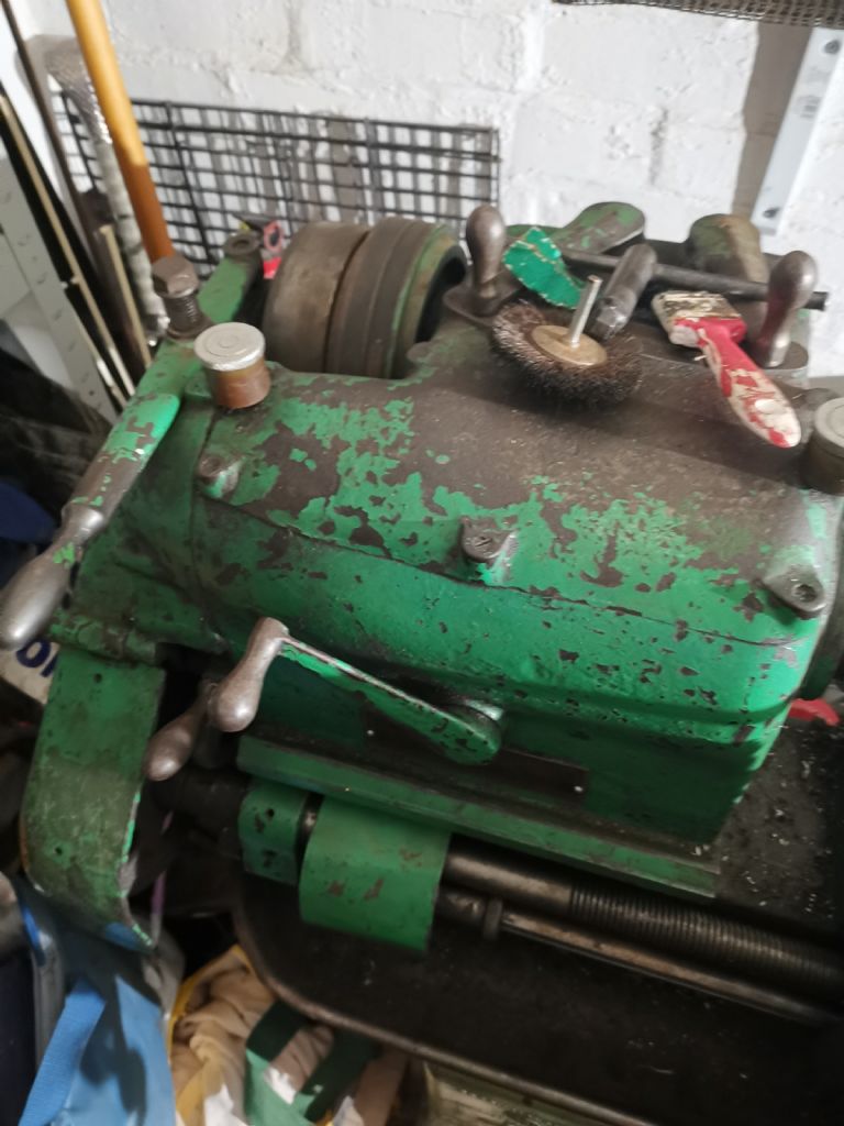

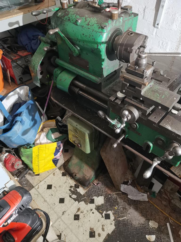

Bought this lathe a while ago but it came with very little information I don't know much about lathes but would love some help on the brand/type/modelimg_20190317_232126.jpgimg_20190317_232114.jpgimg_20190317_232057.jpgimg_20190317_232047.jpgimg_20190317_232015.jpg

Grizzly, It looks vaguely like an old Harrison that was used as an odd job lathe by all and sundry in the factory I worked in in the early 1960's went for scrap eventually. I'm surprised there is no name on it or at least a name plate.
Might help if you say your location - which side of the pond ? looks like UK ?
Whats on the plate on the headstock? Are there any numbers on the machine, where did it come from ?

Looks a bit neglected at the moment. But if it is not badly worn could be a useful machine.
The electrics control box is British. The leadscrew appears to have a fairly fine pitch
Looks to have power feed on both axes. Presumably change of feed rate or thread pitch is by changewheels rather than gearbox. If it is Eastern bloc, the Leadscrew and other threads will be Metric. If British or US, a machine of such vintage the threads and Leadscrew are more likely to be Imperial. Do the dial graduations give any clue?
Have you had a look at possibles on the lathes UK website?

I had one very similar and a good lathe indeed.
Pretty sure Its a very early ( 1940/50,s Colchester Master ).
You may find details on Lathes.co.uk or google early images.

They have this lathe pictured on lathes.co.uk as a Colchester Master circa 1930 - 1939.

Yes, I thought it was an early Colchester, the sliding/surfacing slots on the apron, and the headstock controls are the giveaway!¬
