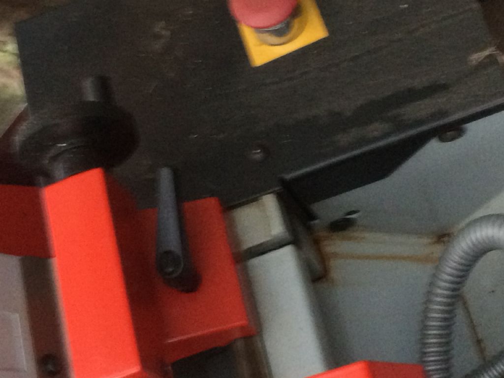

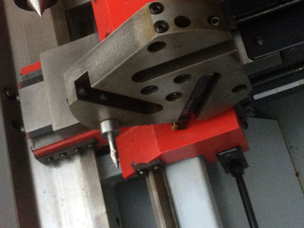

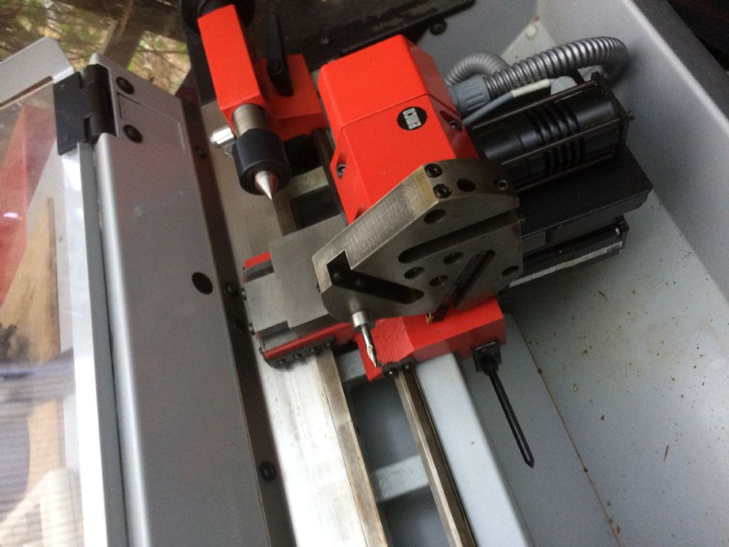

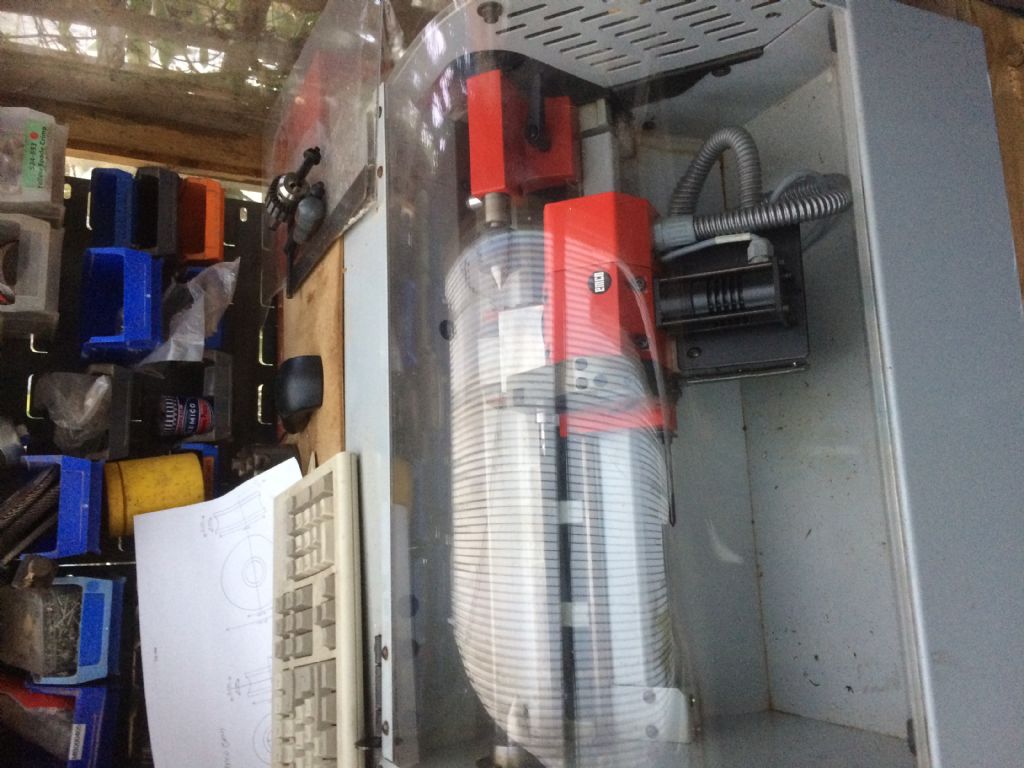

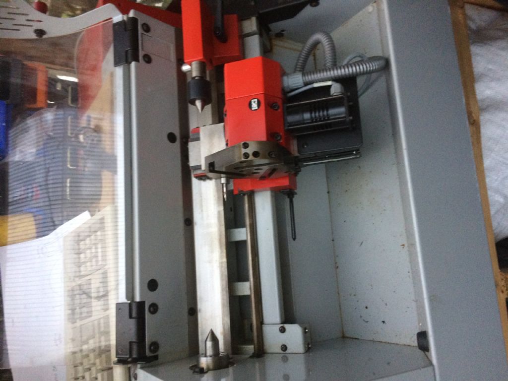

John some photos of the machine had it for about ayear never used it the cad cam is a nightmare get fed up and use my other machine the fellow i got form got it as an ex demo dont thick it has ever cut anything want to kep as much of the machine as possible as it all looks as new
Geoff
