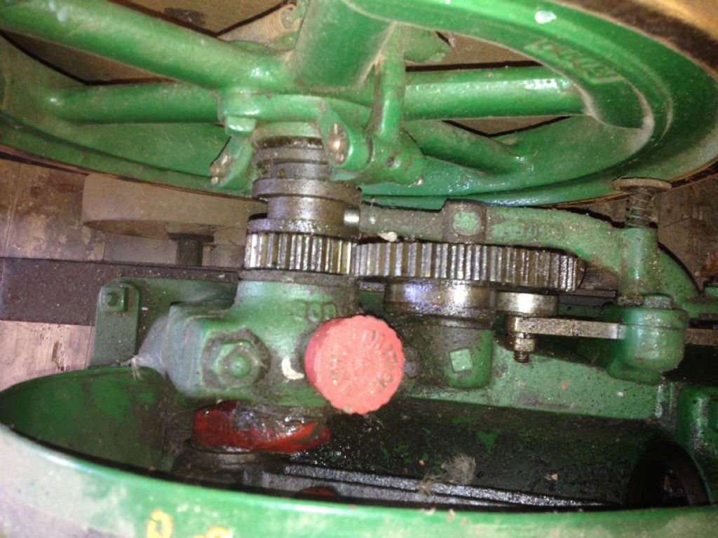

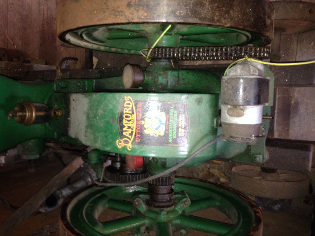

img_0172.jpgimg_0141.jpgHello, I have recently joined a Men in Sheds group at the Wind Energy Museum in N Norfolk and we are restoring old associated machinery amongst which is a Bamford hit & miss stationary engine which has not run for 8 or 9 years. I have checked it over and the compression is good but the name plate is missing so we can't identify the model, can anyone help? I have posted photo's in my album. I have looked at several pictures on the computer and there are very similar engines but the magneto is in a different place. Any help would be greatly appreciated.
not done it yet29/01/2019 15:59:46
7517 forum posts
20 photos
It certainly looks like an odd-ball.
It appears that most of their hit-and-miss engines used an EK trip magneto, while this one has an unnecessary and regular spark every revolution (the crank and magneto sprockets appear to be the same size).
Question might be why run the magneto at twice the necessary speed, although it may not have produced such a powerful spark at slow speed?
Furthermore, the magneto is driven by a duplex chain - unusual to fit such a heavy duty chain for such a light duty.
The magneto type may be able to be traced for age, etc - it looks like a quite late model for the hit and miss era.
Just some ideas for you to follow up. I’m not an expert on hit and miss engines at all.

Below is the answer from my friend. he refers to points being replaced with a spark plug, the points would be inside the head and when they were opened would produce a spark to ignite the fuel. dated 1920's, this link would show you how it would have originally looked, https://www.google.com/search?q=bamford+tulip+top+engine&tbm=isch&source=univ&sa=X&ved=2ahUKEwjJk-umu5PgAhUnRxUIHX02BVgQsAR6BAgEEAE&biw=1366&bih=664
Martin,
It is a Bamford Tulip Top 2.1/2HP and should be fitted with a Websters low tension system. The trip arm has been removed and the websters mag and low tension points system removed and replaced with a plate and spark plug. All home designed.
Regards
Andy

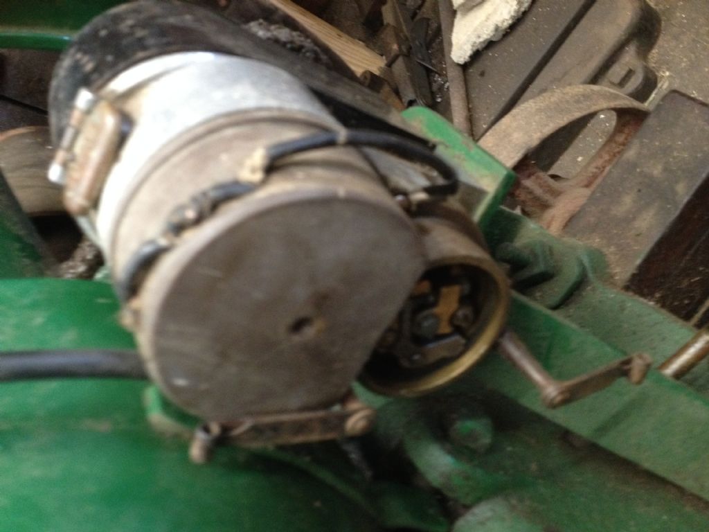

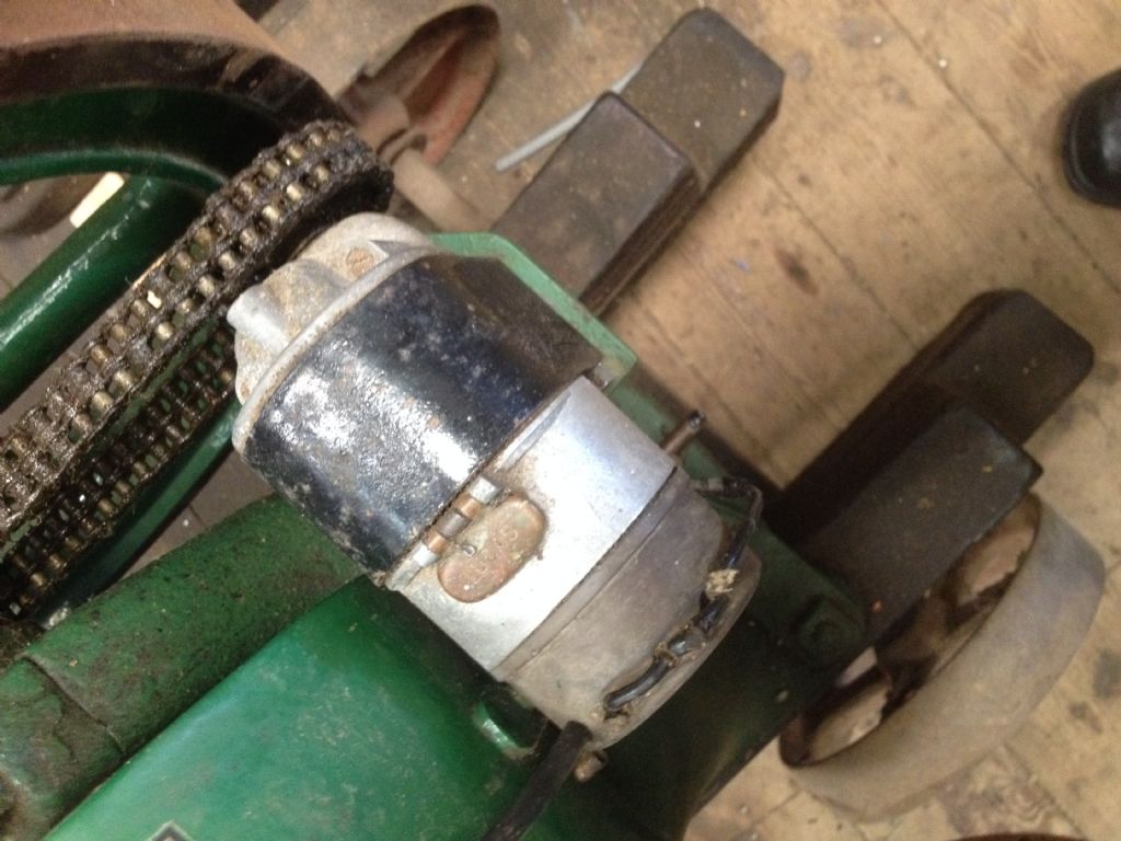

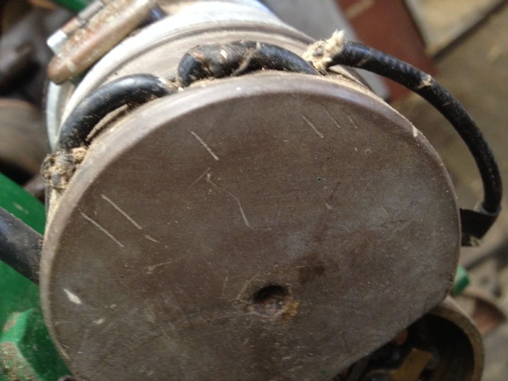

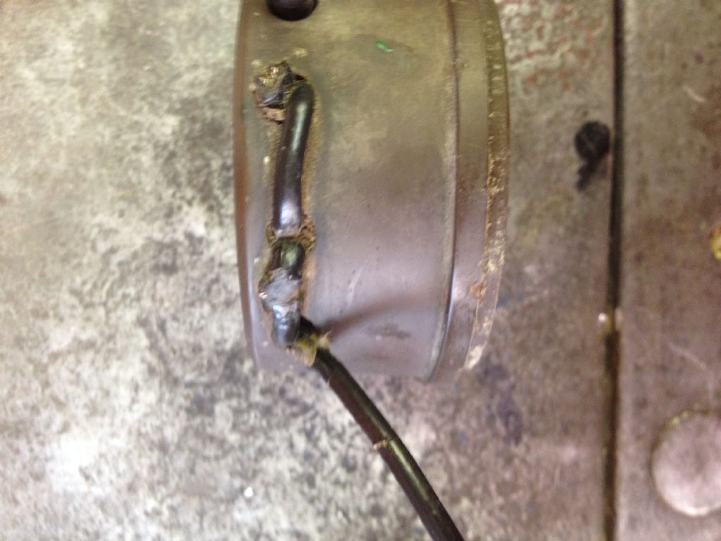

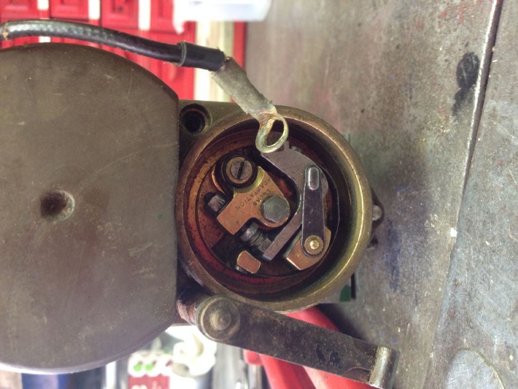

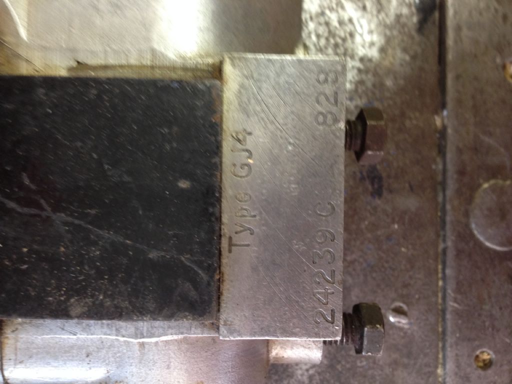

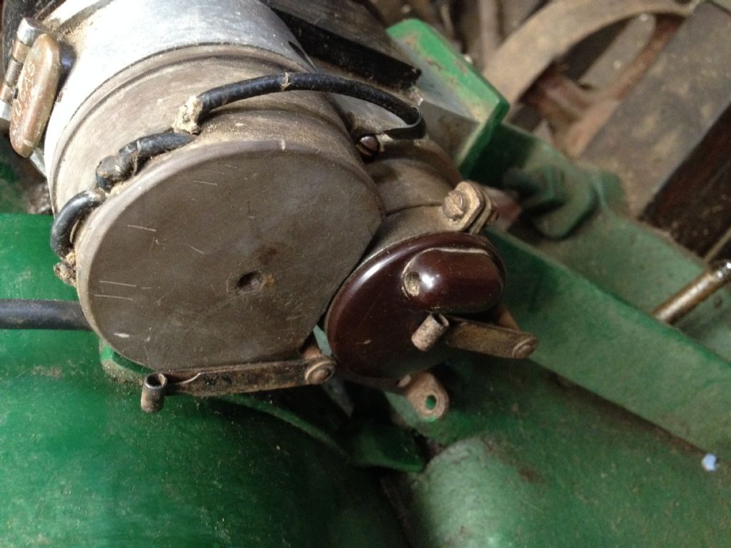

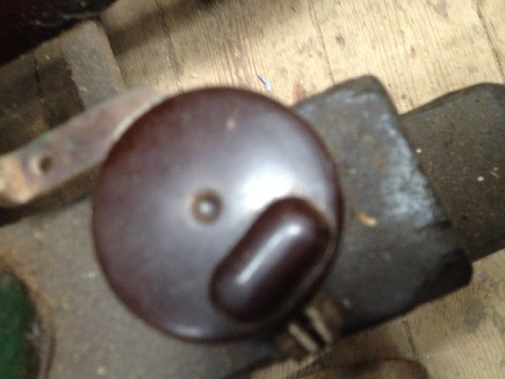

I have finally got back to looking at the Bamford engine with a view to getting running, I am told that it has run in this condition in spite of it being a mismatched collection of bits. The initial problem is that there is no spark, the HT lead seems to be wrong in that it comes from the body of the magneto rather than the bakelite cap, the points look OK. Before I remove the magneto I would like to have a diagram of the layout. The magneto is a Lucas and seems to be a GA or GJ type. If anyone has some information I would be very grateful. Regards Pat
martin perman24/06/2019 17:28:59
avatar
2095 forum posts
75 photos
Pat,
What you appear to have there is a 4 cylinder tractor magneto that has had all four ignition leads linked together and even though I collect engines I cant see how it works, can you take the bakelite cap off and show whats inside the cap and the magneto body, there should be a rotor arm, the duplex chain and sockets are incorrect as it would have been a single chain. If you PM me your email address I will put you in contact with my friend so you can talk direct.

Hi Martin, Thank you so much for your reply, that certainly explains the links which I realise now are for HT leads. I was waiting for a diagram before taking it to bits but I will press ahead later in the week with it when I next go to the museum, it can't be that complicated and I did play with 50's motor cycles. I will post the photo's. PM also sent if I can work out how to do it, again many thanks, Pat

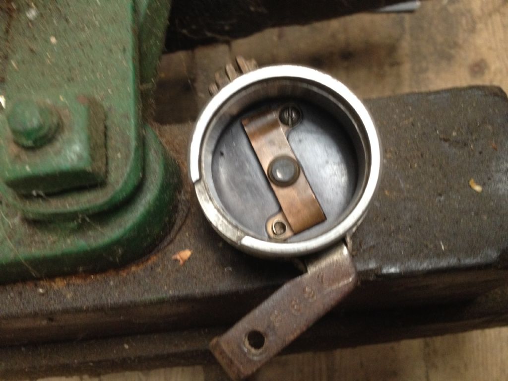

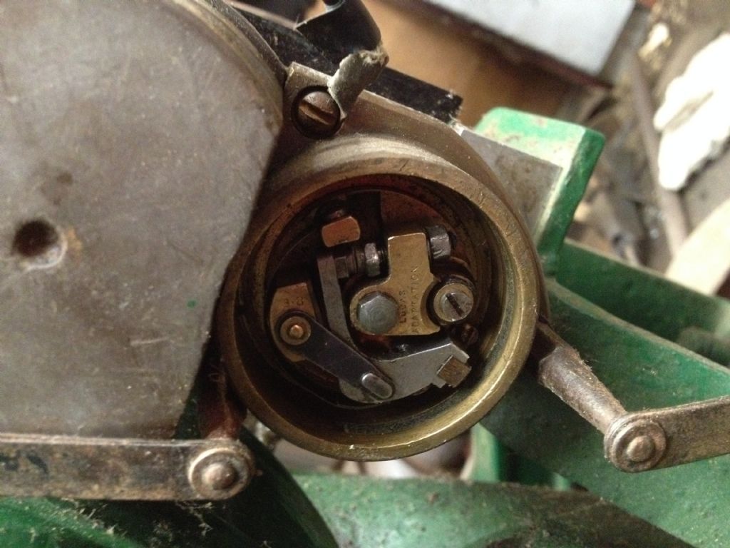

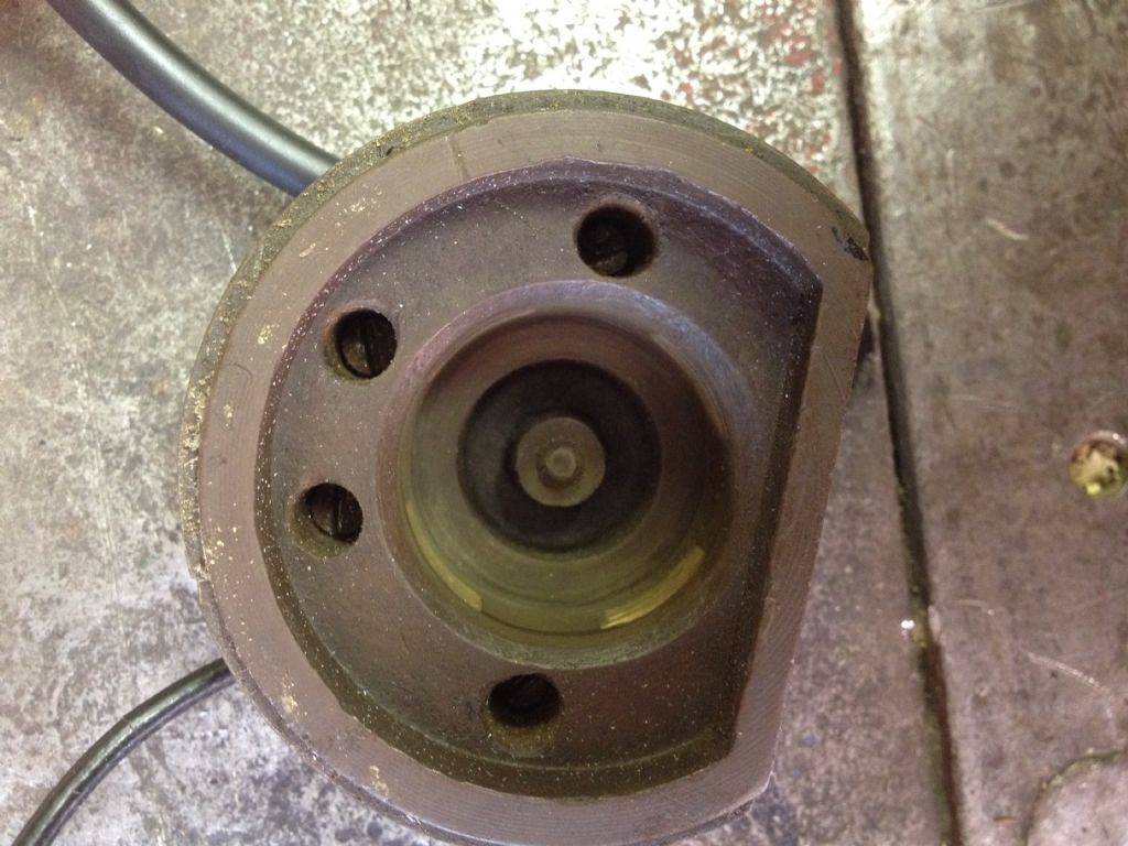

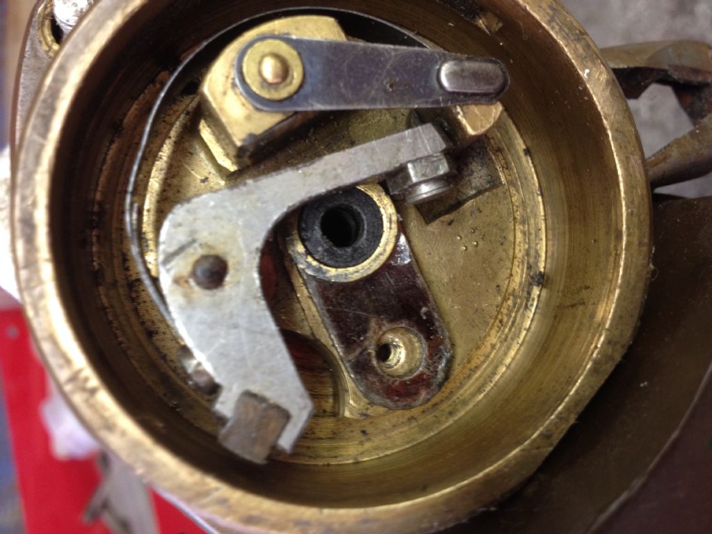

img_0279.jpgimg_0278.jpgimg_0274.jpgimg_0272.jpgI have removed the magneto and stripped the points and bakelite cap. The terminal screws were seized and corroded and I replaced the HT links as there was no continuity probably because of the corrosion and reassembled it. I fitted a new sparkplug which I secured against the magneto body and spun it with a cordless drill, hey presto a beautiful spark, sadly it soon faded and now there is the faintest of sparks. I will strip it again tomorrow just in case I have missed something. The magneto is a Lucas GJ4 which was fitted to tractors as Martin suggested. The easy answer is to get the correct magneto but the museum relies on volunteers and donations so the cash is just not there to fully restore the engine, our aim is just to get it running as an exhibit. I have attached photo's. img_0269.jpg Regards Pat
martin perman25/06/2019 18:55:19
avatar
2095 forum posts
75 photos
Pat,
The correct magneto would be a Websters low tension type, sadly you dont appear to have the mechanism to operate it, which is why it was modified to use a high tension magneto.
if you have not done so remove the points and give them a good clean particularly the contacts as they oxide up, how good is the surpressor/condensor this will kill the spark if dead and remove the coil and put a meter across the two main connections if it reads a dead short it needs rewinding but as you have a spark its unlikely. You may also have a weak magnet, it can be all sorted but I dont know a local mag repairer in your area, my local man is in Wellingborough.
Martin P
Pat Bravery25/06/2019 19:54:36
avatar
96 forum posts
24 photos
Hi Martin, Thanks for your reply, I did a continuity test across the points and there is still a circuit when the points are parted so there appears to be an insulation fault there. I have not looked beyond the distributor cap and points yet but there does not seem to be a condenser fitted anywhere near the points. I think that the reality of it is that it will wind up as a static display but I would like to get it running. Regards Pat
Pat Bravery25/06/2019 20:16:08
avatar
96 forum posts
24 photos
I have just had another look and it seems that the long centre shouldered bolt that holds the points to the shaft is lacking an insulator. I will see if I can locate one or even make one. Regards Patimg_0280.jpg
Swarf Maker25/06/2019 20:30:41
132 forum posts
7 photos
That screw is not meant to be insulated. It forms one of the connections to the inner workings of the armature.
Pat Bravery25/06/2019 20:35:44
avatar
96 forum posts
24 photos
Thank you for that information, there must be a short elsewhere in the points. I am recalling my Morris minor days when the two sides of the points were insulated from each other when the points opened to cause the coil to energise, I am assuming that it is the same with a magneto. Regards Pat

Swarf Maker25/06/2019 21:49:45
132 forum posts
7 photos
The resistance that you measure when the points are open is that of the primary coil on the armature. That is as it should be. If there were an open circuit that would be a fault condition!
The fact that there is resistance present is not a positive test however. Shorted turns on the primary coil of the armature will not show up. Also the capacitor is connected across the points and thus across the coil as well. These capacitors are paper/foil/mica constructions and sometimes (but rarely) fail showing a low resistance. More likely is that dampness and corrosion degrades the connections between foil layers and their capacitance value falls dramatically. This failure mode often occurs when a damp/degraded capacitor is exercised after a long period out of service and is the most likely cause of your symptoms. You started with a strong spark, the energy of which the capacitor couldn't cope, and then the capacitor failed, spoiling the tuned circuit and hence reducing the spark.
All repairable/replaceable but not for zero outlay.
