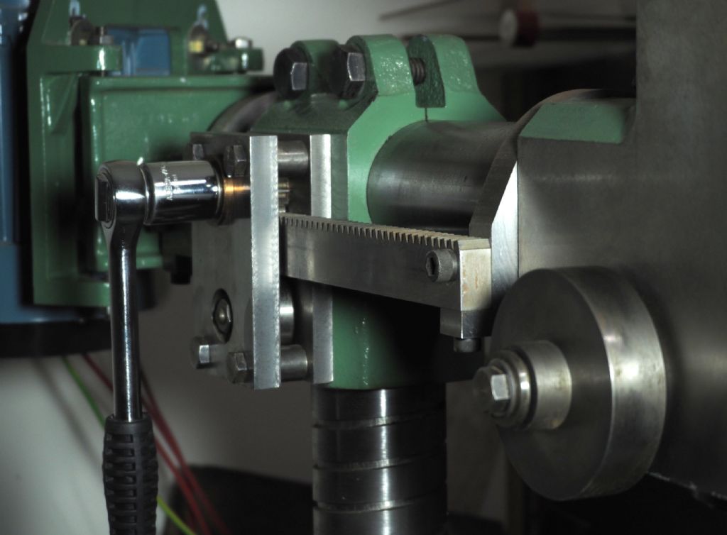

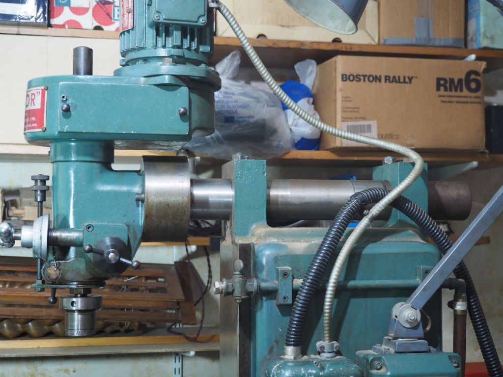

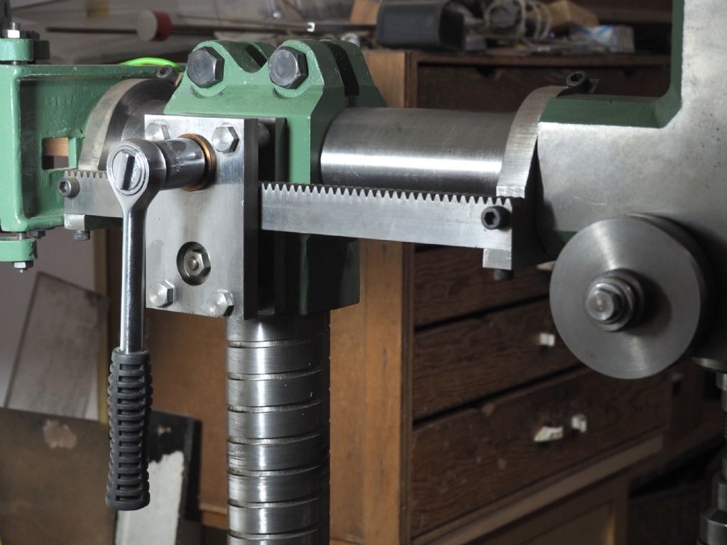

I bought a Tom Senior light vertical mill last week. It hasn't arrived yet but already I'm thinking about how I could modify it I'd like to make it easier to move the head in and out and also to retain the registration when doing so . This is the mechanism that I designed for my Dore Westbury mill to achieve the same function. The pressure angle on the rack maintains the contact with the registration bearing. Working from the inverse of this design seems a good starting point. Any thoughts?

Sorry no thoughts Miles, but I do like that mod on the Dore Westbury. Very nicely done! yes

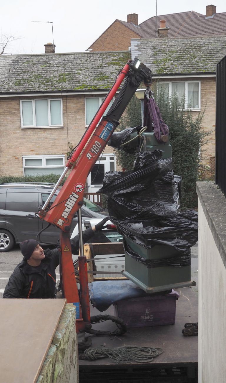

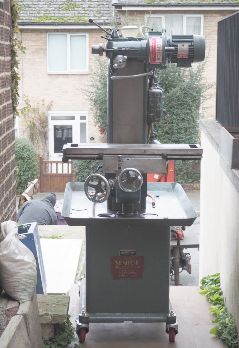

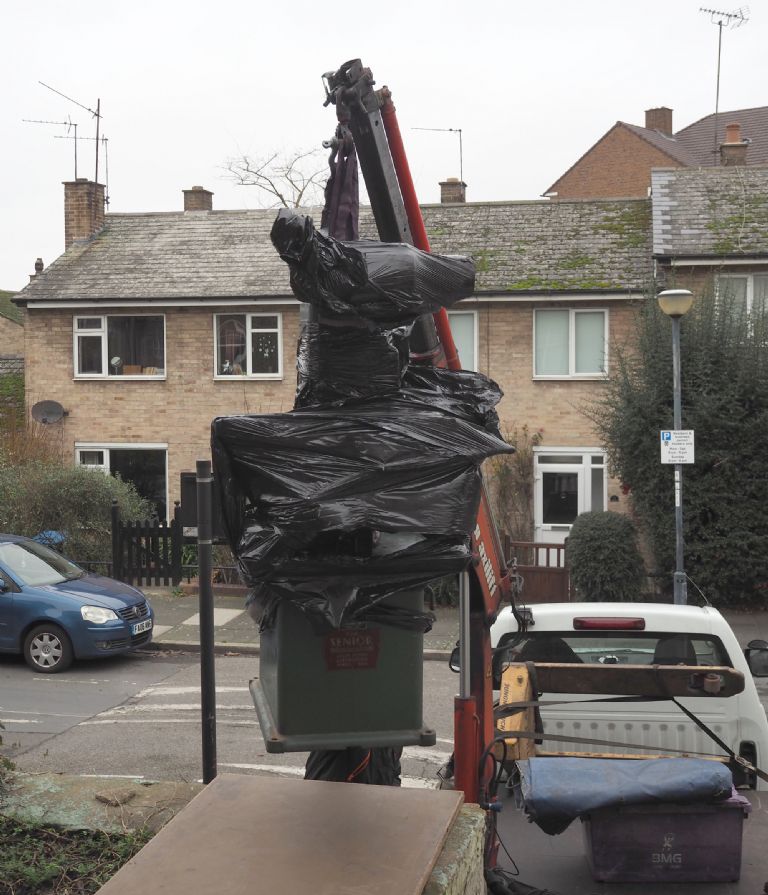

My new toy has arrived

Dave Halford29/12/2018 17:11:13
2536 forum posts
24 photos
Shame the top half will be in the bedroom :O)
Miles Hellon29/12/2018 17:46:17
62 forum posts
26 photos
No problem. I've already dug a pit for the base

Vic29/12/2018 18:07:35
3453 forum posts
23 photos
Nice looking machine Miles, I’m sure you’ll have fun with that. wink

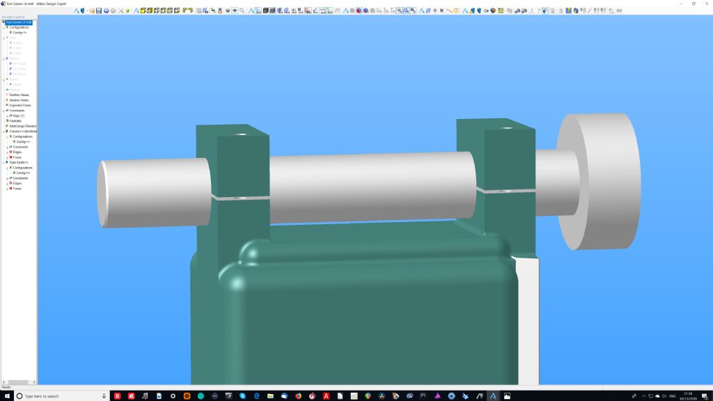

Made a start, this evening, by modelling the column and ram shaft.

It will be an interesting project, looking forward to see how you get on. I wonder how the original manufacturers envisioned users would move the head in and out?
Miles Hellon31/12/2018 10:47:41
62 forum posts
26 photos
Posted by Vic on 30/12/2018 22:26:24:
Rock it clockwise/anticlockwise while pulling or pushing, I guess. That works ok, the problem is more in the loss of angular registration. Even the use of the angular scale is lost as you pull the ram away from its 'home' position, as the pointer for it is on the head cover (or on the proximal clamping block for earlier machines without the cover).
