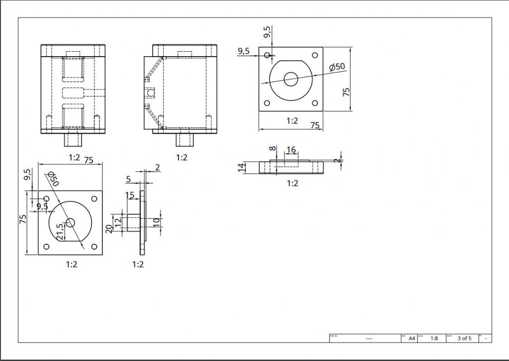

Here are the drawings as they stand at the moment. They aren't engineering quality and a lot of things like fastenings aren't included, but I think the overall structure is there. Comments and critiques welcome.
The Overall Engine
Cylinder Details
Crank and Piston
Valve Gear
Frame

JasonB21/11/2018 08:02:03
avatar
25215 forum posts
3105 photos
1 articles
As few thoughts after having a quick look.
Cylinder - I would make the ports a bit deeper to reduce the angle of the passages and try to get the passage area equal to the port if you want it to do work. Exhaust could do with being larger as by the time you have screwed some pipe into there you won't have that large a bore so will be restriction flow, maybe a flange screwed to the outside if you can't fit a larger threaded hole in.
If it is going to work then mill away a lot of that cast iron to reduce the mass if you don't want a bucket full of condensate and lag the void, drain cocks would be needed too. It will need a large boiler too.
Crank/piston - You don't have anything to guide the cross head so will get a lot of sideways forces that will soon wear glands and the cylinder bore. Either add a trunk guide, single guide to one side or guides both sides. Cross head joint looks quite spindly for the size of engine, there is not a lot of metal around the 8mm pin.
Valve - Thread the rod and have an adjustable nut, that T piece at the end will not allow for setting up the valve for equal movement. Like the cross head you have nothing to guide the valve, either extend it into a hole/bush in the top of the valve chest or have a bracket from underneath to guide it. No sign of a stuffing gland to seal the rod. Joint between rods looks weak.
Frame - I would fix the lower bearing halves from below with counterbored cap heads, that way when you take the caps off they will stay in the same position so all your lapping won't be wasted. This will also allow the tightness of the two halves to be adjusted without the whole lot moving about Or have steel blocks with turned bronze bearing shells

Can I just check what you mean by some of these items - as I may have said 'me ignorant - not know engineering'!
Cylinder
when you say make the ports deeper, do you mean that the bit that comes down from the valve surface should be deeper (blue), or that the angled port should be steeper (black), by which I mean the gap from cylinder to surface should be larger.
My guess is you mean black?
I've found that Metals4U have 100mm cast iron rounds for £15 per 100 mmm which is somewhat cheaper than I can get a 85x75 bar (which was my intent), so I'm thinking of getting a round and changing the design to suit.
That would mean cutting a LOT of iron out but doable.
I guess what you're saying is the iron needs to stay hot rather than absorbing the heat which is why we make it thinner. I can do that, though doing so starting from a bigger round will take a log longer with my X1 mill.
I saw that the 5A (One of my sources) has drain taps, so I guess I need to add that to the design.
I take your comments on the guide. I was wondering about that. What sort of force are we looking at? I've got quite a lot of linear slides like these, but they're quite light.
Get your point on mounting bearings.
I was wondering about using shims under a plate that attaches to the eccentric bearing for valve adjustments.
And I've read that the pressure on the outside of the D holds it against the slide so no additional guide required.
I will worry about the boiler once I have this made! I will test it will air to start with, but I've been offered test boilers to take it further.
One thing at a time - this is more than ambitious for now!

Make the blue port deeper, infact as you have plenty of cylinder cover overlap you could make the top notches go a bit further towards the edge and then just come straight down with the passages.
It is more to do with the steam hitting a cold cylinder when you start running, the cold metal will make the steam condense robbing it of energy and filling your cylinder with water. by removing metal to leave a thinner wall and flanges at the end there is less metal to heat up and the space can be lagged to further reduce heat loss.
I don't think those guides will be upto it but you can make your own by milling a slot in some steel and screwing overlapping plates each side to make a kind of Tee Slot
Shim would do it but a bit of a faff to keep undoing screws and adding more or less shim until you get it right. With a threaded rod you just pull the pin and turn the rod then pop the pin back in place.
Yes the steam/air pressure will hold the valve to the port face but the sideways action of the eccentric will soon wear the gland.
Don't underestimate th e amount of steam or even air an engine this size will need, I should think at least a 6" vertical boiler if not 8" will be needed to play with it. and a 12-15cfm compressor if you don't want it running non stop

If you don't have a rotary table then bore the cylinder and maybe add a round flange on the top end. Round or square stock will do
Mill 3 faces to leave say a 5mm wall thickness
Then mill the "curve" as a series of facets
File to blend if the fancy takes you and there you have a cylinder. You will also end up with a 60mm wide portface so can make your valve chest that width which will help to reduce waste volume inside it.

For the eccentric, if I put a thread on, surely the minimum adjustment is going to be half a turn - say .03 - 0.4 mm. Isn't that a bit clumsy when the ports are only 4 or 5 mm wide?
On the ports, I'd originally had a stepped design with the port quite deep and then an entry at right angles for the steam to come out at the end of the cylinder and then a small distance down the face to the cylinder (if you see what I mean). I was advised to switch to an angled passage which is what you see in the current drawing.
Have I got your intent right? More of a dogleg? I have to say that the machining is easier for that layout!

Use a metric fine pitch or 40tpi and you will get 0.25 increments which seem to have been OK for model engineers for decades, you get more variation that that when say a traction engines boiler expands and alters the distance between cylinder and crankshaft. If you want finer adjustment then don't use a central bar shaped nut , instead have a nut and locknut either side of the valve then you can get infinite adjustment.
I think angled passages are more of a model engineering thing for when the passages are not cast in as you can't easily drill round corners. There is the argument that the angled route gives a slightly smoother route but if the passages are large enough it won't make much difference. have a look at this 1/2scale Burrell cylinder from Little Samson Models which has the same shape passages as the full size and they are not angled. The Dogleg just makes for easier drilling, you are very close to the port face on your drawings and it would not take much for the drill to break through so even just steepening the angle will help.

Geoff, I like the idea of switching to a plate and it's something I'd considered, Having to add a guide makes this more appealing.
As I understand it, you have a cylinder whose bottom hole is s slidefit for the piston ron and the top has a registration plate which fits into the underside of the plate.
How does the gland get fitted? Is that what the holes either side of the top of the support are for.
Jason the sketch below is (roughly) what I had in mind originally. And a lot easier to build than angled ports!
A question: I've been trying to minimise the amount of space in the passages and 'closed' cylinder. I'm not sure I know why, but I suspect an early dabbling with car engines has something to do with this. Also, there is less 'unused' steam to exhaust with smaller / shorter ports than with wider longer ones and more space in the cylinder at the end of the cycle.
I read in one of my books that 4% ish was right for a medium speed engine, and whilst I've not tried to measure that, I have tried to keep that space down.
The question is, 'Am I wrong about this?' - fully expecting the answer, 'yes you are!'.

looking at the latest cylinder drawing the biggest issue I can see is that the valve face is going to be too narrow by the time you have the sides of the valve and the thickness of the valve chest walls you will be hanging over the edge.
Having said that your ports do seem rather large for this sort of size engine. You could safely come down from 25mm wide to 20mm width then have the exhaust 8mm across, 4mm between ports and 4mm inlets. This is a similar sort of size to the Stuart No1 of which many have done real work.
This would give you a valve cavity of 20mm wide x 16mm high, make the overall size of the valve 28 x 28.
If we then said 1mm clearance each side of the valve and 10mm wall thickness for the valve chest then that would give a 30mm cavity in the chest and 50mm overall width.
You could also happily reduce the cylinder wall thickness down to 5mm from 7 mm giving a 30mm radius.
Finally take the flanges to 5 or 6mm thick to give the studs a bit more meat to bit into as you only have four of them
Finally bring the passages in a little closer to the cylinder bore so you get a decent width seal to teh outside edge, reducing from the 5mm to 4mm will also help with that.

What are you drawing it with? On my Alibre one I selected the inner face of the flange, drew a 10mm rectangle and then extruded that 8mm, then put a 5mm radius on the corners, drilled hole and cut extrude to do the counterbore out from the face of my block.
As for machining something like this. Assuming you will have wood or sheet metal cleading it does not have to look perfect.
