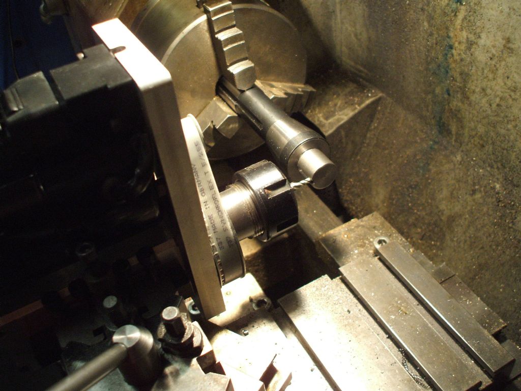

Like Ketterinboy, I used a similar method to locate the R8 arbor to the top of the boring/facing head that I made, as I don't possess a broaching kit. Slightly differently, though, I used a piece of silver steel rod instead of a "normal" square key to provide a positive drive, cutting a semi-circular groove in the arbor with a ball-end milling cutter and a matching one in the boring head body. The short length of silver steel fits snugly in both parts and the grooves can be seen ( just ) in the pictures below.
Shaft installed
Arbor keyway cutting
Edited By John Hinkley on 01/11/2018 12:06:25
