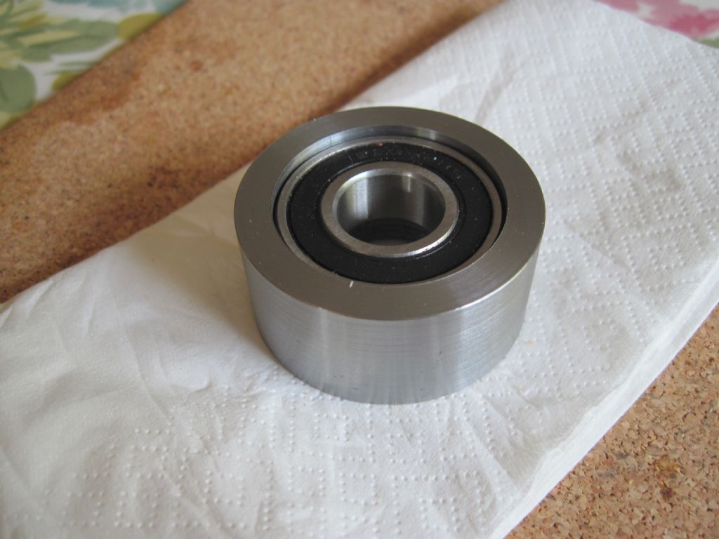

Hi Andy,
I'm afraid I could not really see your bearings that clearly but I've had a similar problem with very badly worn motor bearings and the associated motor spindle. I believe my original bearings are called 'shell' bearings (very thin, hard split bearings sat within a felt liner that acts as an oil reservoir). I couldn't remove them, so finally I just bored them completely out. Fortunately the die-cast end bell had enough meat to enable a mild steel 'spacer' to be fitted. The spindle was very badly scored - so this part was turned down between centres to the same diameter as the keyed part of the shaft. I then purchased a sealed bearing, made the liner fit its OD - with the ID sized to hold the spindle. Started assembling the whole thing this pm - and have just loctited the new bearing assembly into the end-bell. The other end bell bearing seems OK but it will get the same treatment if it's not.
The photos below should give you the general idea.
As it happens Abom79 has just done a very similar thing for his K&T motor - although he used a cast iron liner that is apparently commonly available for this purpose (but he's in the US). My motor needed a custom solution but either way, hopefully (as Mark has already suggested) this approach will help solve your problem.
See this YouTube for the Abom79 details: https://www.youtube.com/watch?v=u86tX-w3Z58

Clive Foster30/09/2018 21:52:09
3630 forum posts
128 photos
Many years ago I changed the bearings on what, from memory, was motor of similar construction. As I recall it careful inspection showed a way to prise off the steel caps without wrecking things. Most likely it took two or three inspections before the penny dropped. A home made expanding puller device got the bearings out. Turned out to be a standard oilite size in my case. Which I actually had in stock from a "mystery bargain box of useful stuff" purchase.
Don't know what the expanding puller device was but these days I'd probably use a large expanding concrete anchor stud (Rawlstud) with a multi-slotted (think ER collet style) alloy tube to fill the gap and improve grip. Stack of O-rings on a stud with taper edged washers in between also makes a good expanding gripper but needs more work to make and covers a much smaller size range. Better grip tho'. Tube and nut on the spare screw or hammer and drift on the end both work fine.
Drop the housing in a bucket of boiling water for a few minutes to expand things before trying to extract the bearings. Makes big difference as the fit is generally not very tight. Presumably to avoid risk of pinching bearings down below nominal size. Have had similar arrangements, not motor bearings, simply pull out by hand after getting up to temperature. So don't go too enthusiastic on the expander to start with.

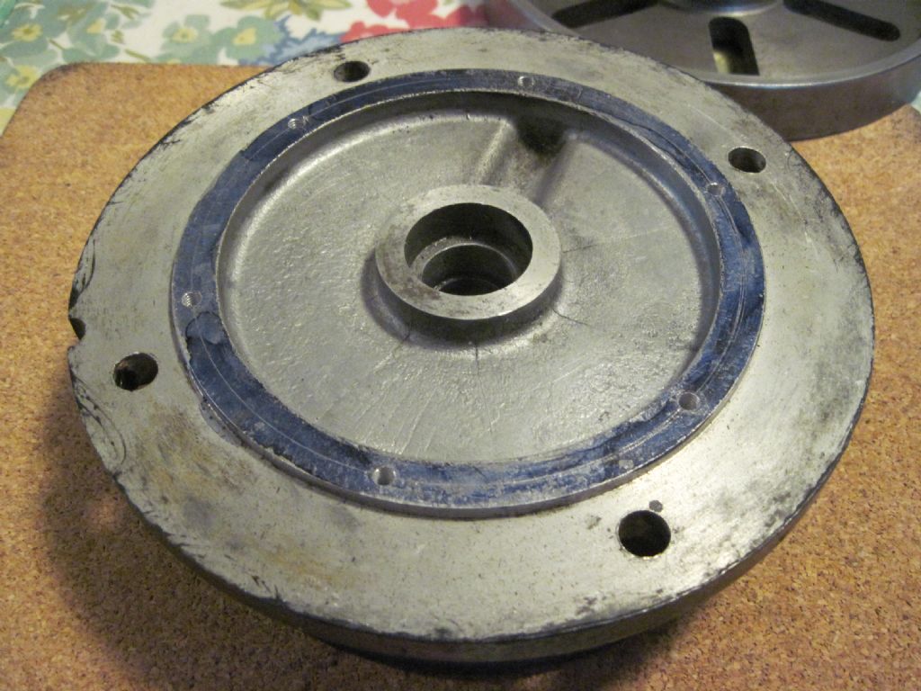

IanT30/09/2018 23:38:40
2147 forum posts
222 photos
No - I don't think a Unimat will do it either Andy!
I had to mount the end-bell on my Myford faceplate, as none of my chucks would take it. It involved a bit of preparatory drilling and tapping work to match the two together - but it was the only way I could think to do it..
So if you have a mate with a bigger lathe - here are some photos of my face-plate set-up.

Andy Carlson30/09/2018 23:41:57
440 forum posts
132 photos
I've just been having another look at the motor following tonight's discussion.
I put it back together to take another look at the bearing wear. Having done this I found that I could not get the rotor to touch the stator in any position so things are probably not quite as bad as I had initially thought.
As originally noted, there *IS* bearing wear. There is play in the shaft in the direction of the belt load but not in the direction perpendiclar to this. The motor definitely does make some nasty noises. I now suspect that the noise is caused by vibration of the shaft in the sloppy bearing rather than by the rotor contacting the stator. This noise would, of course, stop when there is enough tension in the belt.

IanT01/10/2018 09:00:46
2147 forum posts
222 photos
Hard to tell Andy but I don't think you have an Oilite bearing in there. it looks like a felt oil reservoir very similar to the one on mine. If you can remove the tufnol cover - you may find an inner die-cast ring that holds a thin bearing (I called mine a 'shell' bearing - but it was very similar to a Glacier). Whereas I've pulled Oilite bearings out quite easily in other situations - I couldn't shift this one (although I didn't try heating it). So I just cut-out the whole thing.
However, even if I could have changed just the bearing itself - the shaft was badly scored - so a new bearing would not have lasted too long. My spindle had a stepped shaft - so I was able to turn the damaged part away - but your shaft seems to be a single diameter, which means you would have to reduce the whole length - possibly weakening it (and then your pulley wouldn't fit either).
However, if your shaft doesn't seem badly worn or damaged - then maybe the bearing isn't too bad either. If you think the bell ends may have been swopped in the past - then the rear cover should come off fairly easily (wooden dowel tapped from the inside). Then you could try both bell ends on the pulley side of the shaft and see how well they fit - can you 'rock' them slightly? If you 'mic' along the shaft is there discernible wear on it - checking along the length from the pulley end?
Your original concern was that the rotor was hitting the coils but if this is not the case - then it might be best to leave well alone or decide to bite the bullet and find a new small fractional motor. I don't know how the Cowells motor is mounted - but a new mounting for a replacement motor might be an easier task for you - and these small (cap start?) motors are not too expensive if you can mount them. In my case I needed an Imperial B56 flange type mounting and whilst replacement B56 motors are still available - they are about twice the price of the same sized metric one (which wouldn't fit the machine easily). So I decided a repair was required - but in your case there might be other easier/affordable options...

Andy Carlson01/10/2018 18:47:51
440 forum posts
132 photos
I had initially thought that the previous owner must have rotated the ends through 180 degrees but this theory was an attempt to explain why the noises stop when the belt is tight. Now I think that the noise is down to vibration of the shaft in the bearing. This theory explains why the noise goes away with no need to assume any other changes... and it also means that rotating the ends wont help with the noise.
I'm not shying away but having taken the thing apart and discussed it here I do now think that the problem is less severe than I had first thought. 'Leave well alone' is definitely still an option in the short term but I plan to keep this lathe and don't really want to put up with the noises indefinitely. Replacing the whole motor is an option but not my first preference.
At the moment cautious, reversible steps towards replacing the plain bearings 'like for like' (or very close to) is my preferred option.
Some progress to report... I found that the outer end cap on the non-pulley end came off with some very light taps with an 8mm rod through the bearing. Taking out a wick 'washer' revealed the view in the photo below.
So this does seem to be a thin walled bush. As far as I could measure by poking around with the calipers it seems to be roughly 10.8mm OD (and an 8mm shaft). The bush is inside a bore in the main casting but this part of the casting is surrounded by several slots for more wick material.
I've also had an unsuccessful attempt to get the inner cap off using a few quick and dirty options. My anchor bolt does not expand enough to grip the cap so I'm planning to make something with a step to engage positively inside the rim. Not sure if that will happen today because I have some errands to run.
