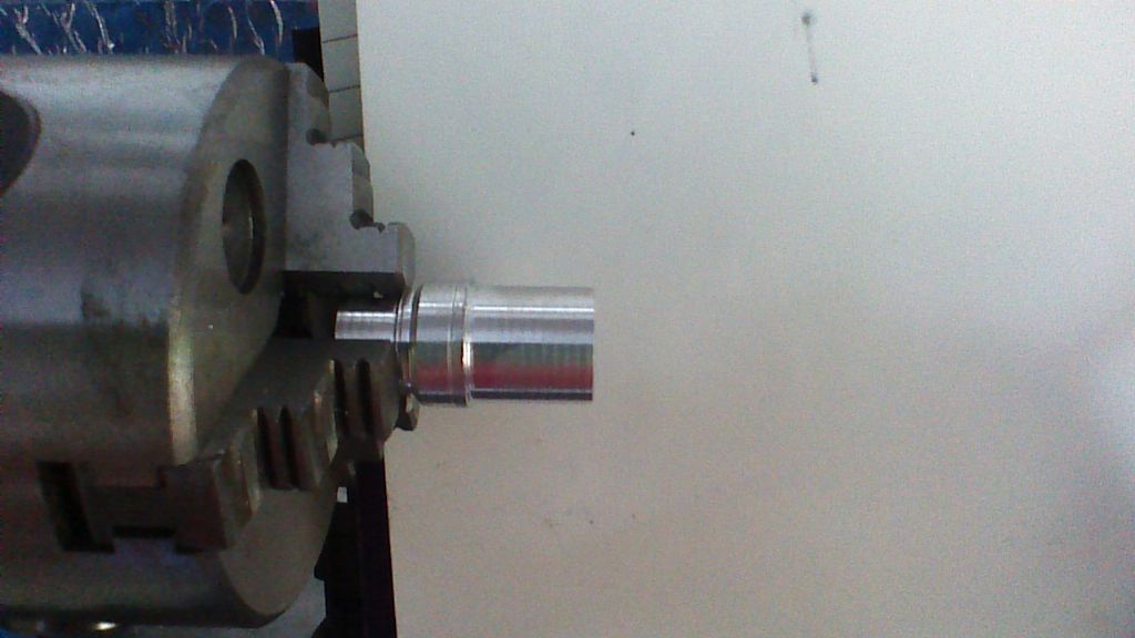

I recently bought a used mini lathe on ebay, but when trying to turn a piece of aluminium under powerfeed, I found that the carriage was slipping. At first I thought the leadscrew was bent, but I don't think so. Today I engaged the half nuts and held my hand on the lever to feel for reaction, but I discovered that the pinion gear was actually slipping on the rack (hope I'm using the correct terms). I cannot figure out what can cause this. Below is a photo of the piece of aluminium I tried to turn.

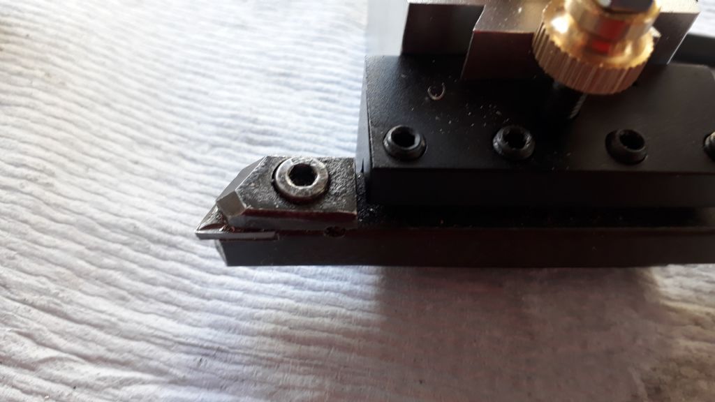

Finally, your lathe tool looks odd, can you take a photo that shows clearly how it is arranged, I suspect it might be one reason for poor finish? If it's struggling to cut for any reason it can force the halfnuts or gear banjo out of engagement.

It looks like a right hand insert tool mounted upside down. It looks really odd like that.

It does, indeed, look as if the tool is upside down.
Apologies and respect, in advance, Charlene, if that's not the case. But, worth
pointing out.

Thank you for all the replies. I cannot really adjust the rack and I've checked the forward/reverse lever, but that was not it. I can assure you guys the tool is not upside down. Probably the angle the photo was taken at. I'm adding another photo at a better angle. Even without the tool, it is doing exactly the same. It's also not the gears slipping. As far as I'm concerned it must be something between the half nuts and the leadscrew, because the carriage is pushed from the leadscrew via the halfnut, as mentioned. I spent more than half an hour cleaning the leadscrew and the half nuts yesterday as well. I think that the half nuts becomes "stuck" to the leadscrew at those positions and that causes the pinion to slip on the rack. Half nut lever detent is also good.

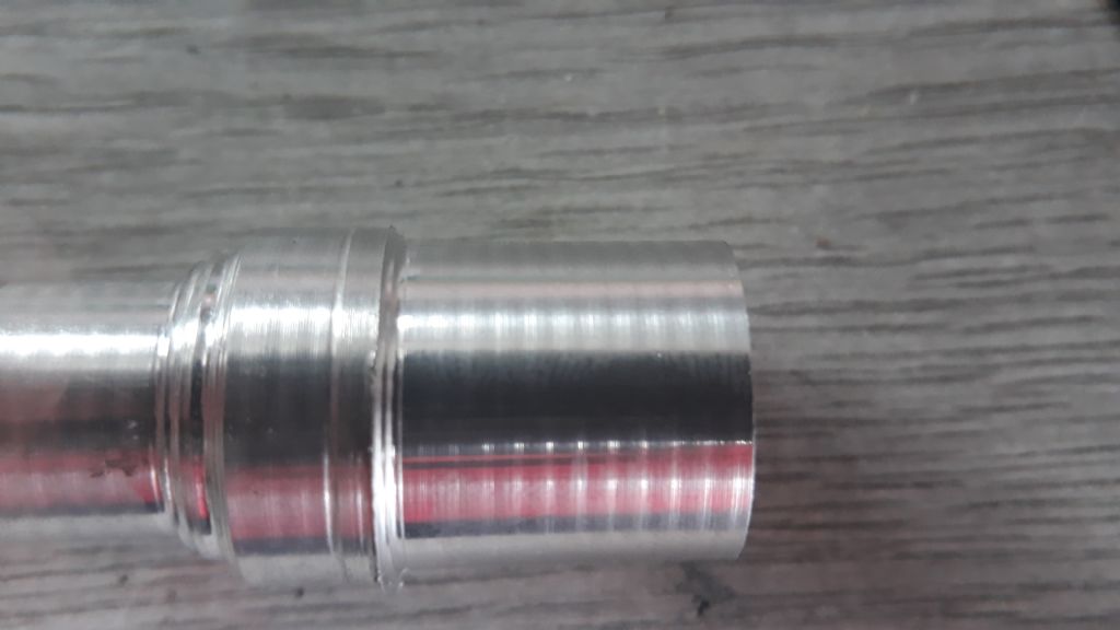

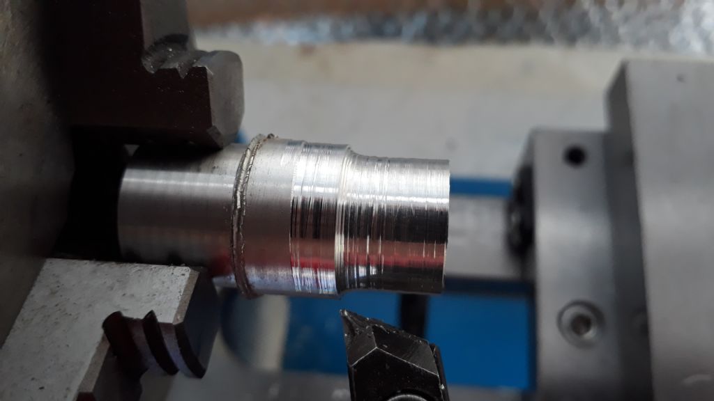

Hopefully the finish I'm getting is clear enough in the photo. My original thinking was that the leadscrew is also bent and I still think so. It also looks like it a bit when it is turning.

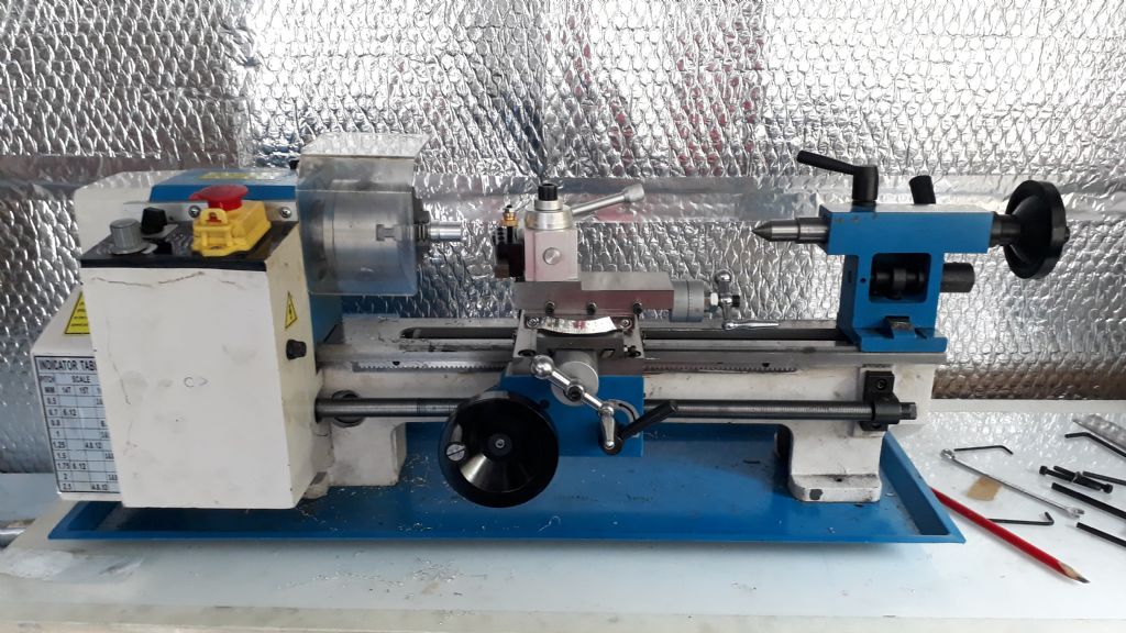

O by the way, I am trying to find out what lathe it is because there was nothing on the front cover when I got it.

Daniel09/09/2018 16:43:12
avatar
338 forum posts
48 photos
Hello Charlene,
Post a picture of the whole lathe on here. Someone will surely identify it.

Hi Charlene, well done some progress. If you can post a picture of the lathe I,m sure we can work out the make and hopefully the model.

The finish in that last shot looks OK reasonable. What depth of cut and speed are you using?
It's worth loosening the two cap screws that hold the apron to the front of the saddle. Close the half nuts and the apron will 'align' with the leadscew. Close up the screws gradually, checking that the half-nuts engage easily without pushing the leadscrew in and out. This will give you the best possible alignment.

Take a photo of the whole machine for us to try and we will ID it!

The lathe below. Seems like about 12" between centres, if I measured correctly.
Maginification of the finish I'm getting:
