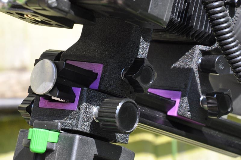

I inherited these Nikon PB6 macro bellows some years ago and although they have seen very little use, the nylon(?) bearings have all fractured at a stress raising corner. I drew up replacements in Fusion 360
Several prototypes were printed and a few iterations required to get the rack and pinion to engage properly - all 3 were subtly different
Works now though smiley
PLA is probably not the ideal material for a bearing (nor, it seems, is nylon!) but it slides ok.
This repair alone has probably justified the cost of the printer.

I'll have to check mine to see if it is suffering from the same issue.
if it is, would you be willing to share the files, either Fusion or STL?
PLA can work OK as a bearing, many printers use it directly for sliding on stainless rods.

Excellent job, Rod
It will be interesting to see how long the PLA lasts ... but obviously you now have the ability to produce spares 'just in time'
Out of interest: Is there evidence of fillers in the original black plastic items?
... If so, some idea of the particle size & shape would be interesting.
I seem to recall that the Olympus equivalent used Nylon [or similar] of 'natural' colour.

The issue with the plastic inserts appears to be a known problem. Not sure that this is a modern trend - these bellows must be at least 35 years old. I've put the the STL files in my Dropbox here
I can't see any obvious signs of reinforcing filler at the fracture surfaces.
