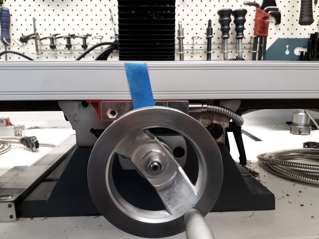

Recently purchased an "SNS-3V" DRO from our friends at the website that rhymes with "shmalleyshmexpress". Looking at my options for mounting the scales. So far those suggested on this website seem to be best: **LINK**
He has his X scale mounted on the front of the table. I was pretty set on the back of the table until I realised it would likely mean the removal of the table, which I'm not keen to do just yet. I would also have to modify the ways cover and haven't come up with an elegant way to do that. I didnt want to lose the table stops but then again, I've never used them on the Bridgeports at work in twelve years so...
Where have you mounted yours?
My machine is a BF20LV purchased here in NZ.

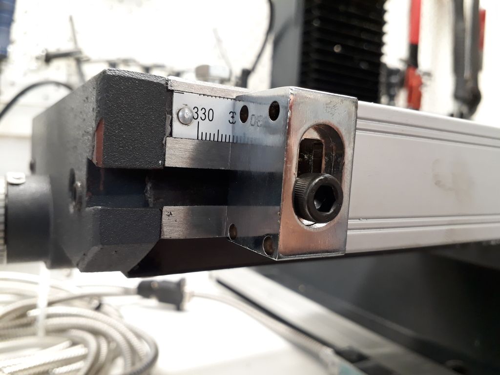

When I fitted glass scales and DRO to my Warco VMC mill, I made a slotted rail to go over the X-axis scale so that I could retain the travel stops as well as the power drive limiting stops. See the photo below. It may give you some idea of how I acheived it. ( The power feed limiters are the bits that look a little like railway buffers and the travel limit stops are the black button-like parts. )
x-axis scale 2
I should add that, in the two years that the DRO system has been fitted, I've never used either the travel stops or the power feed stops and I have removed both in prparation for a house move and don't intend to replace them when the mill is reinstalled at the new place. The DRO is perfectly adequate for the accurate positioning and machining up to a pre-determined position, I've found. Just my view, mind.

That's a nice clean install John. Did you bend up the scale cover or was it supplied? Mine came with covers but they're half again as wide as they need to be.

The scale covers are as supplied, save for the short vertical section that abutts the table. I had to reduce that by about half, so that it didn't protrude above the top surface of the table.

So I had another look with the intent on mounting it on the front of the table, and it looks like not only do I lose the stops but also complicate access to the gib clamps, which I can forsee myself wanting to use. I can probably remove the plastic handles and just use a nut driver to reach them, but this would also mean trimming the scale cover down to the point where it's hardly worth installing. I may just do this and if and when I take the table off swap it to the back. I think the right answer now is to just "get 'er done" and do something else if it doesn't work!
What's the general consensus on covers for the scales? It doesn't seem as if the X is that vulnerable to swarf or coolant, though the way I plan to mount the Y axis scale (on an angle, as in the link in my first post) it looks like swarf could get between the scale and head.

When I fitted a DRO system to my Chester Lux style mill many years ago I reworked the stop system to make it shallower using an ordinary hex head bolt instead of the cap head provided. I left a space between the edge of the table for access to the adjustable stops and hex-head set screw for the which replaced the standard Bristol style handle on the lock. Changed the hand wheel for a folding type with a longer boss to win little more space. From memory the hand wheel only needed to be moved out about half an inch, maybe touch less, to find space for everything.
Space for spanner can be seen in the picture. Only just enough vertical space for the glass scale above the slipways and hand wheel boss. These days I'd go magnetic every time on a small machine.

My mill looks like a later version of yours and sold in Australia as a HM-45 (RF-45 clone). Glass scales will fit at the rear of the table with a few mm to spare between the cover and the mill column.
Paul.
