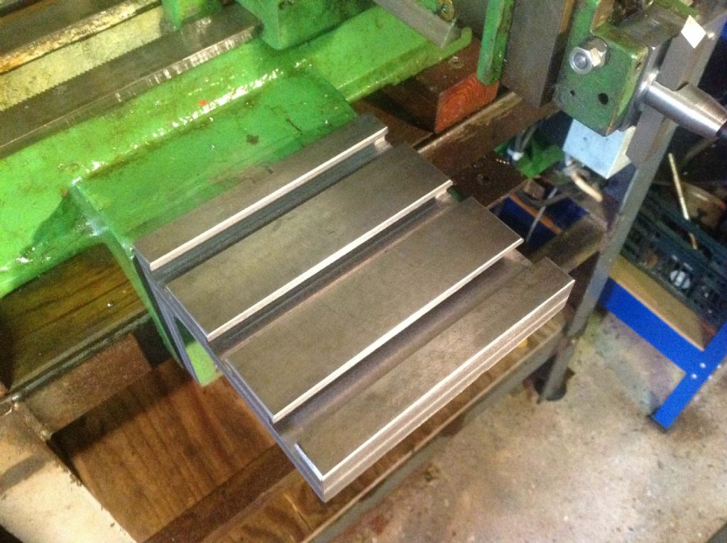

Martin Connelly19/11/2017 17:54:01
avatar
2549 forum posts
235 photos
I have just noticed that I have a picture of my 16mm version of this type of end mill in my albums. This was being used on silver steel and gave a good finish as can be seen.
Martin C
It is branded Teknik and was made in Turkey. I can't remember exactly but I think it was bought on Ebay.
