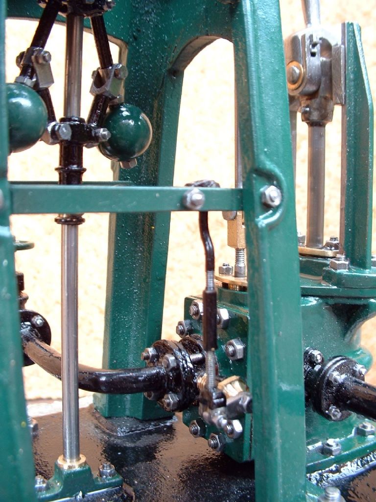

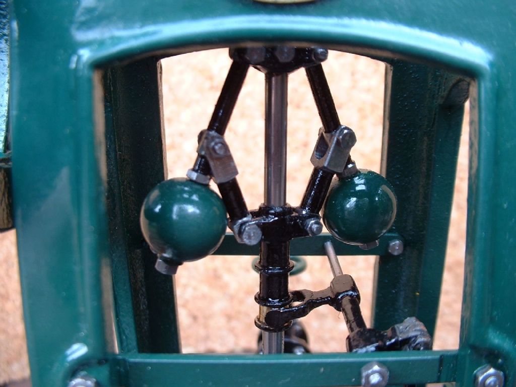

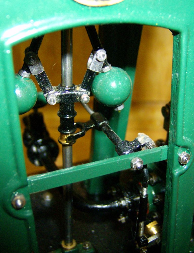

What matters, IMHO is the force available to correct the governor position.
This makes it all even more complex, as the displacement for any given error in speed will be much smaller, and that would suggest you really need a proportionately more sensitive mechanism. In particular 'stiction' in the valve is going to be a major obstacle for achieving the same degree of control as a full-size governor.
I don't speak from complete ignorance of the practicalities, I built enough bits to make about three non-functional governors before succeeding with this working one, in 1/12 scale.
I now in the other thread there were comments about the valve closing completely, I just settled for a loose fitting valve spindle so it just gives a significant throttling effect. That said I am not convinced it has any significant impact on engine speed.
