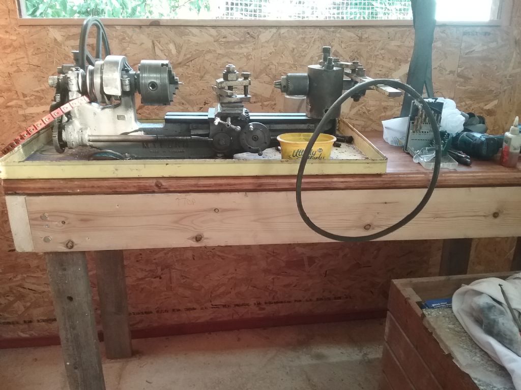

To start, this is a shoe string project, my aim is to repair/ recondition the lathe to good function and not to a concours / museum piece standard. the Lathe is now bolted to a strong bench, started cleaning decades of dirt off. First job to do is get some temporary drive system. The spindle pulley is for 3/ 4 flat belt but the medium and small pulley have been freehand filed to a rough v belt profile leaving only the largest one for a flat belt. It will be some time before I can make a new triple pulley so my current thinking is to run a flat belt from spindle to a lay shaft and to have the speed change pulleys on the lays haft and the main reduction shaft. Do people still use flat belt , can you buy them, are there synthetic belts ?
Literature on early myfords makes reference to flat belt pulleys being "correctly crowned" how would I do This?
My little cowells 90 lathe has a reversing motor so I am planning the same for the ML1.
II have a 1/4, 1/3, 1/2 hp motors which size is best Suited?
More when I can get down to the shed.

Certainly an interesting assembly of parts. Polyvee fan belts used inside out seem to be popular for flat belts.
You might want to put cross braces the bottom of the legs on your bench - you will kick them, often.

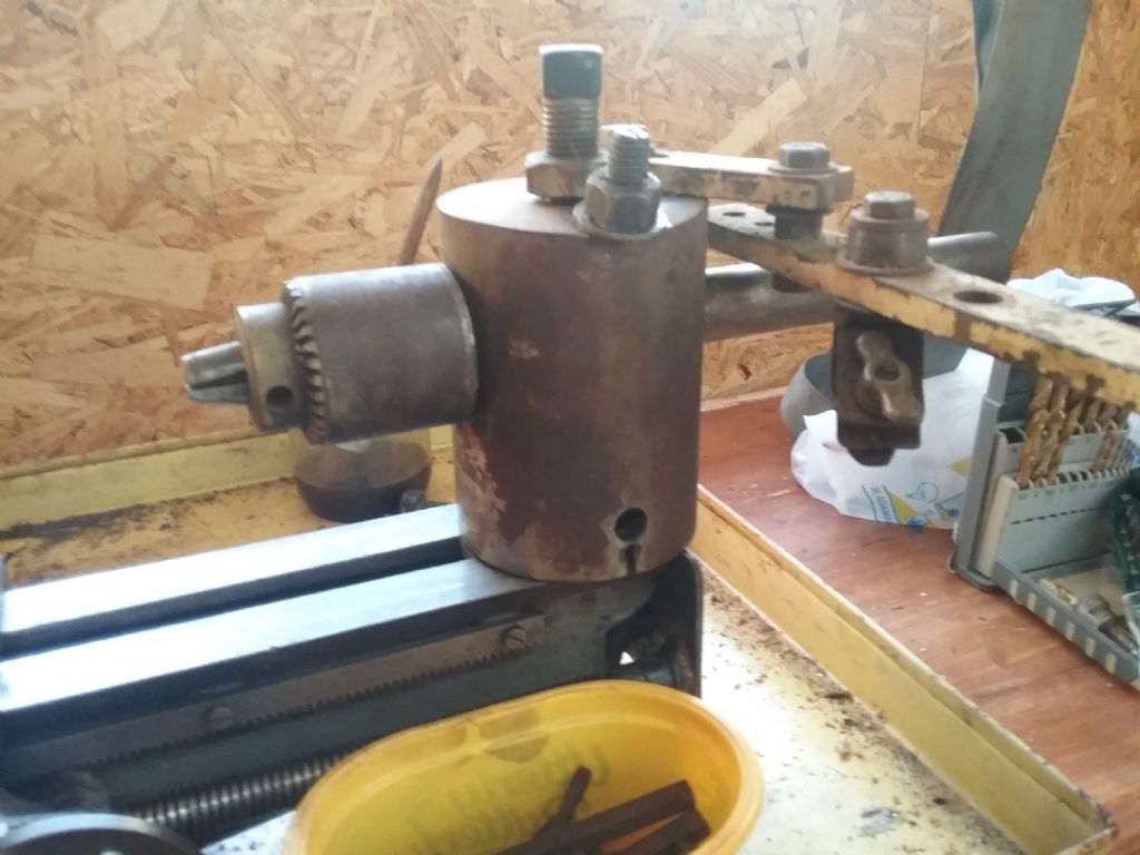

here is a closeup of the tailstock, this one of my priorities to sort out, dont know if it is true but the plunge shaft is worn, there is much slack ! need to replace it with something more conventional that i can put in a live centre.
yes i will brace the table legs once i have fitted the motor, the motor has to go down as there is a window behind lathe, so it cant go up, as well as bracing i will put a shelf in.

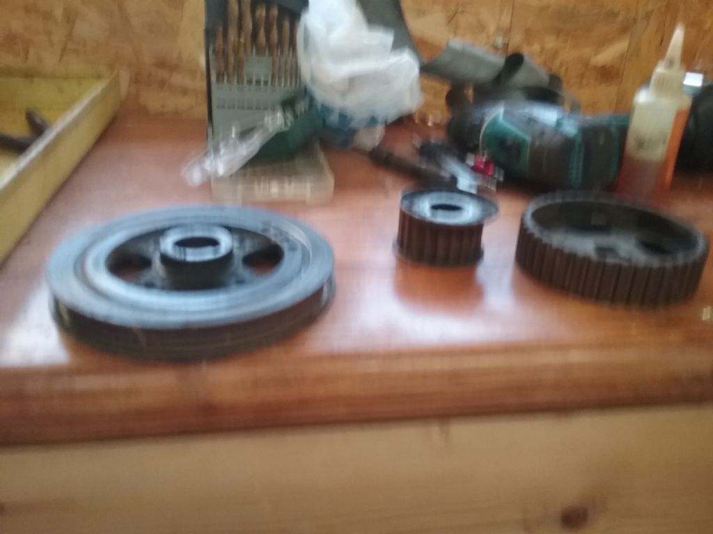

Louis Showell27/06/2017 23:45:40
50 forum posts
28 photos
Sorry not a good picture, the large all steel poly v pulley could be used as a blank to make a face plate.

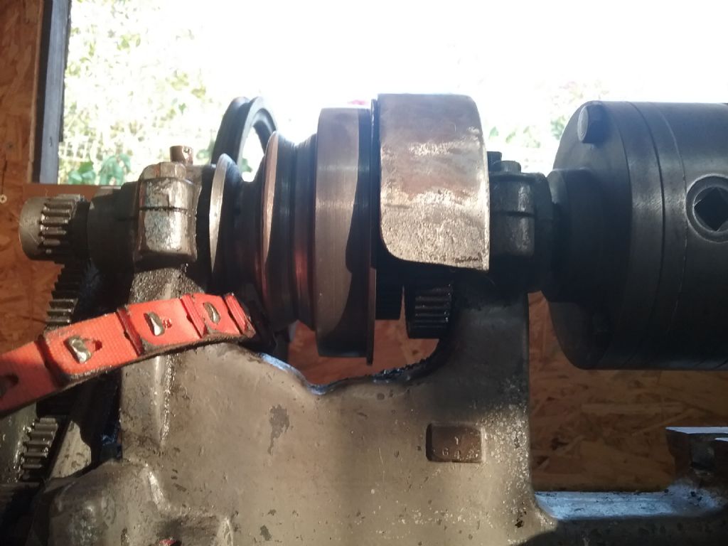

The roughly filed out Vs could be filled with something like JB weld to get you started, or even 2 part epoxy mixed with iron/steel filings mixed in.

The tailstock is an interesting one. You may be able to bore out the hole and fit a bronze bush to take up the wear. Then make up an insert to adapt to an MT1 live centre.

Excellent, that's a plan, I will fill the spindle pulley with a loaded filler, then make a wooden triple pulley the same and maybe coat it with filler and use a poly very belt. Then I can dispense with my extra layshaft idea and keep things simple. Just need to extend the shaft in the main reduction pulley , it is about 15cm at present and need to extend it to about 25cm, being 3/4" it should take a small overhang either end.

Louis Showell27/07/2017 12:52:46
50 forum posts
28 photos
20170626_185615.jpgHere is the pulley before repair , looks as though the headstock has been relieved as well to give room for the V belt.
Edited By Louis Showell on 27/07/2017 12:54:02

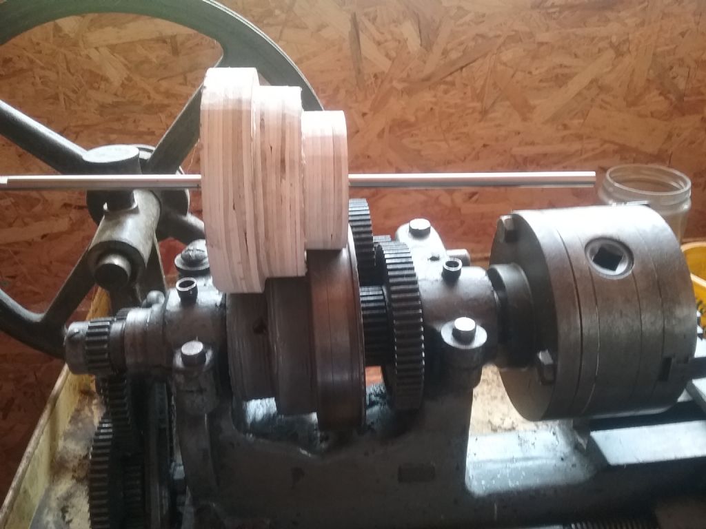

Louis Showell27/07/2017 12:59:51
50 forum posts
28 photos
Pulley after application of out of date epoxy putty, hope it goes off sufficiently hard. also the ruffed out ply pulley, it is 18mm ply so I am looking for 16 or 17mm poly v belt. Intermediate shaft is 20mm.20170727_133403.jpg
Louis Showell27/07/2017 13:02:41
50 forum posts
28 photos
6mm shaft used for centralising during gluing, also 6mm is ideal for the 20mm cutter which has a 6mm pilot.
Hopper27/07/2017 23:59:30
avatar
7881 forum posts
397 photos
Very clever.
Re top rpm, it seems those old lathes with bronze bushes in the headstock, or white metal even, usually had a top speed of about 800rpm. I've run my old Drummond of similar vintage with bronze headstock bearings at up to 1,000 rpm without problems. But 800rpm, with 400 and 200rpm using the other pulley steps seems to give a more useable range of speeds. Usually the pulley ratios are 2:1 from headstock to countershaft or vice versa so you want the countershaft running at about 400rpm.
