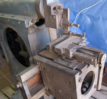

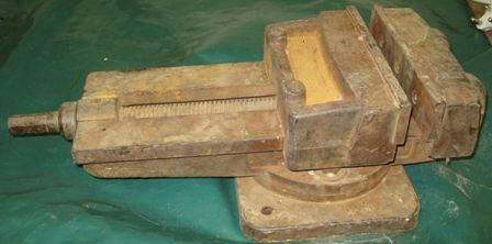

It has it's vice as well.
Ignore that 'tool-holder' that is a real 'Farm made' device...

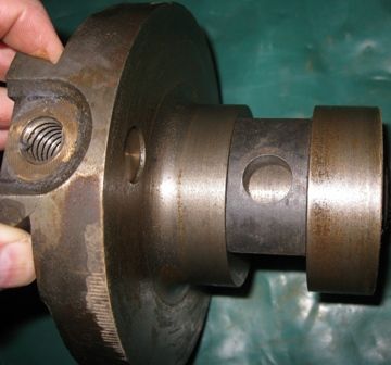

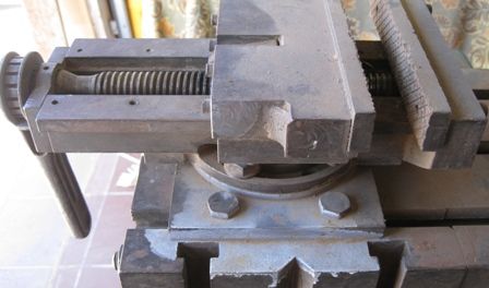

Vice seems fine, except for chipped top edges where the diamond pattern of the jaw face seems to have chipped away. Why the diamond jaw face to start?? Surely that would mar the work?

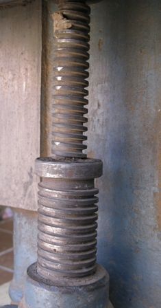

Slides do not seem to show any sign of wear. The table jack-screw appears unworn, as does the table cross leadscrew. Seen below, the screws appear to be coated in a dark gunge, very thin, almost like a long-dried out grease. It chips of quite easily, and under it is a bright, shiny silver screw! You can see the three bright spots where I just removed the grunge with my finger nail. Silver underneath!

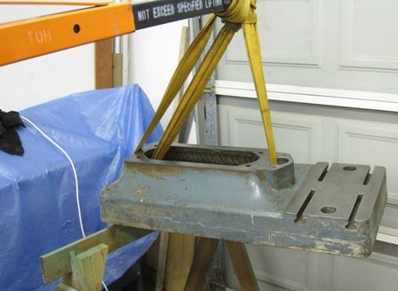

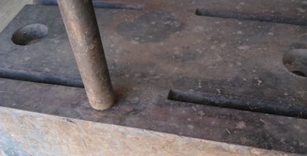

The table front support rod impinges on the base as the table moves across during cross feed, but there is NO disernable groove, marking or scratches on the base under the support rod's path at all.

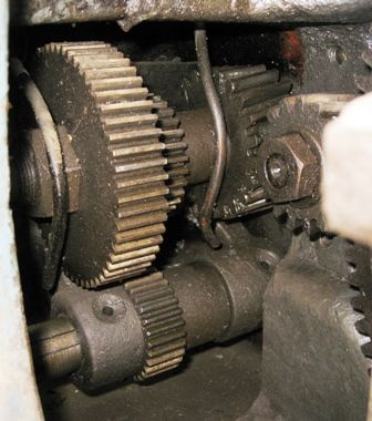

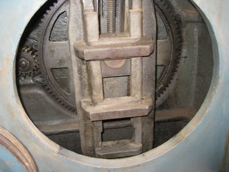

Bull Gear is very clean, slightly oily, and the teeth look very good. There is no visible sign of wear along the contact area between the Rocking Bracket and the Stroke Adjusting Slide. Likewise, the gears in the gearbox are slightly oily, otherwise clean, and the teeth show no wear that I can see - teeth tips are still square edged.

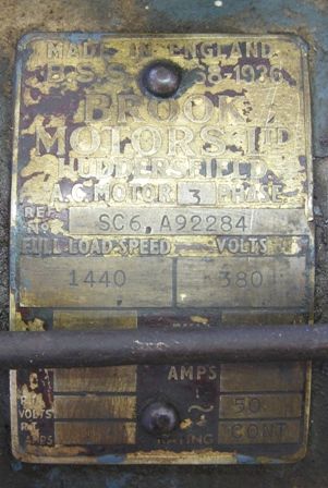

The motor is a 3pahse motor, 380volt, huge, but only 1HP....1.75amps at full load, it says..
Not sure what the B.S.S - 68-1936 stands for. Some British Standard?
Or is 1936 a date...?
I will probably replace the motor..

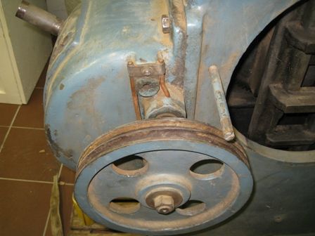

These two copper pipes are obviously for lubrication, but how? With and oil can? Or where they oil-pots attached at some time? - such as in the photos 4 from the top?

Copper tubes on motor often just had a small flap over them.
Couple of drops of oil to lube the bearings.

BS -1936 Refers to a British Standard about screw threads.
Edited By Brian Sweeting on 23/06/2017 16:13:01

Your comment on the BS-1936...The text on the motor label is B.S.S - 68-1936 - I presume this would not have anything to do with Thread standards!

The vice you have is not the original, I have one that is and it does have flat jaws as well as being a bit more substantial. However, yours looks like it should be good enough for all practical purposes. I would suggest finding someone with a surface grinder and taking off the serrations from the jaws.

Thank you for your informative response. I am disappointed in the non-original vice! Closer scrutiny indicates that this vice is completely fabricated - all its parts are cap-screwed together. The swivel base appears to have been machined, on a lathe, from a 200mm square by 40mm thick chunk of steel, with the semi-circular slots for the swivel bolts done on a mill. All the machining marks, very fine marks mind you, are visible. This looks like it was an Apprentice task in the time.. I also fear that this vise might be a little flimsy - I envisage some 'rocking' on its swivel base. So, now look for a vise...
The seller did throw in another vice, a huge thing, very rusted and jaws more than nicked..definitely also not from this shaper.-  I can just manage to lift it..

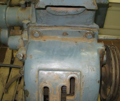

WRT the various oilers-
On the upper part of the gearbox cover at the rear are some oilers, but just seem to be holes in the casing, with a copper pipe exiting the hole and going down to the gears. Would there have been a oil-cup here? Or perhaps just one of those flip-caps that you lift and apply an oil squirt from an oil can? Hard to see if there was such a cap, as if there was, it would be broken of flush with the case.
Ditto the two pipes on the right of the gearbox case providing lube to the pulley drive shaft. No caps, or sign of cap retainer.

How does the clutch work on these machines? I have not found any useful images or descriptions yet. I don't suppose a simple motor pivot to remove the belt tension would work well - the belt could grab in an indeterminate fashion when inching, with bum-clenching results..

B.S.S stands for 'British Standard Specification'. The term seems to have disappeared around WW2, being replaced simply by 'BS'. Just a guess but some of the early British Standards were reports rather than full specifications; later British Standards - I think - are always specifications.
1936 is the date the specification was issued. The 68 is a mystery - it doesn't seem to have anything to do with motors. Could it be that the plate has been defaced by that rivet, and that part of the BSS number is missing?

Hi Joseph, Your second vice looks more like my one, although not exactly the same. I can hardly lift mine so it sound solid enough. It looks like yours might clean up OK.
The gearbox casting on mine is a bit different, the bosses for the clutch lever and rod are cast in. It has oil cups with lids on the bosses of the gear shafts on both sides. These are right on the boss, eg no copper pipe extension. This does mean that they are down behind the pulley and its guard, or would be if the guard was in place, so a bit hard to get at. It may be that yours had the same, and someone has added the pipes to make them more accessible.
The clutch works from a lever on the drivers side, and stays either engaged or disengaged. Since you don't have it, you might find the inching available from a vfd useful. You set the length of the stroke as mentioned with the knurled nut and square shaft on the end of the bull gear shaft, then loosen the square on the top of the ram where the slot is, and slide the ram back and forth to adjust the position of the stroke over the job. The ram is quite heavy to pull back and forth but doable. Of course, if the nut is loose and you put the machine in gear, the nut will slide back and forth in the slot, which can let you adjust the position without manhandling the ram, but only do this on a low speed.
I don't know if you will want to take the head off the ram, perhaps for painting. There is a bit of a trick to this, and having not done it for a few years I might be confusing myself with my other Alba, which is the 10 inch model. If I recall correctly, the square nut above the ram has an eccentric pin on the inside end. This engages with a segment piece which runs in a slot in the actual ram head. So to angle the head you loosen the square which unclamps the head, and it will swivel. To take it right off, you look for a small grubscrew on the side of the ram just below that square and take it out. This lets you take out the square shaft with the eccentric pin on the end, and now the head should pull out. (With the 10 inch, you have to swivel the head upside down but I don't think this is the case with the bigger one.)
The trick part comes when putting it back together. The segment piece with the hole for the eccentric pin has to sit in its groove in the ram head, then you push it into place on the ram, then you drop in the shaft so that the eccentric pin engages with the hole. Except the segment piece is likely to be in the wrong place and you will spend a bit of time trying to get it all lined up!

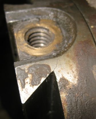

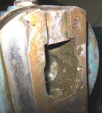

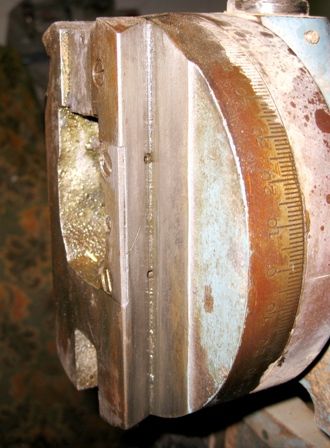

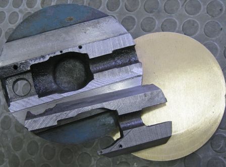

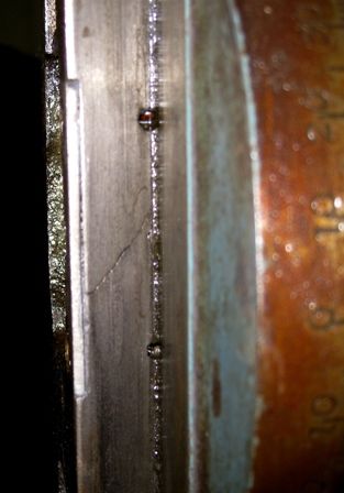

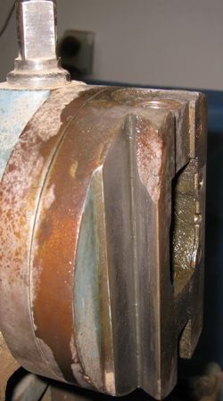

And then Lady Luck struck a really nasty blow...
After removing the Ram Head, I stripped the vertical slide from the head and discovered broken dovetails, with a real kludge 'repair'...
Top of head showing crack upper right of lower dovetail.
Right side dovetail, showing added plate and screws to keep dovetail pieces in place!
Crack midway down right dovetail.
View of right dovetail 'Repair' and broken/missing piece of upper rear dovetail.
Left dovetail break.
So Sad! The rest of the machine is really in very good condition. Very little wear evident anywhere. I think the scoring on the lower flats of the Ram dovetails is due to lack of oil - the oil holes were blocked with muck and if oil was applied, it went nowhere..However, on many parts of the ram slide it appears that I can still see original machine marks, so little wear has occurred. There is no rust worth speaking of, and most of the plain metal parts are dull from oily grime - as though a greased or oily rag was used to wipe the machine down and then left for years.
Going to be interesting machining a whole new one of these!
There is no room to bolt on a thick plate in front and make new dovetails, nowhere to fit the fixing bolts, etc.
I have NO idea how I am going to fix this, short of make a complete new head!
And bright Ideas anyone???

That will need bit of thought. It would be easy enough if the hole for the lead screw was not there. Just machine it flat and screw on a block to machine new dovetails on. But that would leave you with about half of the hole for the lead screw.
Mine had a chunk broken off the dovetail on the down slide, but that was on the side with the gibb screws, so cleaning up the break and screwing on a block was all that was needed. It is probably quite unusual to find an older machine that has not had crash at some time. On my 6 inch Ammco machine the slotted arm inside had been broken and brazed together at some point.
I had a closer look at mine. It does have the two oil holes on the top of the gear box, they are a bit hidden behind the clutch actuating rod, which runs across there. No sign of oil pots and there wouldn't be room there anyway.
I've taken a few photos which I will put in my album.

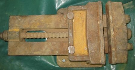

Thanks for the pics Dave. My second vice, 'given' with the shaper, seems more in line with your vice. Quite substantial and darn heavy.
Why is it that the vice needs the 'through' leadscrew for shaper use? I understand the difference in terms of the one leadscrew under tension and the other in compression, by surely either would generate sufficient squeeze on the work piece? I have a big China vice, very study and well made, but with a compression leadscrew, the screw is about 25mm diameter - I doubt that would bow under the pressure?
Sometimes, to the un-intiated and uneducated, a lot of this seems so much folk-lore..

Well, I have never really studied the screw arrangements on the vices of my several shapers, but I would say that so long as it is a good substantial vice it will do the job. It is of course nice if it is original, especially if the machine is regarded as a kind of vintage item. They are often no longer with the machine, since a shaper vice makes a good vice for a milling machine. When I bought my 2S, the machinery dealer told me afterwards that they had regretted giving it to me for the quite cheap price, since they could have got that much for the vice alone. They probably could have to.
Shaper doors are often missing too.

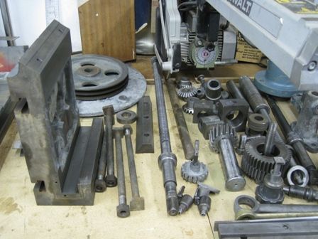

All is stripped down to the last screw and being cleaned, all old paint removed, sanded, etc - ready to paint one of these days. Requires careful co-ordination as a fully cleaned and degreased part should really be primed the same day - in our coastal town the part will have a nice brown sheen of fine rust by the next day!
I also was quite keen to replace many of the bolts an nuts with new, but nary an imperial thread to be found in Southern Africa..
I have taken many photos during the strip down so that I can see which parts goes where and how..I will post some photos as the work proceeds - at least when I am tired of cleaning and sanding, and sufficiently high on thinners, and can digress and start making my dovetail cutter...
Right, lets go sniff some more thinners...

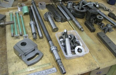

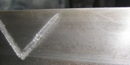

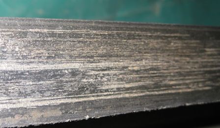

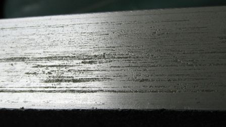

There is progress on the ALBA 2S cleanup, a bit slow as it is cold in the shop at the moment. Also, humidity is so high that rust is a menace right now!

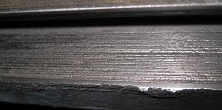

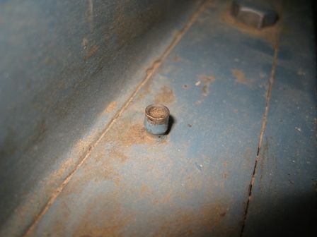

Some pics of the cleanup are shown, but in the process I found that the Ram slides have some deep scoring. The right hand horizontal slide on the column and the Ram ( Ram underside) show deep scoring from the middle of the slide almost all the way to the rear of the slide. The forward half is good, small scoring, and the left slide is pretty good as well, with a small scored section. Some photos are below.
Do I need to concern myself about this? I suppose I do, but how badly? Is there anything I can do to remedy this to some useful extent? Applying fine brass dust filled epoxy and sanding smooth? Maybe that will make matters worse if the epoxy comes loose..
The worst of the scoring is almost across the width of the slide face, and score depth varies from a thumbnail detectable nick, to maybe 0.2 to 0.4mm deep.
There is not a mill or shaper within 1500km from me where the surfaces could maybe be re-finished..
The column left side flat slide, showing good surface
The worst part of the right side column flat slide.
Ram flat slide, right side under - a bad area.
Another bad section of the Ram rights underside flat slide.

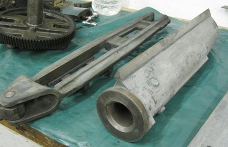

The cleanup in progress:

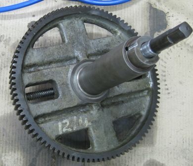

Bull Gear
Column is done, the base next

With regard shaper vices, I've always assumed that they are 'pull' close (rather than 'push' ) because of the side forces involved in shaper work. If the jaws are set parallel to the ram movement, then there is no difference that I can think of. But if the vice is rotated 90 degrees to the ram direction, then the ram 'impact' will normally be against the moving jaw (as the clamping handle will be away from the shaper body) and I think that a moving jaw held by a screw passing right through its body has to be a bit more robust than a moving jaw being simply pushed closed from the rear (as many milling or drilling vices are).
As I've said - that's what I've always "assumed" and not being any sort of trained engineer (and certainly no rocket scientist) this may be completely false - but as a regular shaper 'user' it seems to make good sense to me. I think the same argument holds when you think about why shaper vices are quite shallow (compared to other vices). Most milling processes don't generate anything like the side forces that a shaper can do.

Most of the other parts are painted.
And the other parts all cleaned up and shiny..
The Rusty vice stripped down
And into the electrolytic de-rusting bath..
All nice and clean now..

And some work has started on the broken dovetail -
The 'old' dovetail has been sawn off, and a slice of phosphor bronze obtained to cut a new dovetail and bolt the new section onto the front of the skimmed clean ram head.
Joe...
