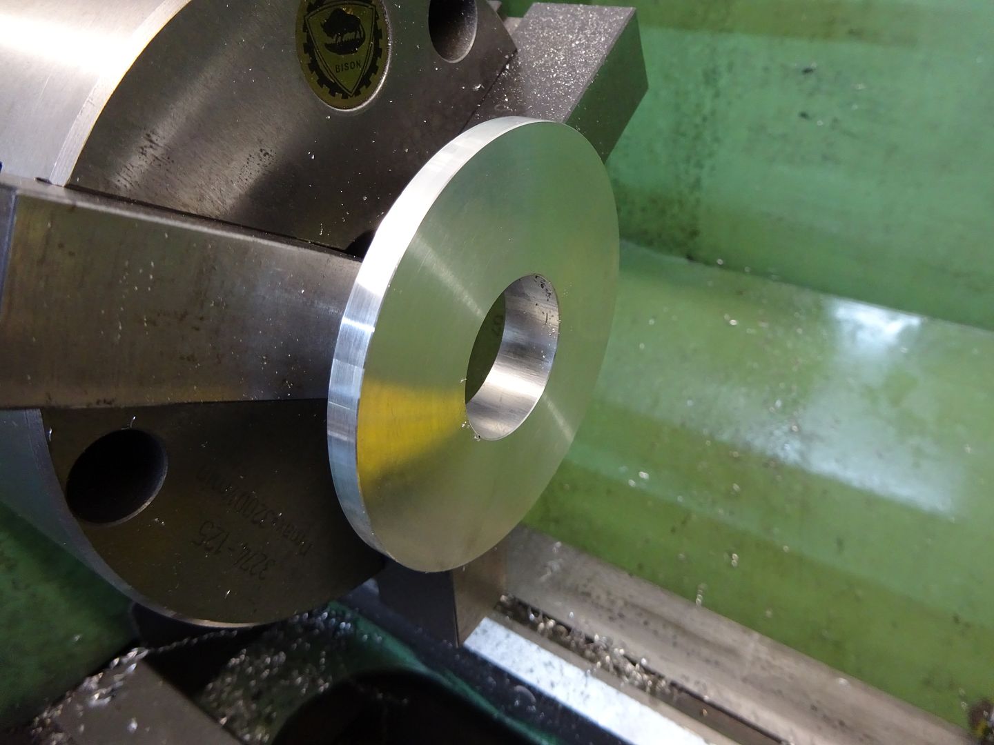

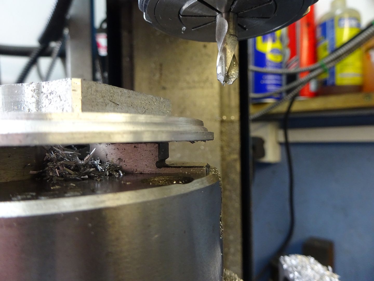

BASE
Drawing #1
This can be made from a slice of 75mm or 3" dia aluminium or could even be done from some 12mm plate. I started with a slice of round bar, held in the 3-jaw to face off and then bore the 28.5mm hole right through. I also removed some of the waste by turning a 60mm dia spigot.
The spigot also made it easy to hold the base the other way around to face off the bottom.
The base can then be mounted on the rotary table and clocked in true to the spindle to start shaping the raised area. I used an old 10mm dia milling cutter with the corners ground off to a small 1mm or so radius so that it left a fillet as you tend to see on castings but it could be left square if you prefer. Start by cutting in from one side until the face is 21mm from centre.
Next cut the two sides, I have shown the point where the 10mm cutter should stop at 22mm in the Y axis and 13.86 in the X axis.
The table can now be rotated to reduce the rest to 42mm dia
Next add the decorative moulding to the edge, an old 6mm dia cutter can be ground by hand either on the corner of the bench grinders wheel or with a dremel which will give an acceptable shape.
While held like this the Hole for the chimney can be drilled 9mm and then tapped M10x1, if you don't have fine pitch metric taps then 3/8" ME threads would do.
The base can now be held upside down in the vice with the flat edge against the fixed jaw, clocked central to the spindle and the four M3 clearance holes drilled, I tend to use 3.0mm drills for this as the socket head CSK screws tend to come in at about 2.8mm OD. I won't keep mentioning it but ease the edges of all holes either with a CSK bit or a lathe tool ground at 45degrees, you will often see these tools in the photos as it it the last op before taking the pic.
To mill the exhaust passage I dusted off the swivel base for my vice which was the first time I have used it in the 10yrs since I bought it, set the vice to 45degrees and then with an 8mm cutter cut the slot 3mm deep . If you don't have a swivel vice base then the base can be clamped directly to the mill table and the angle is not critical.
That's the first part out of the way

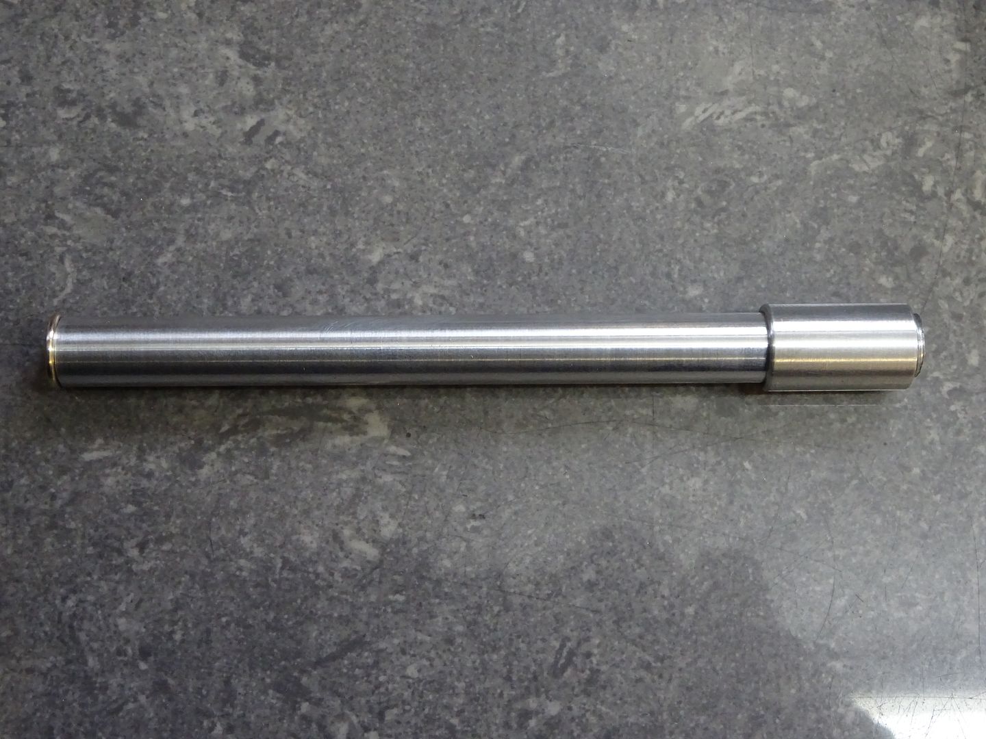

Crankshaft Parts
Drawing #6
I made a start with the crank web and to make it easier to hold actually machined it on one end of a short length of 40mm dia steel bar and the cam on the other end.
Start by facing the end of your stock, then using a tool with a small radius on the corner turn the 3mm long spigot and also the 38mm OD. Followed by drilling and reaming the central 5.0mm hole.
Transfer to the mill, locate centre and then use the handwheel dial or DRO to move 16mm and then drill and tap M3.
Saw or part off and then holding by the spigot clean up the other side but leave the web about 0.5mm over thickness at this stage. Mark out the two straight edges, saw off the waste and then mill back to the lines.
A bit of simple file work will round off the edges.
The crank shaft can be made from precision ground mild steel (PGMS) or silver steel, stainless would also be OK if it is a good fit in your bearings. Face it off either end but leave it 1.0mm longer and then turn the spigot also 1.0mm over length. The crank web can be used as a gauge to get the spigot a firm push fit into the hole. Once done clean up both parts and loctite them together.
Once the Loctite has had a good time to set the crank can go back into the lathe to have the web faced down to the final 3mm thickness. Doing it this way will ensure the face of teh web is at right angles to teh shaft even if it went on a bit crooked when loctited.
The crank pin is fairly straight forward turning, put a small undercut at the base of the thread to ensure it screws right into the web and the shoulder makes contact. Saw or part off then clean up to leave the lip 1.0mm thick and add a small chamfer.
