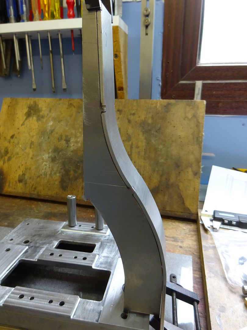

You could do it in a press or even heavy bench vice using 3 pressure points and working along the length, best done as two half circles as 6" is a bit small and will close up around the press/vice.
This is the sort of thing
Quite controlable once you get the feel for it
Another option may be to make it out of a couple of rings cut oversize from 4 or 6mm material lightly rivited and then soldered into one piece with a high temp silver solder. Then turn to fit your tube and solder with a lower temp one.

hi Guys wow, thats some clever answers to try. I am very grateful for your answers, The three pin, is well worth a try, as for solid sheet, i did ask, even thickwall non ferrous tubes but alas nothing, have to keep a eye on ebay! The three pins ideas is very clever indeed! it looks like you are making a big stuart turner standard ! instead of a casting. thanks once again.vic
