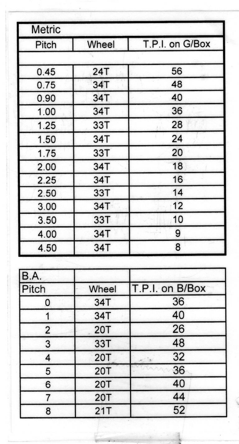

John Stevenson used to sell a pair of 33 & 34 T gears from his online shop www.metoolsonline.co.uk, but had to close the shop, then sadly his wife passed away; don't know if he re-opened it. (Hope I remember it right John)
Below is the gear chart he supplied with the 33/34T pair. (including typo on the BA chart).  Hope he doesn't object to it being reproduced.

Robbo beat me to it, but I'll post this anyway - it's the table I use:
**LINK**

S.D.L.12/03/2017 18:23:16
236 forum posts
37 photos
Posted by Otley on 11/03/2017 15:21:30:
**LINK**
How do the top 3 rows read,
The Metric and BA is clear, but haven't sussed the top three rows.
Steve

Brian Wood12/03/2017 18:34:36
2742 forum posts
39 photos
Hello Steve,
​Surely they are the tpi you can expect by using fine feed [as it says] with a standard mandrel gear of 24 teeth
Regards
Brian
