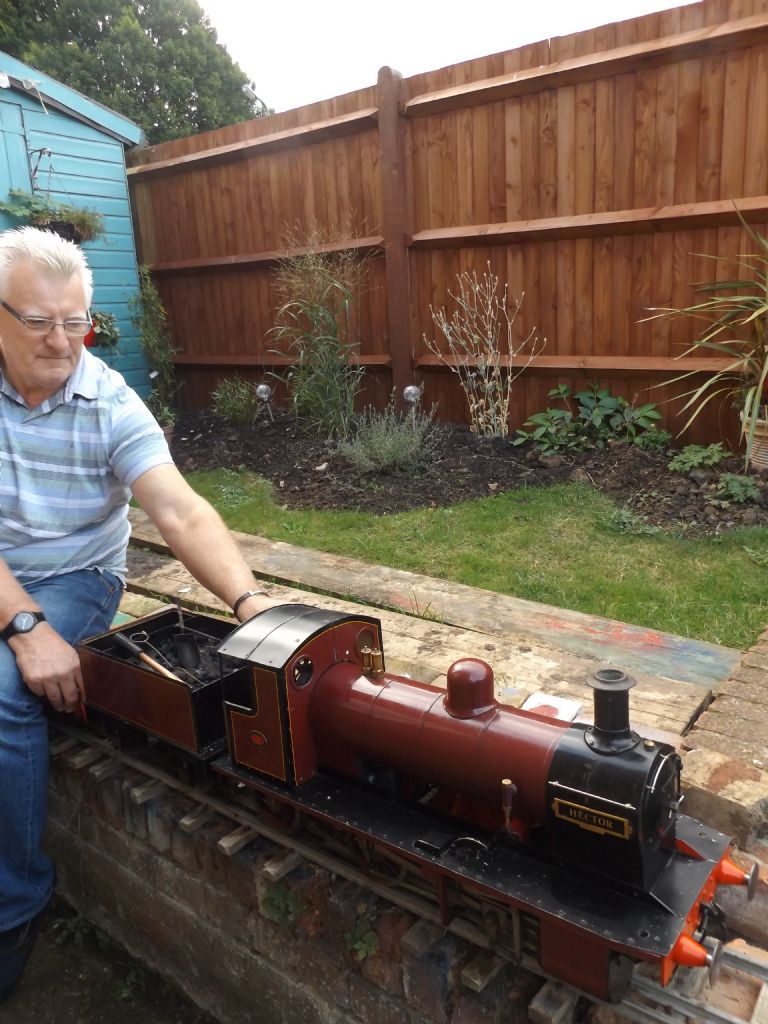

Hi Greg
I have an Ajax built by my uncle around 1970 it did good service back then its on its second boiler in 1993 now and extended into a 0-6-0 with a Railmotor tender. It was designed by Dick Simmonds from Erith and built and bits supplied by Fred Stone, long gone now but a popular design, simple workhorse, the Welling & District MES still have one for a club loco, the only critism of the boiler was its relatively deep fire box and can clinker up, but a good rake now and then stops that ! We still steam for the grandchildrens rides in the garden. In my view a good choice to build.
Regards Ray

Ray Wood 309/03/2017 12:09:27
avatar
6 forum posts
3 photos
Hi Greg
This is the Ajax my uncle built in 1970, he then extended the frames plus an extra pair of drivers to create 0-6-0 and re-named the loco Hector to keep the theme. As you can see us happily steaming in the garden couple of other shots in the album. Regards Rayhector & kids oct 16 008.jpg
Greg H10/03/2017 21:45:56
avatar
47 forum posts
Hi Ray, that is different to what I was expecting. One thing about a free lance design is you can do it however you like.
It must be nice to have a bit of track in the backyard.
Greg
