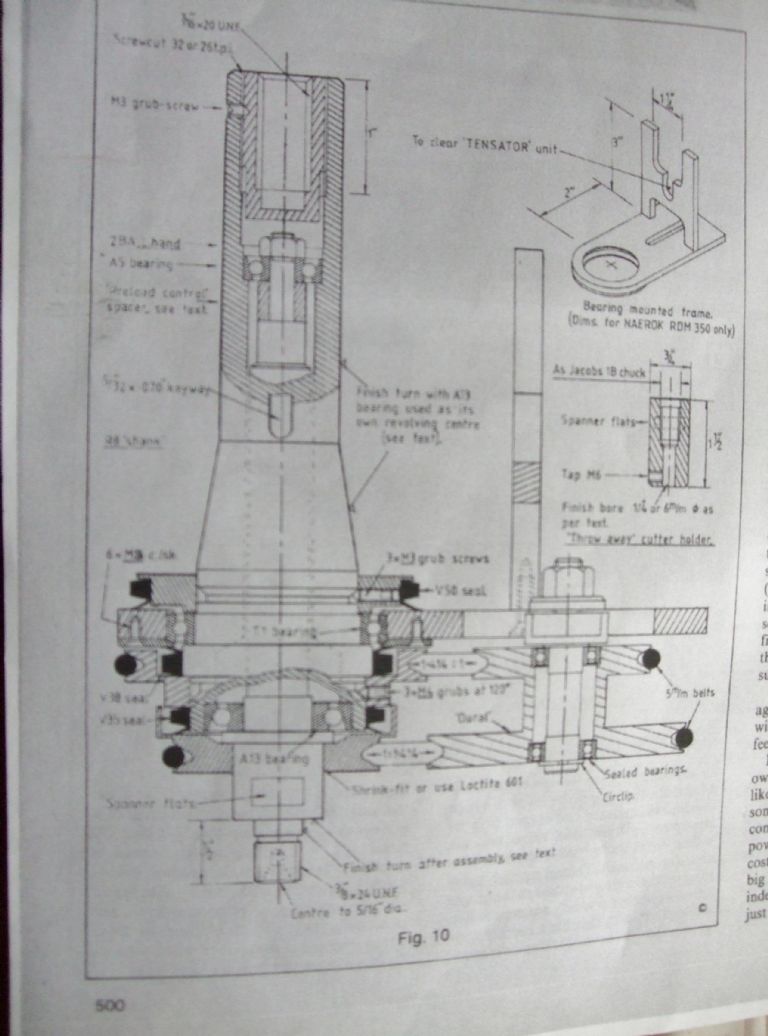

Emgee27/01/2017 11:27:42
2610 forum posts
312 photos
I believe the Novamill has an R8, BT30 or 35 spindle, if so there was an article in ME 21 April 1989 showing details to build a speed multiplier, with that you would get 5k to 20k from your 5k spindle.
I planned to build one using an ER 11 collet chuck on a 12mm spindle to keep rotating mass as low as possible. You may loose a little height to table but no more than if you use the Coventry quick tool changer chuck.
Picture of drawing attached, if it breaches copyright perhaps Neil will remove it.
Emgee

Yes it's a BT30 spindle. One problem with this sort of gadget is that the machine has little enough headroom as it is. That's why I don't use the Coventry system very much and I'm also trying to work out how to make a very short collet chuck as it's hard to find an er16 chuck with less than ~50 mm projection. I have wondered if one could put a motor on top of the head with a shaft through a BT30 arbor.
