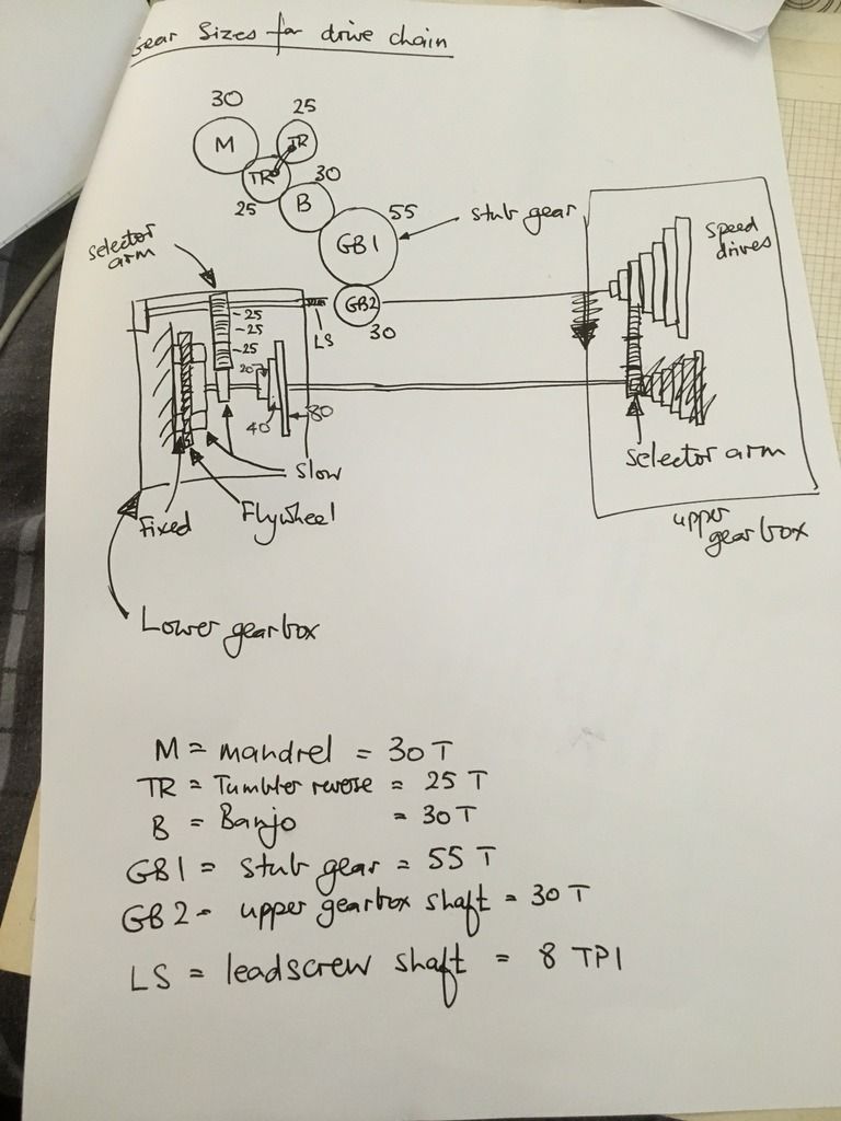

So the problem I have is that I bought a second hand lathe that is a Drummond but the auto feed/ thread cutting setup has all been replaced with a quick change gear box I think it is a myford one.
Now the problem is that when I in gage the the auto feed it slips the gear labelled gb1 this gear is a 55 tooth gear with a 72 mm diameter the gears ethre side are 30 tooth but I don't know the size I think they're 40 mm now all the notes I have for the lathe the guy before me made when he converted it say that the dp is 20 for all Of the gears.
i think that the gear labelled gb1 needs to be a 60 tooth gear and 78 mm diameter so it is still 20 dp but also a maltipall of 30. I think this because 30 doesn't go in to 55 but it does go in to 60 and the 55 tooth gear won't let the other 2 gears ether side turn as the mesh line isn't right because there are not enough teeth on the gear which the means the gears can't turn so it slips the gear

It isn't necessary that 30 goes into 55 what is important is the ratio between the spindle rotation and the input to the gearbox. This depends on that the gearbox expects. The simplest thing is for a Myford user to tell us what the gears are on a regular lathe, then see how this compares to what you have.

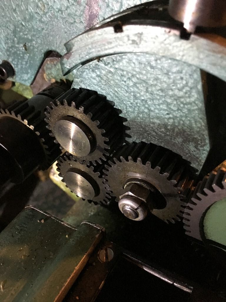

When I say slip gb1 the rest up to that point spin but the gear gb1 spins and didn't mesh with gb2 throwing it out of mesh but the gears fit together so I think they are both 20dp. When I turn it by hand it won't turn with the first gear box not connected so it is me trying to turn like 5 gears and it doesn't turn if that helps

Take a picture that shows GB1 and GB2. Then WITHOUT loosening the clamp on the banjo remove GB1 and take another picture. This will allow us to see if anything is preventing the banjo from allowing closer mesh between GB1 and GB2.

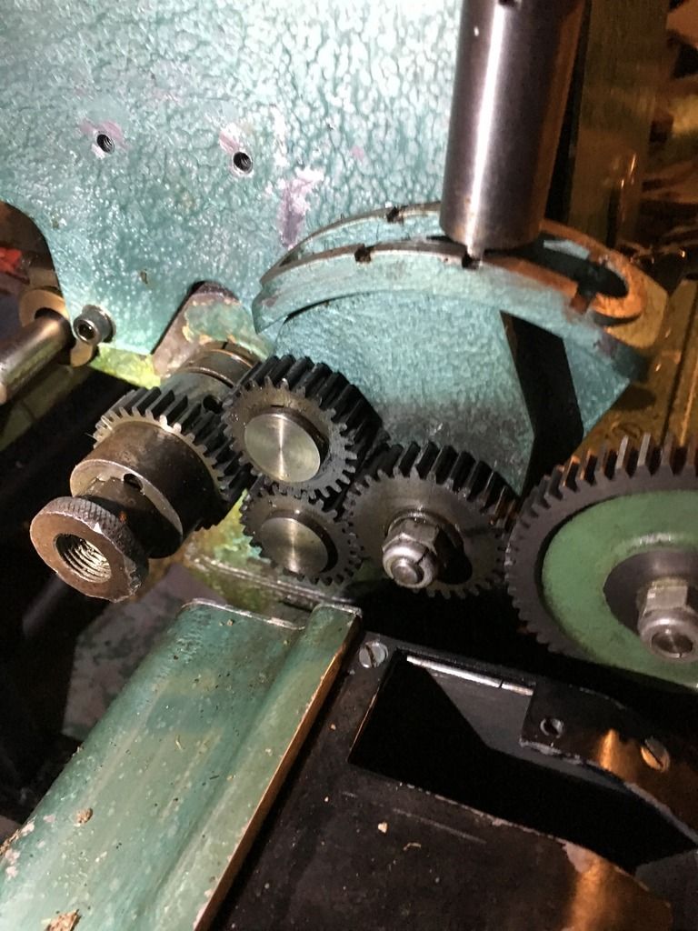

So I had a good look and the problem is the gear comes out of mesh between the bango and db1 I got the auto feed working going forwards or to the head stock but when I put it in to go the other way it locks up after doing this a couple of times it then when slip the gear going forwards so I think the problem may be with the mechanics that the bango is on moving and being loss as the gears seem to move up and down under lode I am going to try tittering it all tomorrow but if you have any other ideas it would help I have also uploaded some more photos

THe studs on which the gears rotate are normaly fixed into a slot in the banjo. You need to adjust the position of the stud in the slot so the gears are meshing correctly. there maybe flats in the part of the stud between the banjo and the gear so that you can use a thin spanner to prevent the stud rotating while tightening the nut on the stud where it passes through the banjo.

OK, here is a sketch of Taris's set up he sent me by PM.
It looks like somebody has made a wonderful job of fitting up this gearbox!
It looks to me like if GB1 and 2 are not meshing, then the stud that GB 1 mounts on needs moving by slacking off the nut on the back of it and shifting in the banjo.
A picture of the gear train showing these gears as in the sketch would help too.

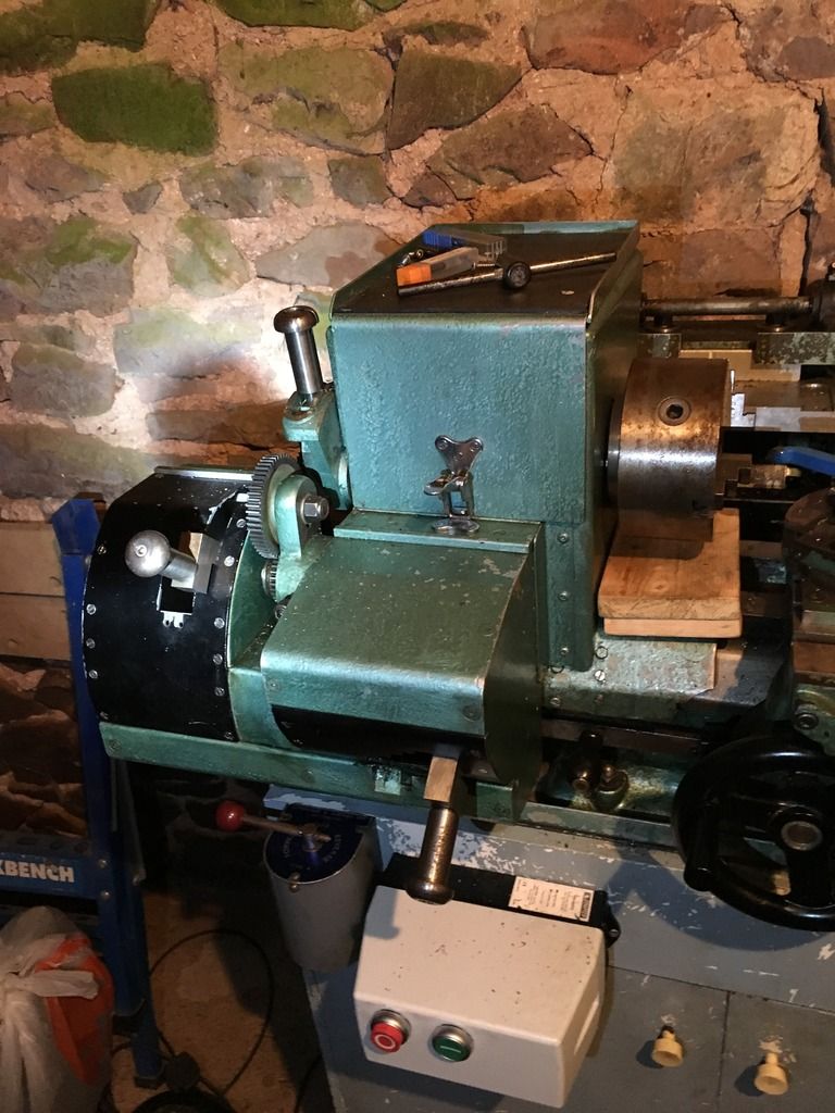

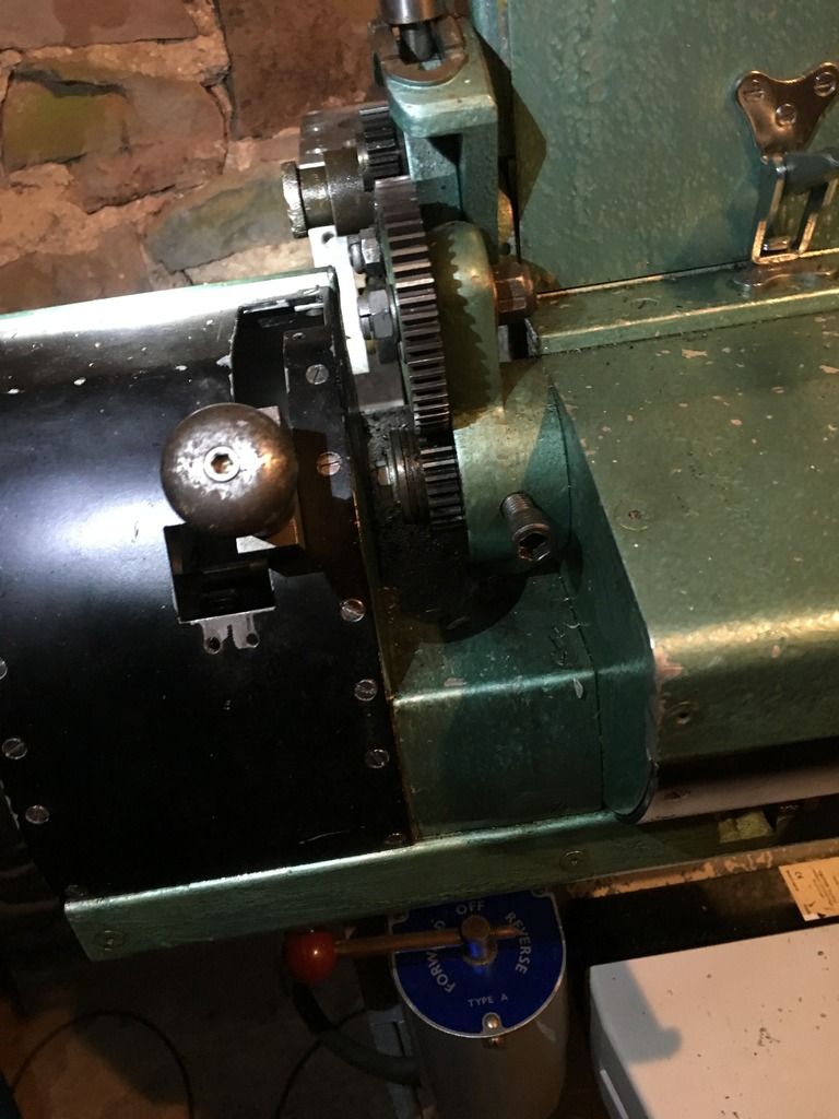

PS: Aha, I have found the other photos in Taris's album so take the liberty of posting them here as this appears to be a most fascinating double gearbox set up, hooked up to the original Drummond reversing mechanism.
It looks to me like the problem may be the nut on the back of teh stud for GB1 needs tightening, when the gear is in the correct position. It is common to see these kinds of gears by putting a piece of paper between teh gears to make a small space of .002" or so when setting the stud position.
It may also be that the Allen head bolt sticking out the front of the banjo needs tightening to stop the banjo moving.

PPS, Taris, that is no Myford gearbox. It looks like someone made it themself. There were several designs published in Model Engineer back in the old days. I have never seen a double gearbox set up like this one though. It seems quite unique.
Also, the number of teeth on GB1 is not important, as long as it fits. It is only an idler gear so it will make no difference to the overall ratio, whether it is a 55 tooth or 60 tooth, or 160tooth. But if that is the gear you have on there, I am pretty sure it can be made to work by correct positioning of the stud and the banjo.
What can you tell us of the history of this Drummond? Was it used in a factory or something like that? Someone has put a lot of work into it, with all the gears and the covers over the headstock and some modifications to the carriage by the look of it. Do you have more photos of the carriage and tailstock area of the lathe?

From the photos it appears that when you move the reversing lever forward the carrier plate comes forward and is very close to the banjo arm that carries the 55 tooth gear. If they touch and prevent the detent pin on the reverser from engaging any torque on the drive will try to disengage the reverser gears. As Hopper says the 55 tooth is only an idler and could equally well be 60 or 65T and that would increase the clearance between carrier plate and banjo to allow the detent to lock in properly.
I've only the photos to go off so this may be irrelevant but I hope it helps.
By the way, What is the purpose of the flywheel in the left hand gearbox?

It may be that you have tight spots and loose spots as a gear rotates. You have to set the clearance on the tight spot with a piece of paper between the teeth of the two gears.
Starting from basics you might have to loosen the Allen head bolt and swing the banjo away from the other gears so GB1 is no longer engaged with B. Then set the clearance between GB1 and GB2 by loosening the nut on the right hand end of the stud that GB1 rotates on. This stud and nut is mounted in a slot to allow adjustment. Slide the gear GB1 up or down the banjo until a piece of paper fits between the teeth of GB1 and GB2 at the tightest spot of engagement. Rotate the gears GB1 and GB2 and make sure they turn freely with no binding. Tighten up the nut on the GB1 spindle at this point, then check again to make sure the gears did not tighten up when you tightened up the nut.
Once you get GB1 and GB2 meshed correctly and spinning freely with no binding, you can now loosen the Allen head bolt on the banjo and rotate the banjo until GB1 and B are correctly meshed with a piece of paper between them for clearance. Tighten up the Allen bolt a little bit now. Rotate the gears and make sure there are not tight spots. If there is a big tight spot, put your piece of paper between the gear teeth at that point to set clearance and tighten up the Allen head bolt.
Now it should all mesh correctly. This is the standard method for setting the gears on all lathes of this type.
