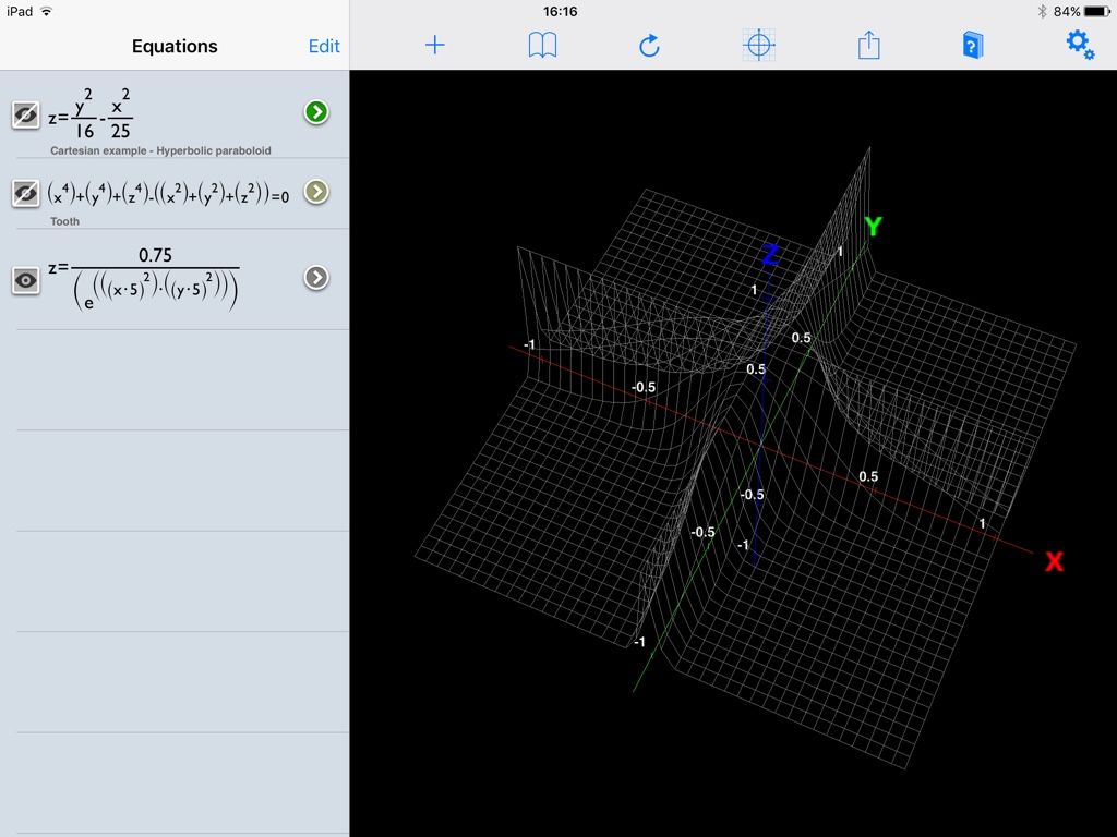

Michael Gilligan13/12/2016 13:46:18
avatar
23121 forum posts
1360 photos
With John's advice, and the liberal application of parentheses ... I am nearly there with the 'intersecting fences'
... but mine look pointy, whereas the example by benjoffe has them curvy.
dont know MichaelG.

I suspect your axis scaling is simply different. He possibly has X and Y limits of +/- 2 or so. Possibly similar for Z?
John Haine13/12/2016 17:02:54
5563 forum posts
322 photos
You can see from the plot that the x and y limits are +/-7 in each case. The maximum value of the function is when either of both of x and y are zero, when the denominator is exp(zero) which is unity, so the max value is just the denominator, that is 0.75. I can't see from the picture here Michael. but as x or y get very big do the fences get very thin though their height remains the same?
Michael Gilligan13/12/2016 18:03:13
avatar
23121 forum posts
1360 photos
Thanks Muzzer & John,
This is the same plot, as a mesh, and zoomed-in:
It is now evident, I think, that the problem is that the 'digital resolution' of the samples is rather coarse
The App seems to default to +/- 8 on each axis, and re-scale when 'pinch-zoomed' ... but the resolution is not really sufficient to do justice to this particular function.
... Does that make sense ?

John Haine14/12/2016 15:54:56
5563 forum posts
322 photos
I think you can see from this "zoomed in" view that the fences get sharper as x or y increase, which is kind of what you'd expect when you look at the function.
