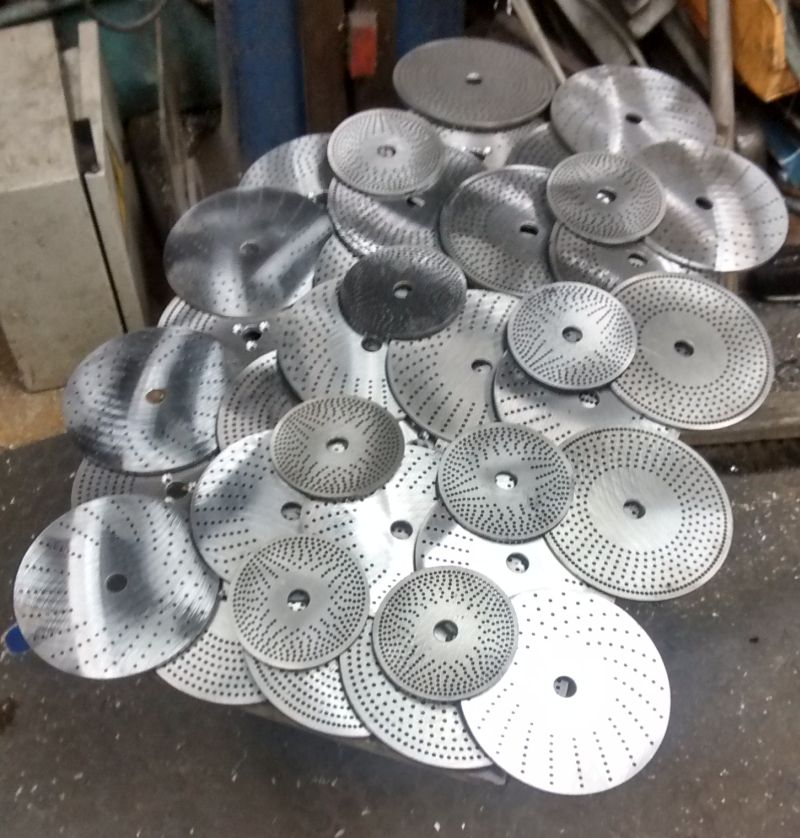

Hi all you clock makers. I have restarted my project to build a clock and find that the great wheel is 144tooth. No problem says I, set up dividing head and away we go!. Not quite as easy. The Myford dividing head is a 60 tooth worm wheel and 144 teeth calls for 5/12 rotation of the index handle per tooth. There are no index plates with hole counts that are divisible by 12, either in my workshop or available from Myford. Have I missed something here because several clock designs use 144teeth for the great wheel.
There are several alternative solutions that I have,
A. make a dividing plate with suitable hole counts.
B. use the simple dividing head in compound mode.
C.Use the Myford head with a 100tooth plate and a vernier to achieve 1000 divisions per rev of the handle. (this method is a bit irksome!!).
Some books refer to "Equipment mentioned many times before" which is very helpful!
Any ideas or solutions greatly appreciated.
JohnM

Some years ago when ower Gert was alive and selling on Ebay and Metoolsonline, we used to make loads of division plates.
Generic ones that mimicked the B&s ones but had extra sets of holes in like 63, 50 and 127.
Clones of the Myford ones but again with extra holes, 50 and 127 in this case.
But after talks with Alan Timmins who gave us a list of all the different division needed on clocks we worked out in Excel what hole numbers would be needed to produce these divisions using 40:1 or 60: dividing heads.
These were called our watchmaker plates, 4 in number and very accurately made and finished.
144 could be got on these plates at 60:1 ratio by using 10/24 and at 40:1 ratio by using 5/18
Since Gert died, Ebay and the Metoolonline site have been closed but hopefully early next year myself and the Delectable Debs hope to have the Metoolsonline site back up and running again to showcase what we made before and also some of Debs work as from about 14 she has been closely associated with the Scale 7 Loco Society making specialist products on her own lathes, mills and CNC.
To this end we are slowly stocking up on things like dividing plates, gear gauges, gears, drawbars plus a load more bits so hopefully we won't get down to low stock levels.

Save you the bother. Nothing on the 4 Myford plates have 12 x N on them.

I bothered anyway but should have known JS was right! What an omission. However as 5 turns on any plate advances the mandrel 1/12 of a rev, making a 12 tooth plate is trivial, then you're away....

Well thanks folks, loads of info in there. Route A, make a 12 hole division plate is best. I am surprised that the new Myford don't include a suitable additional plate in their range. At least I don't appear to have lost anything "round the edges" so to speak. Another point is that the tables with the Myford head stop at 100 divisions and don't include some of the prime numbers which makes one wonder whether the unit is going to be used out side it's design limits?
