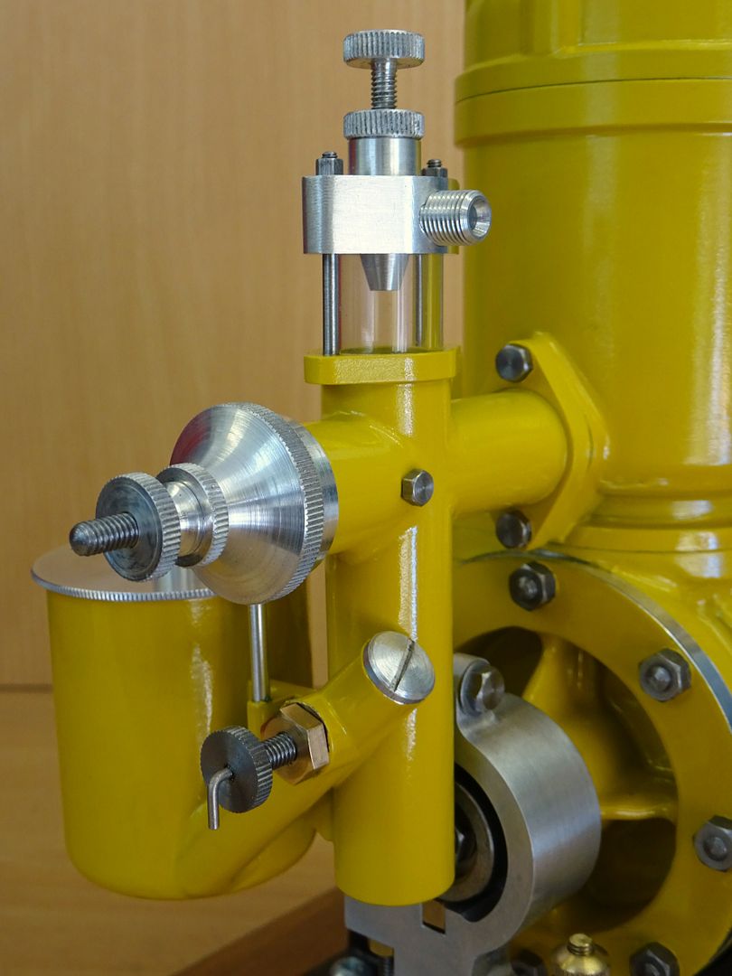

Model two strokes can have oil added to the carb rather than just mixed into the liquid fuel so don't see why that should not work on gas as the oil is drawn in by the fuel/air mixture, much like this one I made earlier, oil fed from tank or pump, needle to adjust flow, sight glass to make sure its working.
