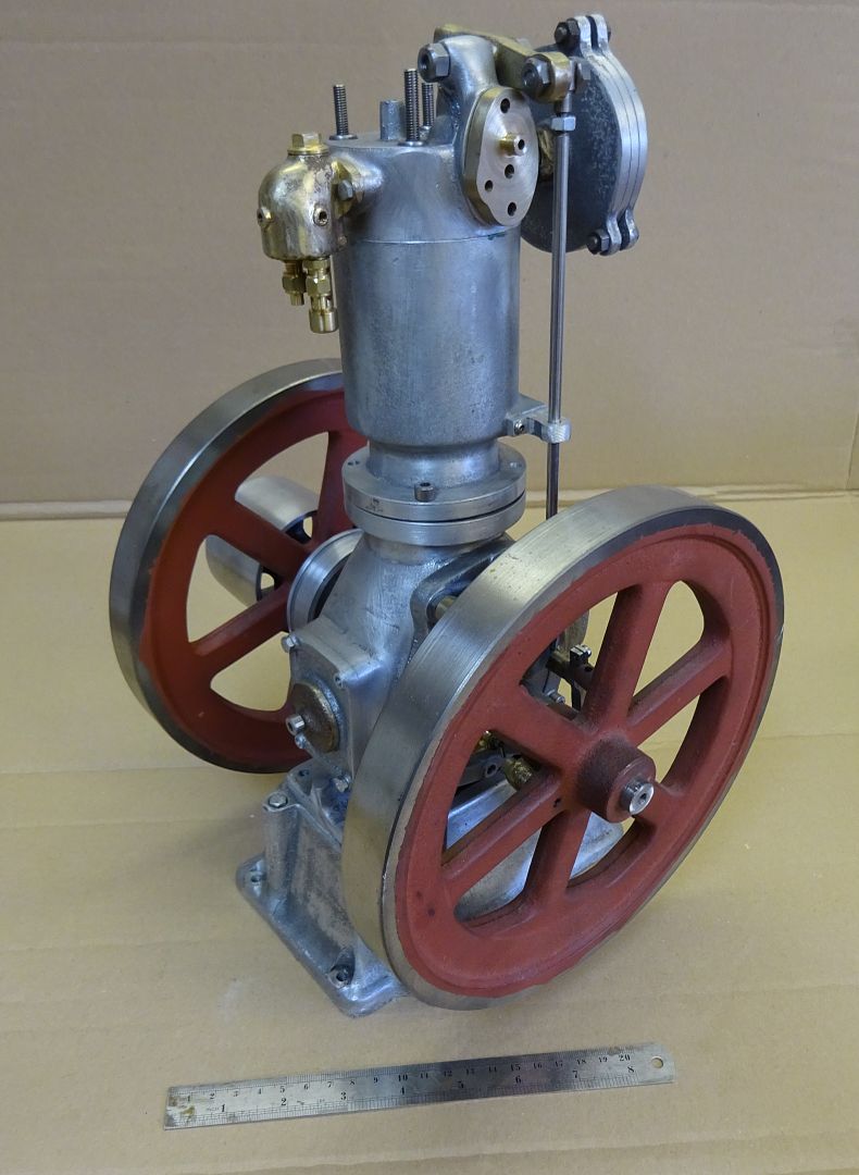

Brian and Phil, I want it for the side rails of a cart to mount a hit and miss engine on. I need to play around with some sizes as this engine was usually mounted on a simple wood sled with cast wheels but I have been asked to do it on an all steel cart that is more often found on the larger HP engines.
This is a rather poor scan of what it is likely to be like, not sure if you can make out the two inward facing channels with a timber cross piece. Hubs should be fun toofrown
J
This is the engine that will be going onto it, a 5/16scale Root & Vandervoort vertical which also has a large round screen cooler and water pump to go with it on the cart.

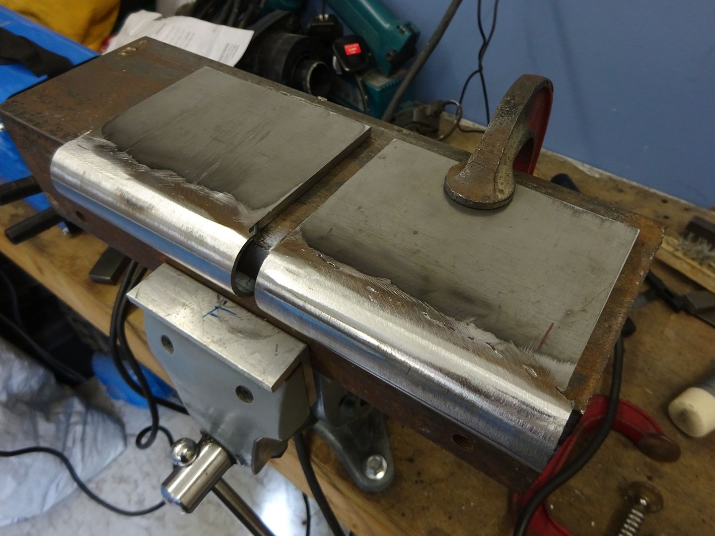

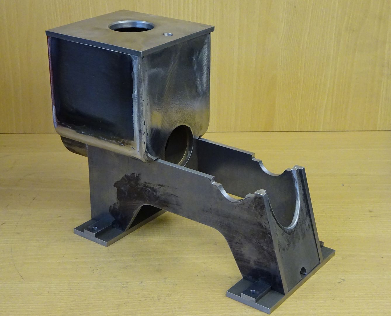

Thanks Duncan, I can get bent section but its a bit like cutting the box that Neil linked to - you get rounded external corners.
Funny enough I slit some ERW tube the other day to get some rounded corners, did not seem to move, at least not to my eyes but were 3mm thick. I welded the half sections to flat plate and then cut away half again to leave a 1/4 circle of the required 5/8" height
They form the sides of this hopper
