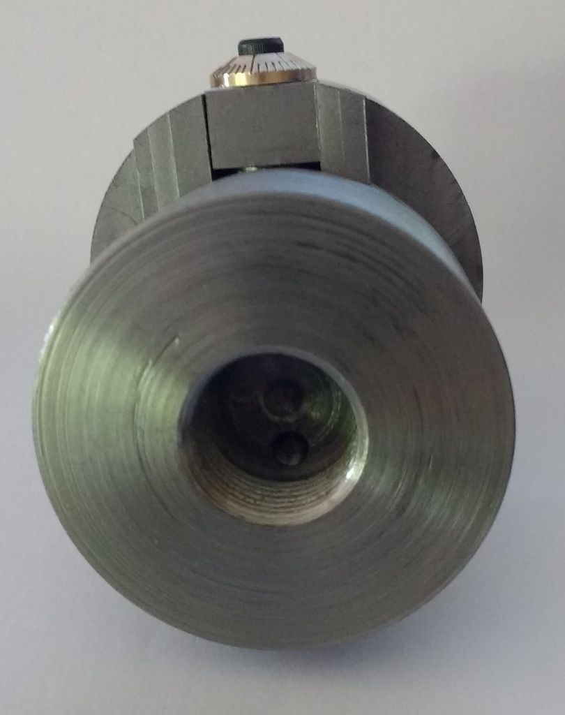

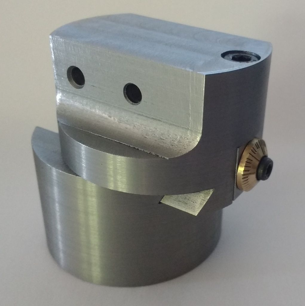

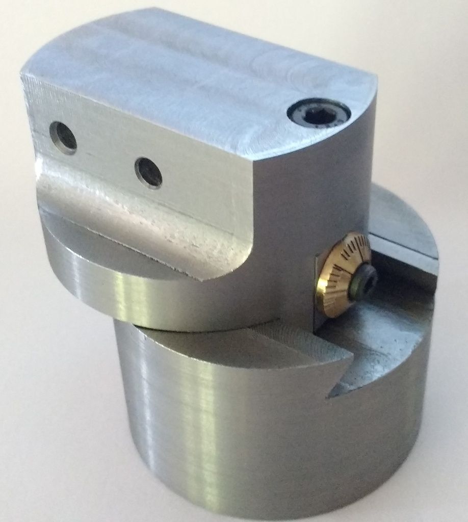

Jon Gibbs19/05/2016 11:19:22
750 forum posts
Hi Bernard,
Glad to oblige. First image is the head at full extent (maximum radius for outer boring bar). The second and third images are wound right out showing clearance to insert the leadscrew support and the position of the leadscrew nut underneath.
It's not perfect although the pictures are a bit unforgiving at this scale IMHO.
There was some backlash in the indexing during marking of the brass scale wheel which I didn't account for well. The only ball end mill I had was quite blunt giving a rougher finish than I'd have liked and there seems to be some misalignment between the flat and the radiussed portion on the sides.
As you can see I still need to bore the housings for the boring bars on the lathe - not sure whether to use 3/8" or 10mm. I then need to tap the set screw holes for the retaining screws. Otherwise it's done.
