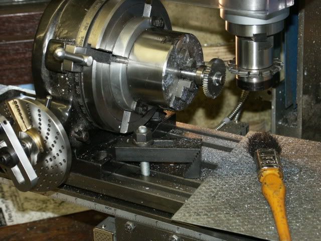

John Shepherd28/04/2016 14:27:02
222 forum posts
7 photos
Chris>>
Here is my solution for what it is worth. I also have another short version of the clamp like the one used on the rear for when the chuck is not in use. They work for both vertical and horizontal mounting.>>

David lawrence 328/04/2016 15:14:01
51 forum posts
John, those 2 special made clamps for the rotary table look fab. I shall have to make some for myself now, saves lots of set up time.
