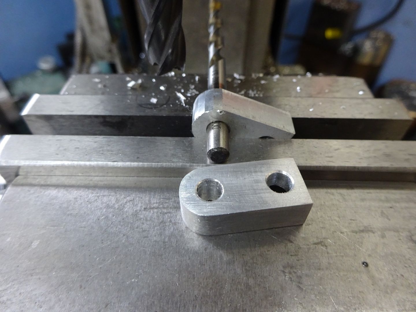

Feet
Machine two bits of Aluminium to 12 x 8mm and at least 24mm long, locate an edge and end then drill the two 5mm holes countersinking one to take the head of an M5 CSK socket screw.
Pop a 5mm pin into the hole and set a milling cutter 8.5mm above the vive jaws and then take a series of tangental cuts which will leave a facetted face as seen on the one in the vice. This can quickly be cleaned up with a file to leave a nice smooth curve as in the foreground.
A few M3 and M5 screws can be used to see how it all goes together, don't drill out the M3 threads in the side plate to clearance yet.

Bearing Caps
Start by machining two pieces of aluminuim to 10 x 10 x 28 and then hold in the vice and locate a side and end. Drill the two 3mm holes then the 1.5mm oil hole right through followed by a 6mm 2 or 3 flute cutter plunge 3mm deep to cut the socket for the bush.
Changing to an 8mm cutter plunge 6mm deep to form the counterbore to the 3mm hole and then the flat area 4.8mm in from the end.
The two side frames can now be screwed back together and the caps screwed into place. Locate the centre of the crankshaft hole, spot drill then open up with 6mm and 10mm drills and finally use a 12mm milling cutter to take the hole to size.
With the frames stood upright the 1.5mm holes for the bearing retaining pins can be drilled using the matching hole in the cap as a guide. Mark the caps before removing so you can assemble them in the right position in the future.
Using the same method as for the feet the tops of the caps can be rounded over to 10mm radius

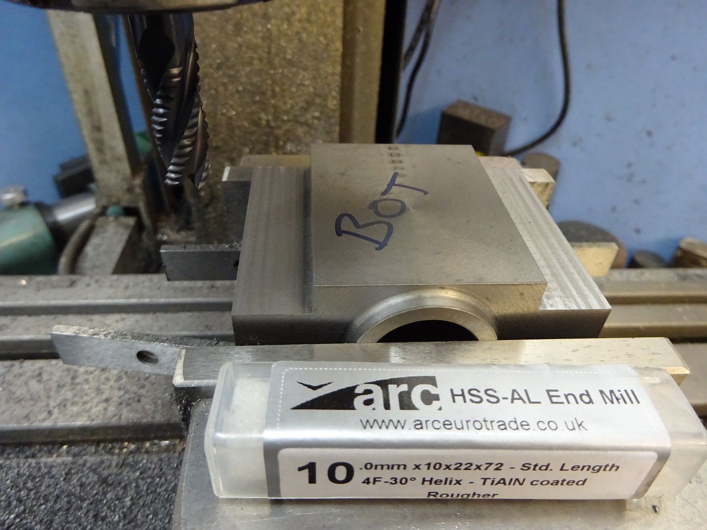

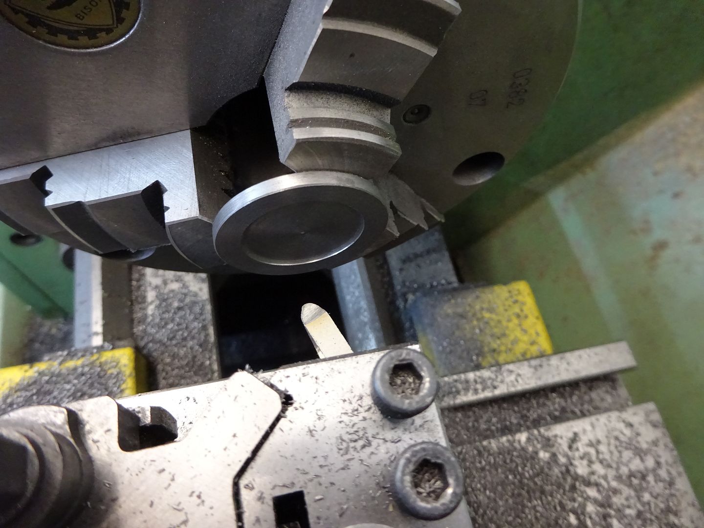

Cylinder
Probably the most involved part on the engine, if you don't feel upto it then the curved top and sides could be left square so you have a + shaped cylinder or even just leave it as a rectangular block.
I used and have shown Metric Fine threads on the drawings but ME 40tpi or even standard Metric Coarse could be used if you don't have the fine series taps & dies
The cylinder can just be got out of a piece of 40x80 cast iron bar as it comes out a little over these nominal sizes. I started by sawing off a lump with enough allowance to clean up to the required 64mm length.
Next the top and bottom surfaces were cleaned up on the lathe taking similar amounts off each to reach the 36mm finished thickness.
Then over to the mill to take a light cut off one edge
Then rotate the work 90 degrees in the vice and using a square make sure the first edge is true, a light behind helps to see any gaps. Once set the second edge can have a light skim. followed by the other two to bring the block down to size.
Mark the position of the bore in the middle of one end and punch.
Back to the lathe and set the punch mark to run true in the 4-jaw using a sprung centre and dti
Using a standard right hand tool the spigot was roughed out
Then completed with a round nose tool to give the 1.5mm internal radius, the punch hole saw also enlarged with a spotting drill.
And then starting with a 6mm bit progressively opened up to 22mm with a range of drill bits.
This allowed room for a sturdy boring bar to fit and take the bore out to the 24mm diameter finished size.
Then lightly chamfer the corner so the O rings don't get damaged when fitting the piston.

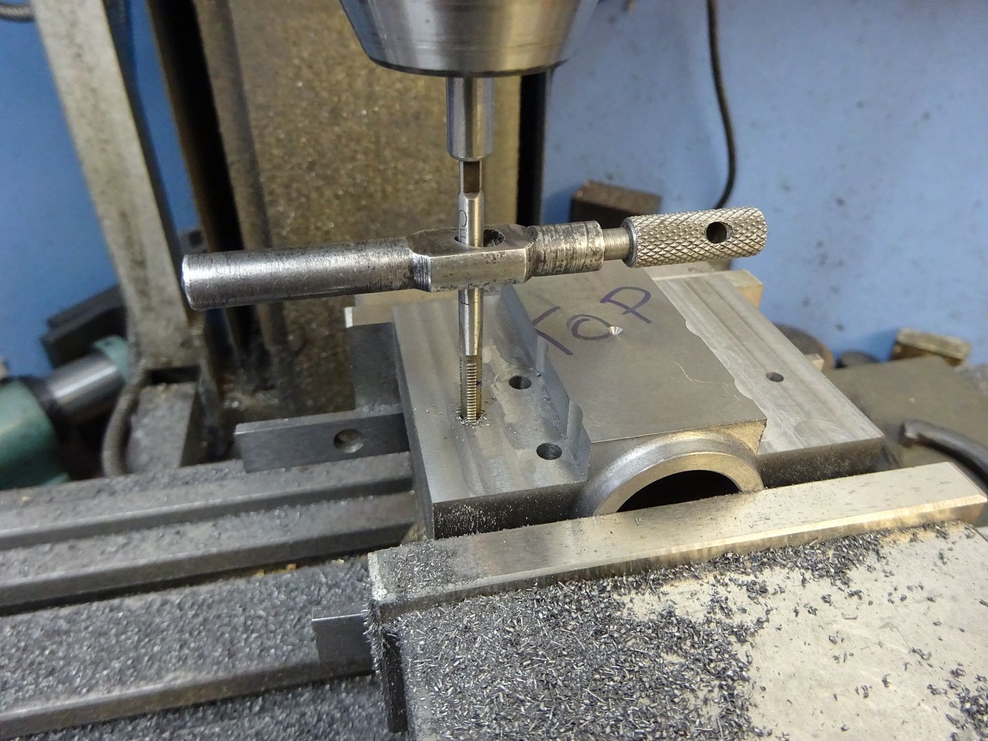

With the main bore in place next we can start to put some shape into the block. Starting with a newly purchased roughing mill from ARC the majority of the waste was removed 7.5mm tall and 3mm per pass.
And then with a 3-flute cutter finished to the required 8mm depth and 46mm width
Without disturbing the work the four M4 clearance holes for the hold down studs were added
Now working from the top the two waste areas can be milled away as before and the holes for the oilers added. I counterbored the cylinder hold down holes but unless you are using large washers that is not actually needed.
The three tapped holes can then be counterbored 1mm deep for bosses like the bearing caps.
Next the back end of the cylinder can have the six cover holes drilled & tapped M2.5, note I have altered their position on the drawing which avoids a clash with the steam passages.
The inlet side is drilled 9mm x 16mm deep and tapped M10x1 followed by drilling and reaming 4mm the rest of the way through, a standard 4mm drill should just reach.
The exhaust side is again tapped M10x1 by 16mm deep then drilled 6mm for a further 16mm before reducing down to a reamed 4mm hole the rest of the way through, finally use a 8mm CSk bit to form the valve seating at the bottom of the M10 hole.
The two steam passages can be drilled 3.3mm into the cylinder bore and the outer part tapped M4 for plugs.
The last hole is the M6x0.75 exhaust port which is drille dup until it breaks into the 6mm hole and then counterbored 8mm x 1mm deep

I'm more used to silver soldering crankshafts or cutting from solid so decided to pin the joints for good measure. Drill 1.5mm cross holes and lightly countersink.
Then push some 1.5mm steel rod through the holes and pein over the ends with a hammer.
All that remains is to cut out the middle of the shaft that is not needed and file the ends flush with the insides of the webs, the ends of the pins can also be filed down at the same time.
Check that the crankshaft turns smoothly in the bearings and make any adjustments that may be needed as its easier to do it at this stage. Once happy that everything turns freely the base can be joined together. I used a small amount of JBWeld spread over the 4 joints and then screwed the parts together on a flat surface making sure that the crankshaft turned as the screws were nipped up.
If you leave the feet off it is easy to clean up across the whole end to remove excess filler and any high spots if the parts don't quite all lay flush. Once that is done the feet can be stuck in the same way. I prefer to use an easier to sand filler for cosmetic filling so some U-Pol car body filler was used to fill the screw holes. The same filler can be used to add a fillet around the feet and oiler bosses.
