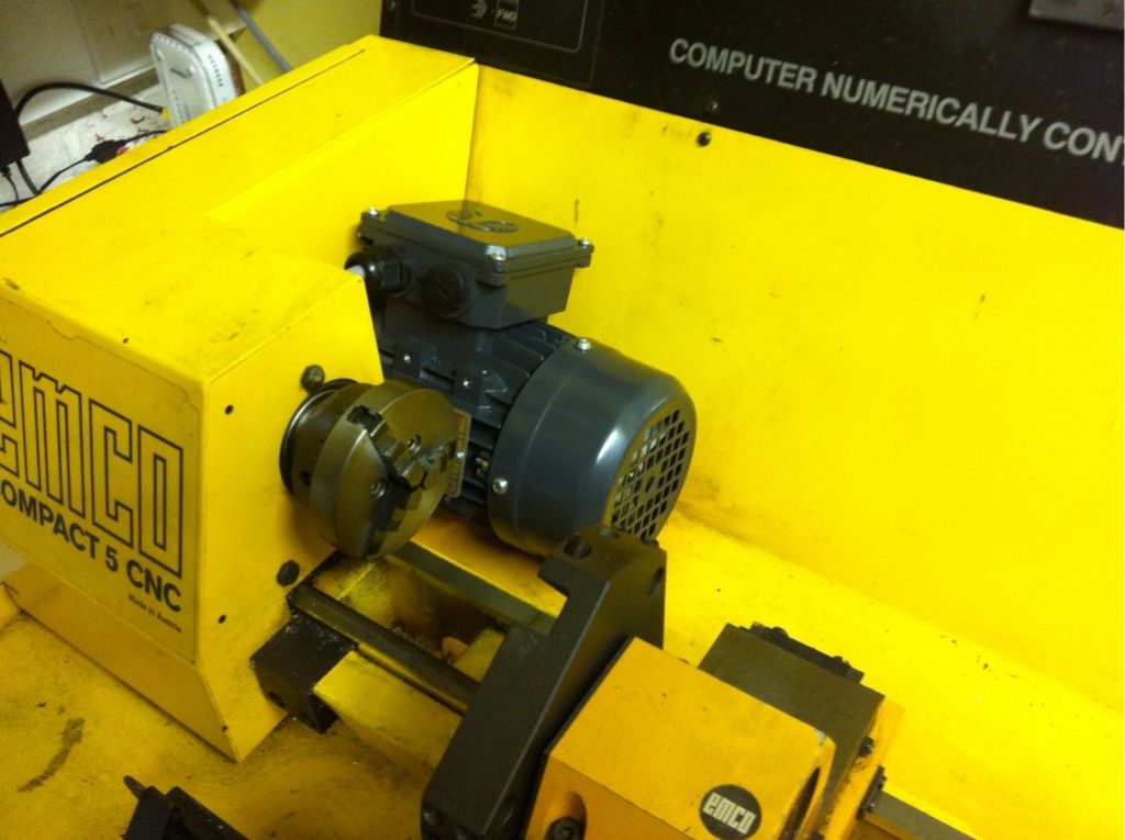

I have a problem with the motor for my Emco Compact 5 CNC lathe. This machine has a 180V DC brushed motor of some 440W. The fuse on the drive board blew some months ago: replacement fuses also blew immediately power was applied. I took the motor to a repairer who said that they had fixed a small problem with it.
But it still blows fuses. I installed a new board from KB. With the motor on the bench it ran fine but, as soon as I installed it in the lathe, the fuse blew. I suspect that the problem is down to a short circuit in the motor when it is running (it measures open circuit between the wiring and casing when stationary).
What to do? I cannot find an equivalent DC motor in my web searches and Emco do not appear to support this machine any more (even if they did, I would need to mortgage the dog to be able to afford it). So, do I change to a 3-phase motor & VFD? Find a brushless DC motor of suitable power/speed/size? Convert to treadle power? What does the collective wisdom of the forum suggest?

I am a happy boy again. Having given up on getting the DC motor to work, I spoke to Pete from Power Capacitors at the Ally Pally show (no connection, just a satisfied customer) and ordered a 3-phase motor & VFD. Bits arrived PDQ, but the motor came as a foot mount. The EMCO requires a face mount and Pete sent a replacement front cover out the next day. It was easy enough to change, but still no luck! The mounting holes would not line up...
I removed the cover again and, fortunately, four extra bosses are cast in at 45 degrees from the standard holes. They even have a dimple to guide a drill. Tap M5, put everything back together and it fits! VFD wired in and we have motion again.

The new motor is 0.37kW (½ HP), compared with 0.44kW for the original. The big change is the motor speed, down from 4,000 rpm to 2,800 rpm (3,360 if overdriven to 60Hz). A small price to pay to get a working machine.
Thinks: I will need to make/fit a motor guard before I do any serious machining. That cooling fan looks vulnerable...

Frame size is 63 and the mounting is a B14 face mount. I found that I needed to drill an extra set of mounting holes in the face mount (at 45° to the existing ones) in order to get the motor to fit. Fortunately the motor that I received (TEC) had bosses cast into the mount so this was a simple task.

The motor may well run up to 100 Hz to give you your max speed back? Lots of modern motors designed for VFD usage can be run at higher frequency I believe. On my big mill I have a very old Brooke motor that runs very happily at 75 Hz and that certainly wasn't designed for VFD!
DrDave27/02/2016 17:08:18
264 forum posts
52 photos
John,
Thanks for the prod: I have just had a furkle around in TEC's online documentation. They recommend a maximum frequency of 75Hz for the motor that I have. That should give a motor speed of 4,200 rpm. Bingo!
