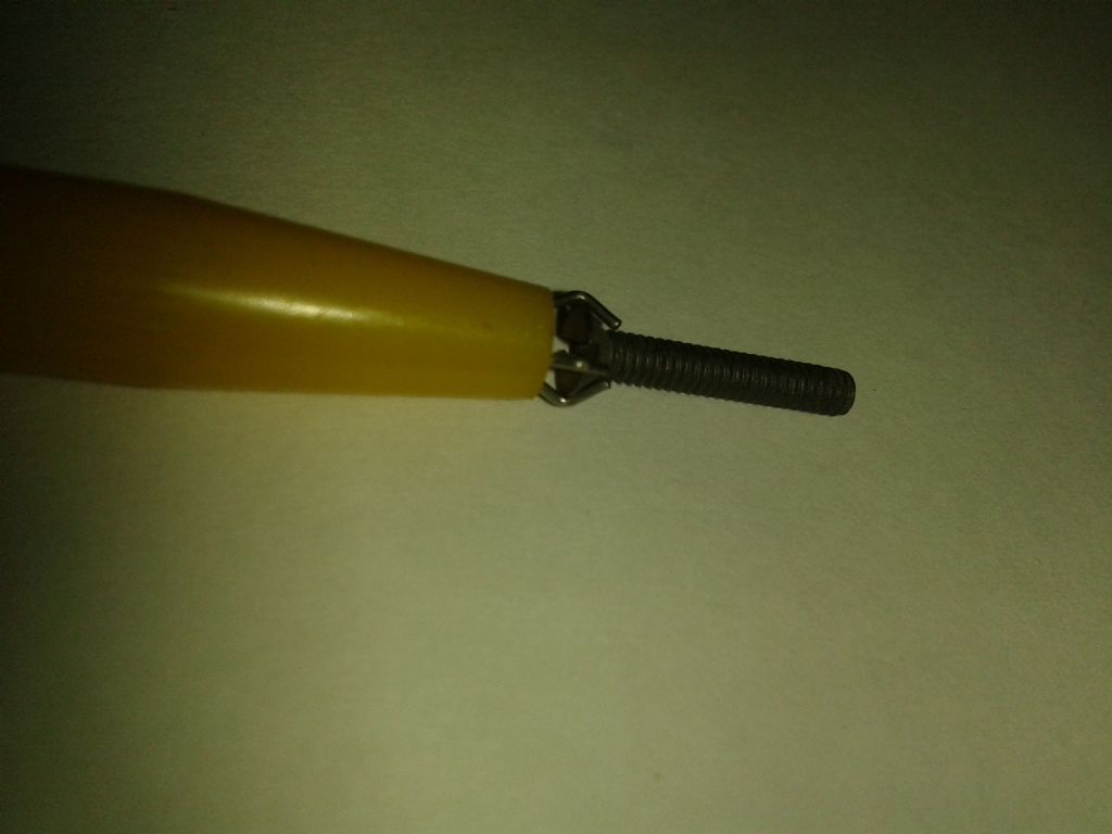

Fingers getting fatter ? Screws getting smaller ? I have had this handy little device for some years now. Use it to grip a small screw (8 Ba etc ) to help screw it into place. I see that they are available from Radiospares 537-293 £1.30 - Other good stores may also sell them.

Reminds me of this cheap little red plastic gadget:
It's just slipped over the end of a suitable screwdriver; shown holding a 4BA screw.
