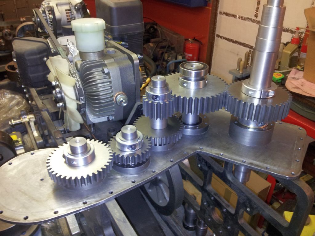

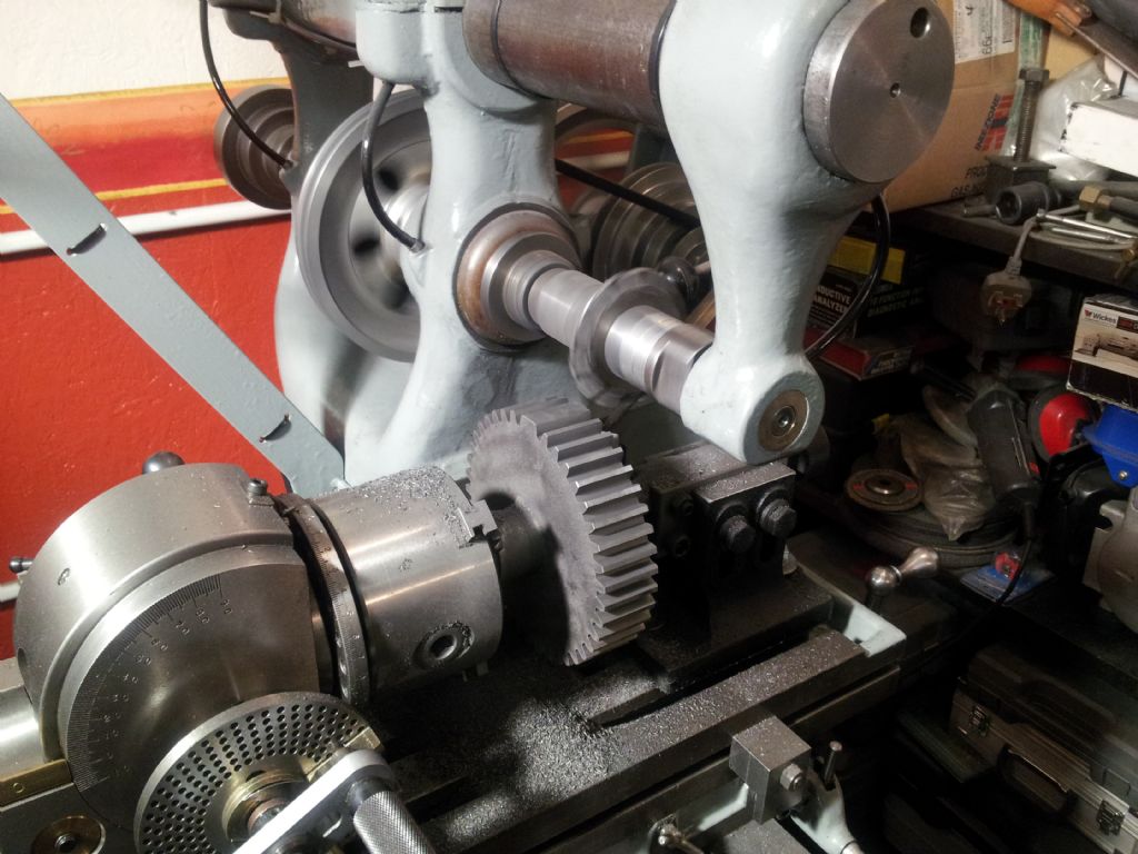

That is a lovely job. I have a hybrid Kerry Meddings drill as the base casting on a Meddings I bought was found to be cracked when I got it home and cleaned it. I bought a Kerry like this from a well known auction site as it had a nice column and was a floor standing machine unlike the bench Meddings. As I then found that the Kerry had suffered dentistry on the quill rack I made a hybrid from the two. Head and table are Meddings, rest is Kerry.
On the gear cutting question, get yourself a copy of Ivan Law's book on the subject. I bought a job lot of the Brown and Sharp cutters (guess where from) and designed my loco gearbox around the cutters I had in stock. The calculations for the safe power transmission capacity were found in a Machinerys Handbook, but that shouldn't be required for your model. I used a Vertex BS0 dividing head on an old Denbigh miller. The gears came out great for a first time effort.  I'll pop a couple of pictures on shortly.

Milling gears on the Denbigh H4 Auto of 1930s vintage
gear milling
Finished gears mounted on their shafts. Small ones are 10DP larger ones are 8DP.
gear train
