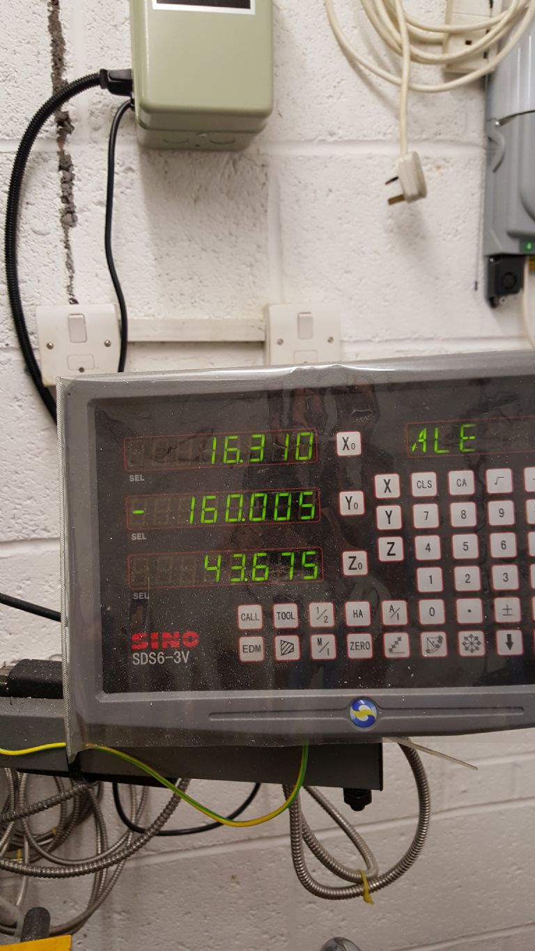

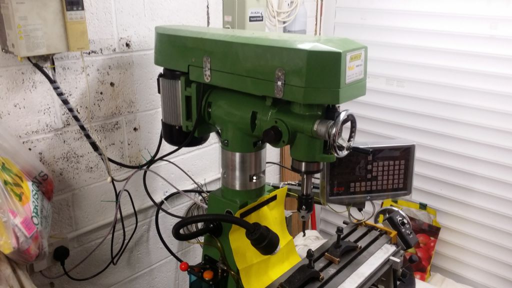

I recently helped a friend commission a new Warco VMC mill. We converted it to 3ph with a VFD and added DRO (from Machine-DRO) to all 3 axes and the quill. The latter combines with the Z-axis to give an overall Z-axis reading.
We put the X-axis scale in front of the table so as not to compromise the Y-axis travel, which remains at 160mm. Heres the mill showing the raising block.
Here's the maximum Y travel

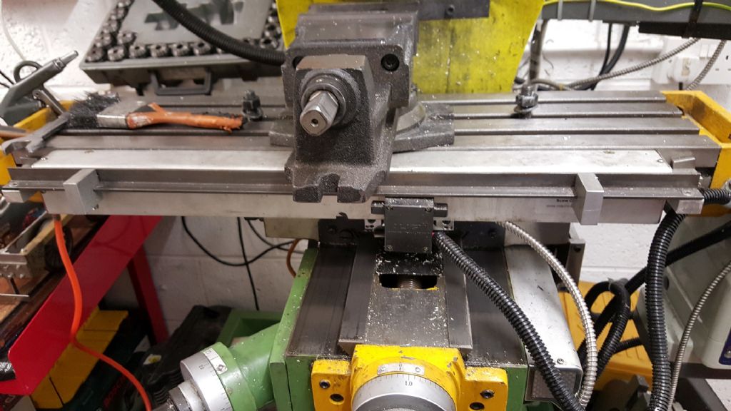

Here's the location of the X-axis scale.

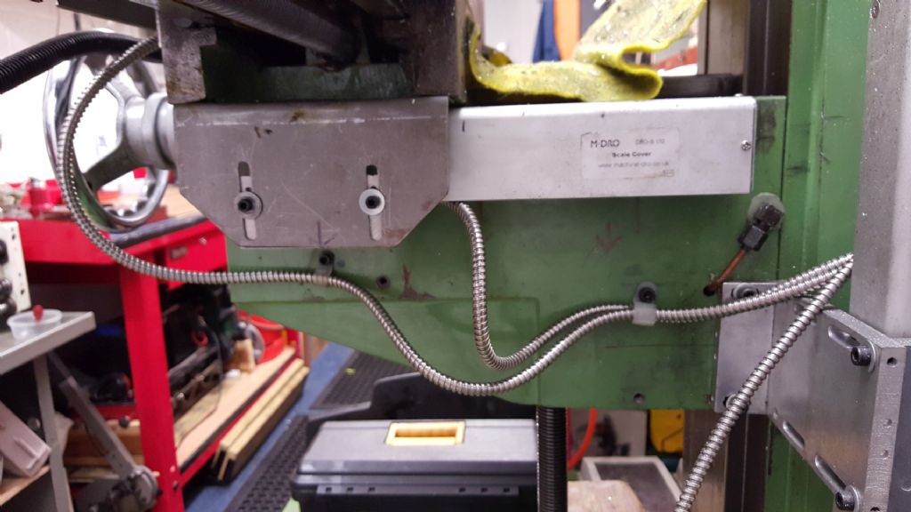

The Y-axis scale

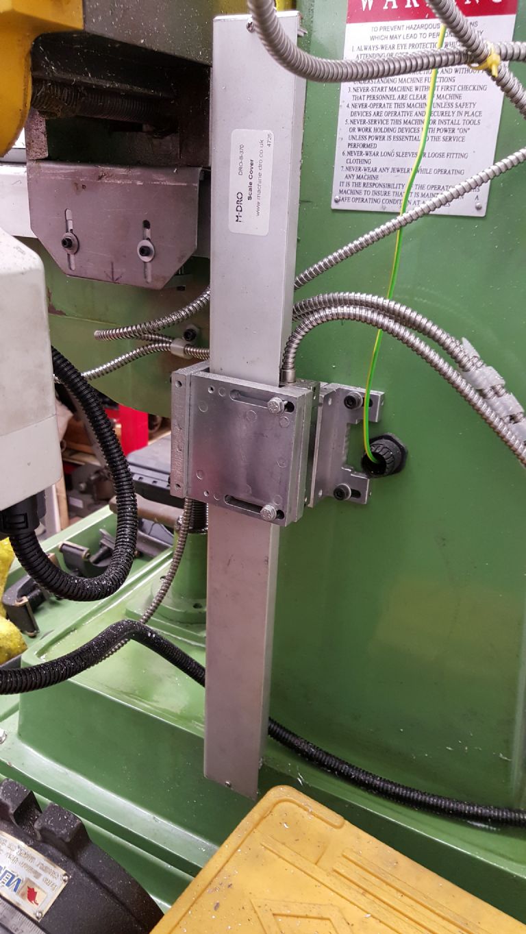

and the Z-axis scale

Gary,
Thanks for posting the pictures, it's always good to see how others have approached a project. I see you've mounted the z-axis scale on the righthand side of the machine. All the other installations that I've seen have this scale on the left - more food for thought! Now that I have a 200mm scale to fit on the y-axis, I, too, can do away with the mechanical travel limit contraption and use the (not inconsiderable) space that it uses up to mount the scale. I hope to make a start this morning after shopping.

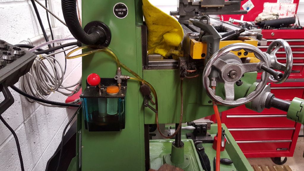

Hi John,
The Z-axis scale was fitted to the RHS because the the oiling system was on the LHS.
We fitted a small piece of angle-iron on the front of the table so as to retain the ability to use Y-axis stops.
