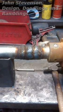

Did a long pump shaft yesterday in stainless, 50mm in diameter and a couple of foot long.
It had worn quite badly where the seal track ran and so needed building up and turning back to size with a good finish for the seal.
Shaft after welding with 316 wire.
Completed shaft.
This was turned at 1200 rpm feed of 0.07mm per rev and no coolant.
I did take a video of it but You Tube will not upload it although it plays on my computer.
