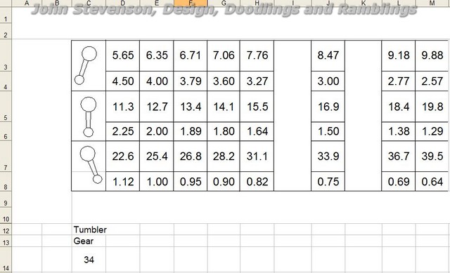

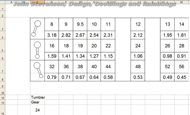

John Stevenson28/05/2015 20:51:22
avatar
5068 forum posts
3 photos
I did one some years ago for the Myford screw cutting box.
You just swap the driver gear from 24 to whatever.
That's the standard gearbox with 24 driver gear, again as standard.
Then swap the driver gear and you get modified TPI on top and metric underneath and this one with a 34 shows how many metric pitches are available with just the one gear.
