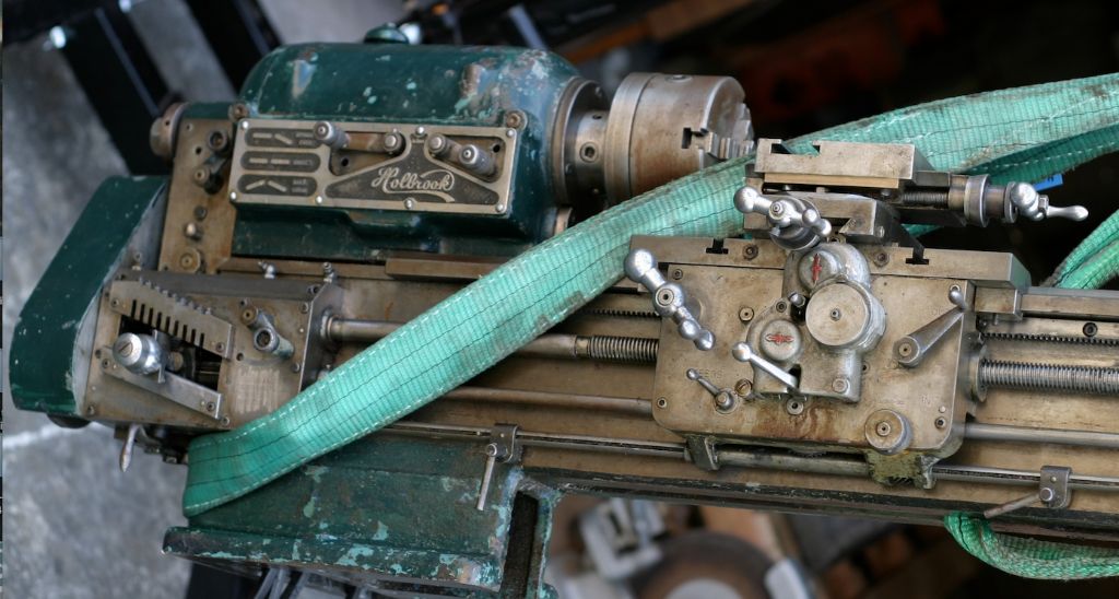

To add to my 1940s CovMac, a large lathe, I have this week fortuitously acquired a little one, from the same era - a Holbrook Model B No.8 Toolroom lathe.
A little beauty, with taper turning, it is presently lacking its pulley cone gear and counter-shaft. I would ideally like to connect with another owner, (or somebody with knowledge of this model), so that I can work out what it needs to complete these areas. I am just to be guessing at present. There is some remainder of counter-shaft arrangements on the back of the headstock. At present it only has, effectively, a single gear, running off the motor, its top speed of 1320 rpm. For its age, I would say it is in pretty remarkable condition. Very little needs doing to it, apart from cleaning, one or two lever knobs replacing, and pulley cone and counter-shaft replacement.
I will post more detailed shots as I go. This model of lathe seems to be highly regarded by Holbrook enthusiasts, and I am looking forward to ownership. It will help me complete a number of items contingent to restoring the big CovMac.
Holbrook, a firm based in Stratford, east London, later moved out to Harlow, Essex, and they were eventually subsumed, I believe, into the Alfred Herbert Group.
Of about Myford proportions, overall, 4 inch swing, and about 20 inches on the bed, I think she weighs about 500lb. It came with a 4 jaw and a 3 jaw chuck, taper turning unit, and a bit of cutting equipment, a few dead centres, drill chuck, etc.
Am bringing her home on Tuesday this coming week.
I would also like to track down visuals, or examples, of centre and travelling steadies, which I believe came originally supplied with this Holbrook model.
Most striking visual feature of this lathe is a milled front face to the whole bed. I have never seen that before. It is quite striking. It does not show up too well in this photograph. It has 27 screw-cutting options off its nine cog gearbox. How we attain three off each gear is not quite clear to me, yet.

Very nice, another great find!... but please that key out of the chuck
CHRISTOPHER MILLS 104/04/2015 17:32:31
avatar
152 forum posts
61 photos
Not me, Neil, it was the vendor. But he had at least taken it out before I arrived on the scene.
Oops, though, I am now remembering your publication protocol - and if you want to remove that picture, Neil, I am happy to get a better one without the chuck key.
Neil Wyatt04/04/2015 18:57:55
avatar
19226 forum posts
749 photos
86 articles
No worries Chris, I think it will act as a salutary reminder. Let he who hath not got a dent in his lathe cast the first stone...

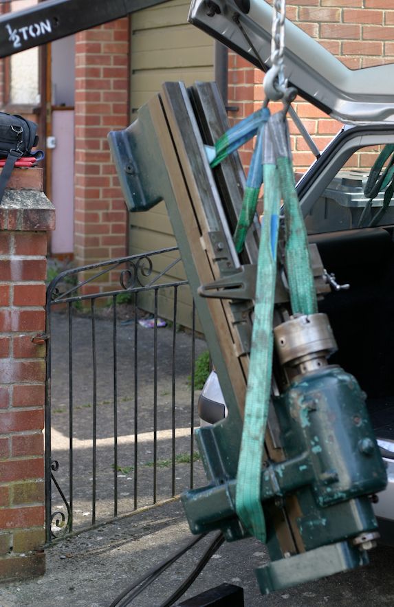

This lift looks alarming, but this was the only way to balance and pick up a Holbrook Model B No. 8. Heavier than I thought, it was a struggle for three of us to get it in the Passat - we got it out with two, under less hurried conditions. I reckon it is between 500 & 600 lbs of metal.
It is now safely stowed, and we damaged nothing, and nobody got hurt. The engine crane, as with the CovMac - a delightful lifter - but, with its steel wheels, a really terrible mover on anything but marble smooth surfaces. I might convert this baby to take rubber, mini car-type wheels. Any suggestions would be welcome. With rubber wheels, I am sure this would be so much more versatile a machine to use.

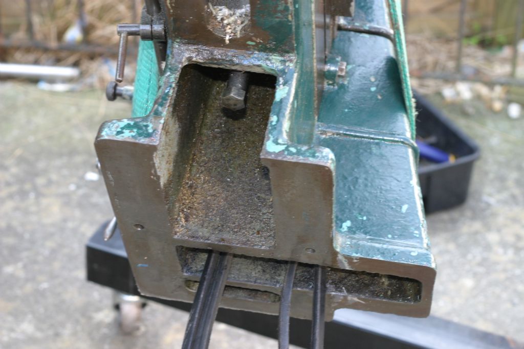

This Holbrook lathe originally ran a 2 HP variable, step-less speed motor made by Ward-Leonard, with a top speed of 5,000 rpm. The strength of machine castings, shown here in an underside view of the headstock, proves how it was designed to take such input.
Apparently, at top speed of 5,000 rpm, according to lathes.co.uk, you could balance a coin, end on, upon the headstock. Probably best an old threepenny bit.
The variable motor is long lost - two previous owners were running it as a single speed machine - it presently has twin pulleys coming off a single phase 1 HP Brook Compton motor.

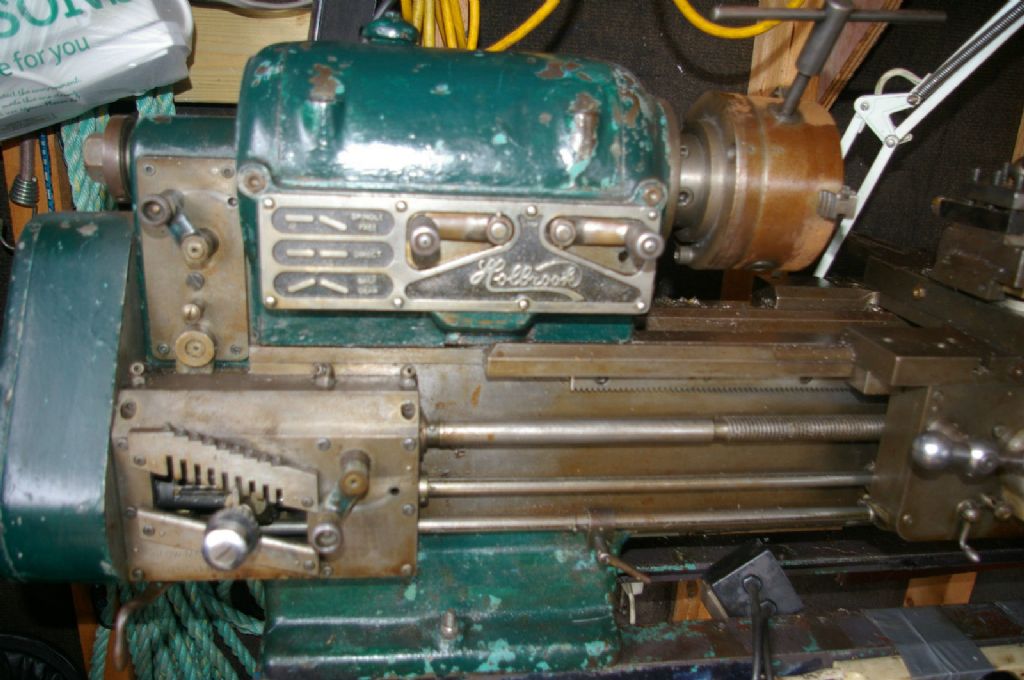

CHRISTOPHER MILLS 111/04/2015 11:38:36
avatar
152 forum posts
61 photos
Here is a better view of my Holbrook CB8, showing all its controls, some of which I have no idea of function in. One lever, central to the apron, has taken a bad bash, and is bent to the left. One refinement is a micrometer wheel which fine tunes movements in the carriage. You can see it bottom right of the apron front, a small wheel, beneath the lock nuts lever.
