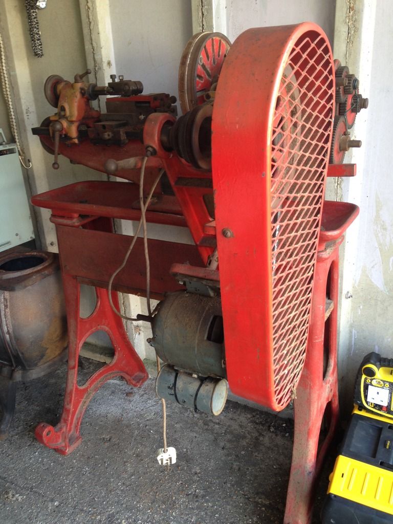

I recently purchased a Myford M lathe and was hoping someone might be able to tell me the very basics on using. At the moment I can't even figure how to turn it on! It's in my garage and I can't move it and dont have power there yet, will it run off a petrol generator?
How do I start it up?
Thanks in advance.

I wouldn't try connecting to a generator, not yet. You need to work out exactly what you have got.
If it is an ML7 - the M type most general for metal turning - there should be an electric motor fixed at the left of the machine, and at the back. The body stands on four cast-in feet. The motor should have a v-belt driving a bigger pulley on a shaft with a three-pulley cone, and another belt to the main spindle. Before you turn anything on, you need to check that the motor turns (by hand), and that when it turns the pulleys and the main spindle also turn more slowly, but without anything catching.
Before you start it, you also need to have it bolted down securely and level, or damage is likely to be caused.
Why not have a look and see if there is further information on the machine, and we might be able to help further. A photo or two would be wonderful, too.
Cheers, Tim

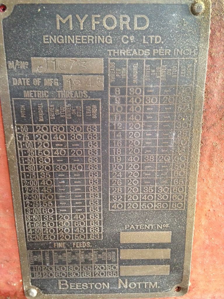

I'm not even sure what model it is - perhaps an 'M' Type post Drummond? Or ML2/4.
I've added some pictures below.
As you will see from the pics it has a 3 pin 240v single phase plug but this goes straight into the motor there is no on/off switch?
I just want to check it is running okay and sell it on to be honest as I wont use it, and want it to go to someone who will get use from it. It seems a shame to leave it sitting in my garage.

Big thing, has it a 13 A plug on a lead?, if so no big problem, you will need a generator of at least 1KW to start it but the running power will be lower.
If its got a three core mains lead, then if you recognise the colours, then fit a 13 A plug and go.
If its got a four core lead then the motor in the machine is for three phase and will not plug and play with domestic mains.
If there is no lead, then trace any cable coming out of the motor, it should go to some sort of switch, which if you are lucky will be labelled forward, stop and reverse.
Would be a good opportunity to turn the motor by hand and see that the belt moves OK and likewise the chuck. it would be a shame to power up the motor if any of the shafts in the lathe are seized.

I've turned the motor by hand and all belts turn.
Just strange there is no switch.
I'm pretty sure it is a standard 3 core plug which is fitted.

What a jolly looking - but quite old - device. Not ML7, but perhaps a relative?
Where are you, Harry?
Cheers, Tim

There is very limited info on the 'J' serial number, it is either a Myford 'M' type or an ML2/ML4 but i'm not sure.

All you need, I think, is an extension lead with a switched outlet. Best to have the switch handy to the lathe and not three rooms away. Please apply lots of oil to everything that can move before you switch it on.

It looks like a Drummond stand and Drummond M type tailstock but Myford ML motor mount so it might have been hybridised a bit in its life.
It is operated from the other side and the topmost moving slide (called the topslide in the UK) is 180 degrees the wrong way round.
Take the belt off the motor, plug it in, stand back and turn on. If the motor runs then smile but if the lump under the motor explodes don't panic, it's just a capacitor. But don't try and use it until all bearings have been cleaned and oiled, all slideways derusted or you will be grinding it down with rust particles.
Hunt around this site until you identfy it.

The M Types were originally equipped with a rotating switch known as a "Dewhurst". They are a safety hazard and many M Type users have binned them and just rely on the wall switch. If you are selling on I suggest you do the same for testing purposes, but point out to purchasers that they should ensure their own electrical safety arrangements through a professional electrician.
From the pics I can confirm it's a standard size Myford M Type, complete with the original Norman patent tool holder, countershaft, tailstock and belt guard. 1946 was just about the end of the production run. I don't think the stand is contemporary, it looks to be from an earlier time when these machines were foot driven, a bit like an old fashioned sewing machine; not that it matters much. The red paint is a later addition too.
Apart from change gears and chucks, the other significant missing bit is the cast iron cover for the gear train. As, when and if you sell it, advise anyone disassembling the machine for easy transport to be very careful with the cast iron motor plate unit; it's dead easy to snap it.
