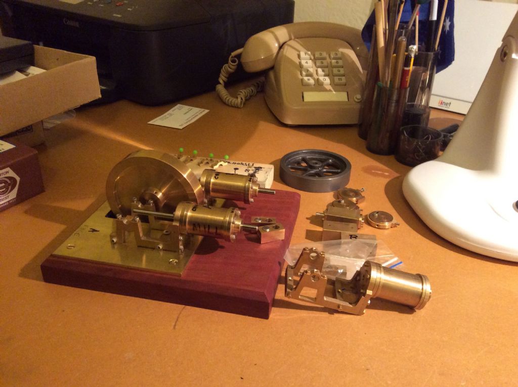

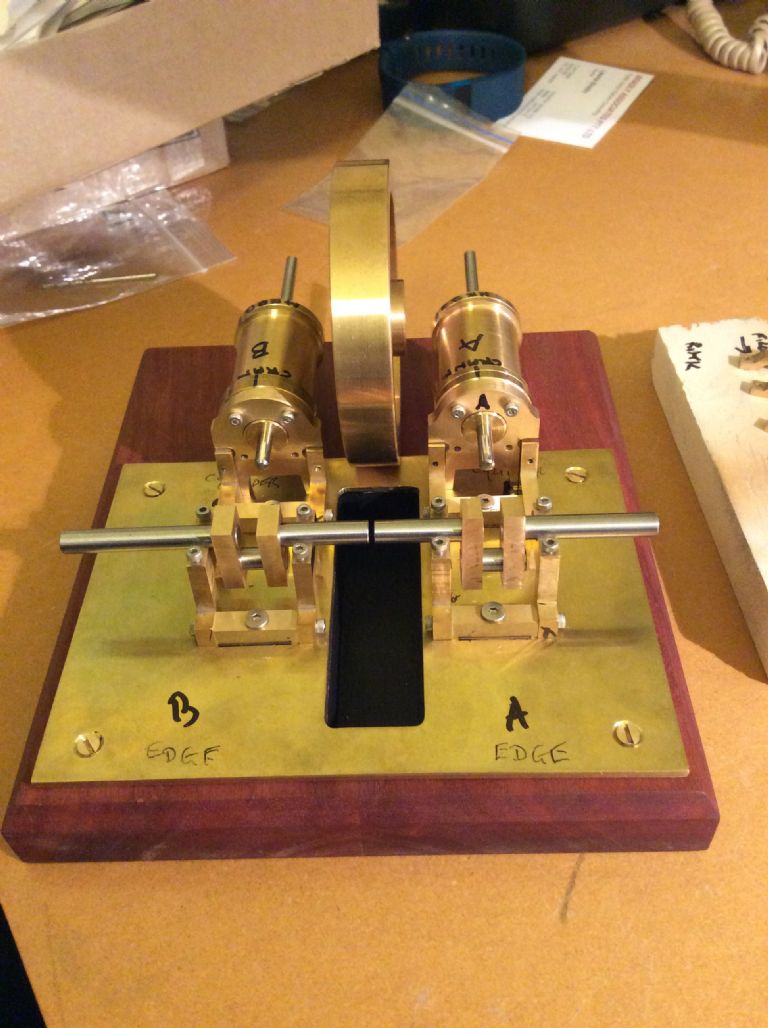

I thought people might be interested in photos of the bits for the single and twin cylinder versions of the engine, I have made so far. I had a bit of trouble getting the photos up, so I hope it works.img_2546.jpg

That is very nice work ; I really like the idea of a twin cylinder engine. How did you make your crankshafts ?
Lawrie Bradly05/08/2017 23:54:00
40 forum posts
15 photos
Hi Brian, The crankshafts aren't finished yet. I plan to screw them together with M2 x 5mm stainless steel grub screws. i drilled the holes 5.8mm and reamed them 6mm, holding them in alignment as I did it with short bits of silver street. It remains to be seen if I can retain the alignment in the process of drilling and tapping the holes for the grub screws (that I intend continuing a short distance into the silver steel rods) I'll let you know how I go. I may have to revert to solder, as specified in the Bends plans, but that looks like a fraught process to me.
