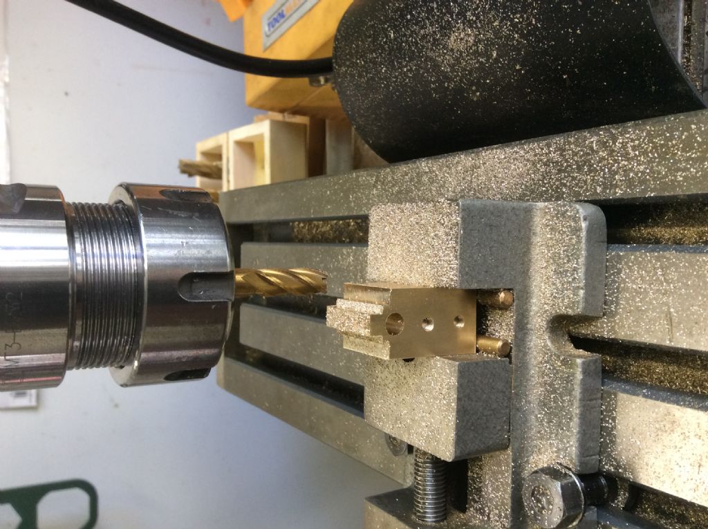

By coincidence, I finally got back today to milling the slots in the conrods of my Danni engines (a single and a twin - effectively three engines), I'm not getting a 'perfect result', but then if you aim at perfection you're bound for disappointment..

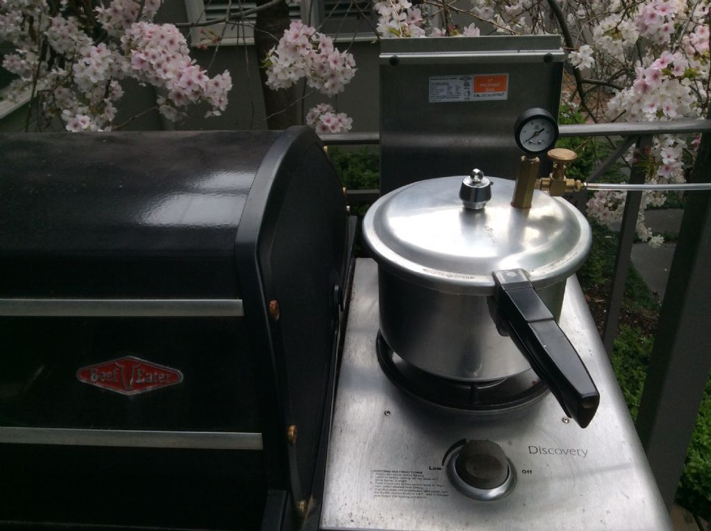

On the subject of boilers, here is my set up. Seeing it, some people laugh. Why would that be?img_2709.jpg

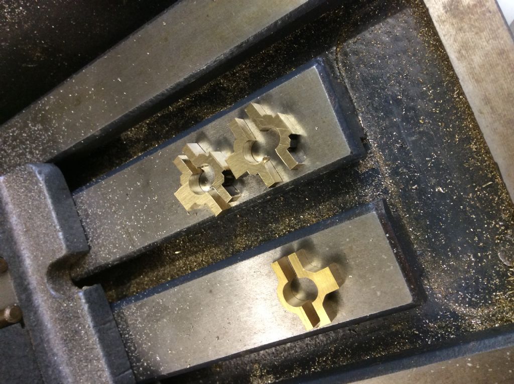

I made a bit of progress today on the big end bearings for the twin cylinder version.
img_2680.jpgimg_2676.jpgHi Brian,the steam plant is looking great.
The parts on the left are from the Bengs 'Danni' kit. It wasn't possible to replicate the radius on the scratch-made bits for the twin cylinder, so I settled for an approximate profile.
The opposing faces will need sanding down (on plate glass) to get the (now slightly oval) holes round and 5.8 mm diameter, then to be reamed to 6.00 mm. Drilling and tapping the M2 holes for the screws that hold them together is going to be a bit fiddly, but I've already done similar for the main bearings, so hopefully it'll be okay.

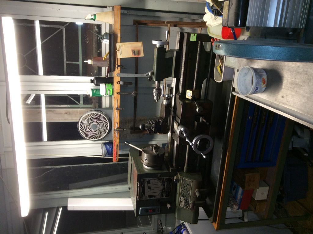

Hi Jason, Very well observed. I hadn't taken proper notice of the limitations of Brian's lathe. When I was looking around for one a few years ago a wise friend advised that, "You can do small jobs on a big lathe but (obviously) not big jobs on a small lathe." This steered me away from the Myford and Hercus hobby lathes I had been thinking about. As it happened, out walking the dog, I spied a bigger lathe stored in a garage about half a kilometre from our place. To cut a long story short I bought it for (I think) $1,200. It is a Tida model TD-4A and has 10" swing over the bed. Made in Taiwan in 1984. It is a gem. To get it home, I harnessed five mates to a pallet trolley early one Sunday morning and we pushed it, in places up the middle of the road. I'll post a photo!

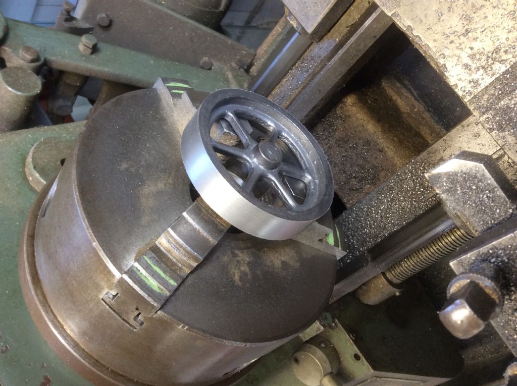

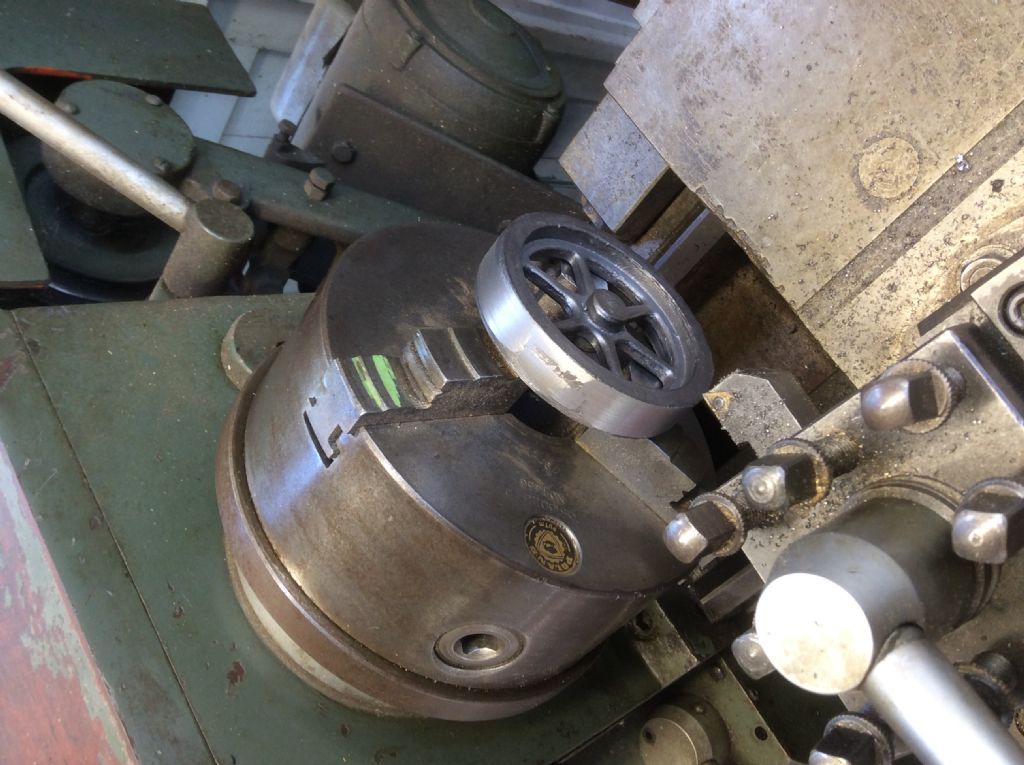

Hi Brian, I'm hoping I can replicate your success when I finally get around to finishing the steam chest and soldering it to the cylinder.. However, in the meantime, I really don't like the idea of packing the wood blocks to give clearance for the flywheel. For finesse, it should look like it looks in the drawings! In my limited experience, cast iron turns as easily as brass. If you've had problems, I think they probably have more to do with the cutting tool you're using, than the size of your lathe. I suggest you find the right tool and then turn down the flywheeel the extra 2.00 mm. To your credit, everything else about the engine is pretty much to spec. It would be a pity to deviate. Regards, Lawrie.
