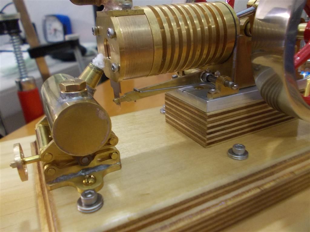

After much fiddling about and trying many things, I have realised that this burner as built cannot be fitted with horizontal adjustment. Any horizontal adjustment would mean raising it higher and even 4mm higher places it too high. I think the vertical adjustment on this is totally superfluous : at its lowest setting is where it is supposed to be so why raise it higher ?
Having ascertained that the burner must be fitted flat to the wooden base, then that means the adjustment wheel must hang over the edge and that means bringing the engine base in closer. The diagrams show the engine base to be right on the edge at the other end but that would mean it would be about 20mm from the burner flame...not very useful ! The engine base must be 18mm from the edge of the larger wooden base and this should put it in the correct place (hopefully). I have had to take the whole thing apart to redrill two more holes so I can shift the engine base.
NOTE 1 : the instructions do not give any measurements for placement of the burner or engine on the wooden base.
NOTE 2 : perhaps reducing the length of the wick nozzle would allow for some vertical adjustment. I might try that if I build another of these engines.

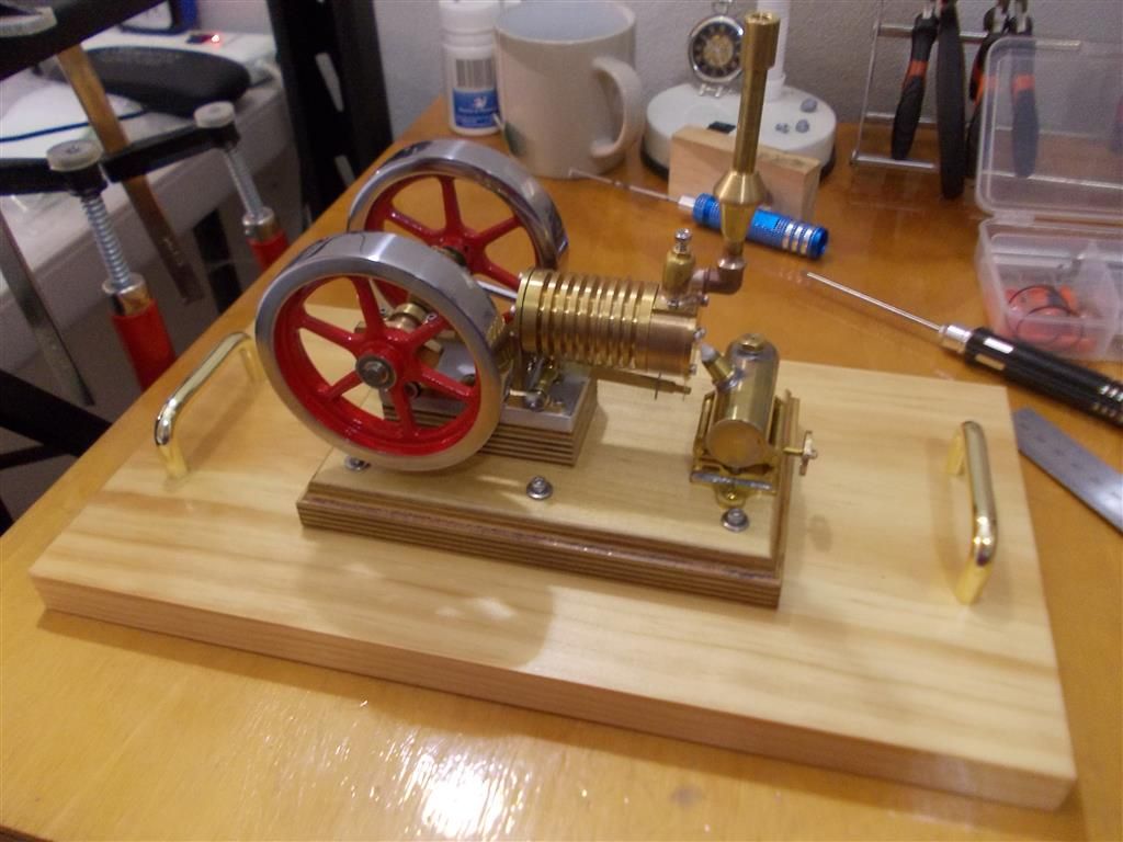

The spare parts arrived from Bengs so I have had another go at some of the parts which previously gave me problems. I have started machining the flywheels but this time I did not ream then out to 6mm; I just drilled them out to 6mm and I now have a perfect fit with the supplied crank and there is no wheel wobble. Same thing with the crank plates : they were drilled out to 6mm and not reamed for a perfect fit.
I did try to silver solder the cylinder bracket (part 19) but that was not successful as my soldering tile which was mounted on a wooden saw horse exploded due to the high heat. It really went off with a bang.
Lesson learnt : home made soldering station is only for soft soldering !
The instruction do not say which solder to use for part 19 but I have since received advice from Bengs that it is to be soft soldered.
I was going to silver solder the second crank shaft to the crank plates to see if it would distort as warned in the instructions but I think I will just stick with soft soldering it together as I did with the first set. I have had enough excitement for now.

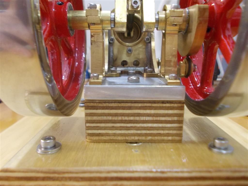

I tried to get this engine assembled and running today but I came across some unexpected problems. Because I made the slide control with a bush which is held on the shaft by two grub screws I forgot think about how I could adjust this once the engine was assembled. I had to drill some extra holes in the cylinder bracket (photo 9) so I can get the tool through there. The other grub screw can be accessed through the meths burner.
So I had to keep taking the engine apart until I got everything where I wanted it. The slide valve bearing which rubs against the eccentric gave me problems too and I ended up using bearing lock to hold it inside the brass sleeve.
But the biggest problem is the last : the slider plate will not stay on the slide control and falls out of the cylinder head (photo 10). I measured everything to see if I might have made the cylinder too long but that is all correct. At this point I am not sure how to fix this and I will have a think before doing anything. I might shave 0.5mm from each end of the cylinder. I could also leave out the gasket which fits between the cylinder and the cylinder bracket. All that should give me another 1.5mm which might be enough to keep the slider plate on the slide control.
 I have looked at photos of other builds and I notice that some people bend the end of the slider plate so this must be a common problem. I did try bending it but it still comes off. The end of the slide control rod is a bit too small to drill for a pin.

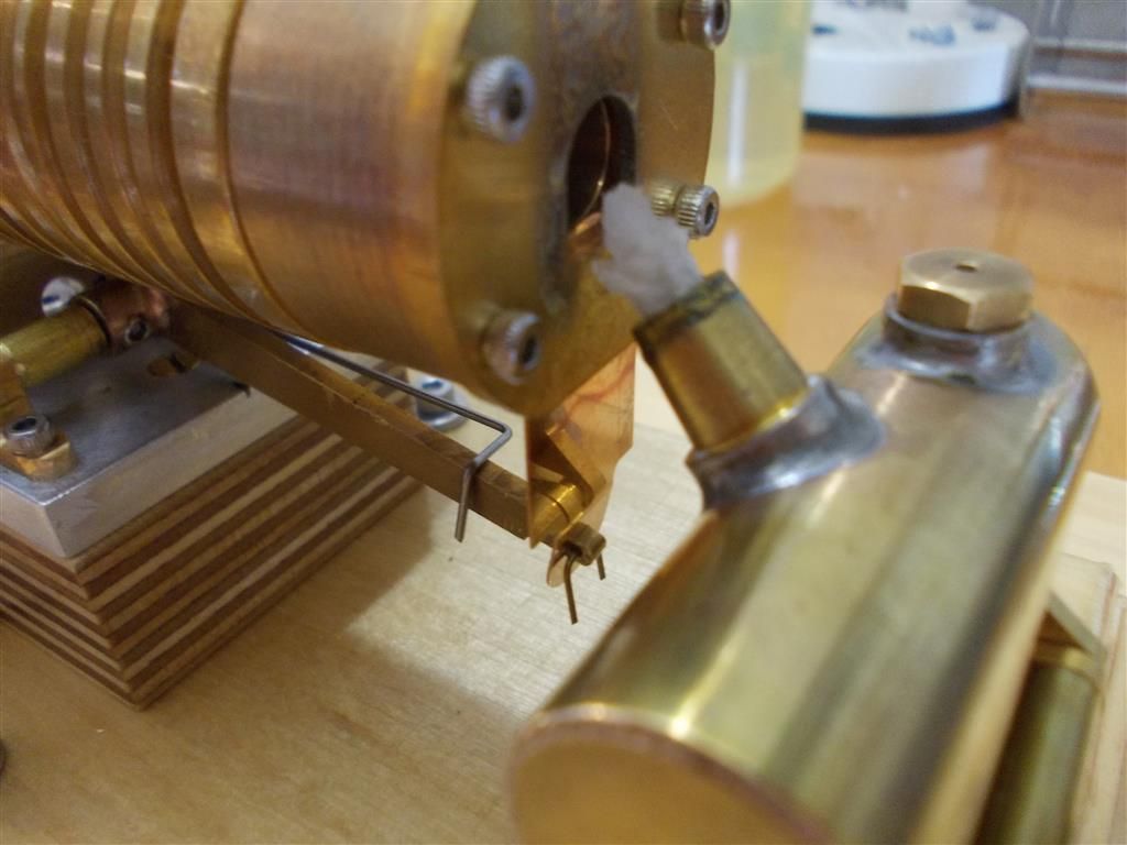

I did manage to drill a 1.1mm hole in the end of the slide rod. I then fitted a U-shaped piece of brass wire through the hole to keep the slide plate in place. That seems to have solved that problem but the engine will not run. I experimented all afternoon with various valve settings but no luck.
1. The instructions say that the slide plate should be closed just before bottom dead centre : is this correct ?
2. I am also puzzled about the ball valve : how high should I set this using the M3 screw in the exhaust ?
3. I do not like the look of the meths burner. The picture shows it on its lowest possible setting but is this still too high in relation to the cylinder opening ?
JasonB15/07/2016 10:27:28
avatar
25215 forum posts
3105 photos
1 articles
1. sounds about right
2. try 1mm of ball lift
3. don't have so much wick sticling out then the flame will be lower
Edited By JasonB on 15/07/2016 10:27:57
Brian John15/07/2016 10:31:17
1487 forum posts
582 photos
2. Only 1mm....do you mean the ball should not rise any higher than 1mm ? I had it much higher than that. Would that have stopped it from running ?

I trimmed the wick so that it was very short but the engine blew the flame out. I then removed the burner from the wooden base and trimmed about 3mm off the brass nozzle with the dremel tool. The flame seems to be at the correct height now. I will leave the burner unscrewed for now so I can experiment with the flame distance
The slider plate continued to give problems by getting stuck in the raised position so I removed the main cylinder and shaved 1mm off the cylinder head end. Upon reassembly the slider plate is now sitting correctly on the slide control valve so that problem seems to be solved. I should have done this in the first place.
I am now getting a very encouraging ''pop pop pop'' sound when I turn over the engine. It will only run for about 15 seconds before stopping. I tried lubricating the piston and cylinder with machine oil as I did with my Stirling engines but this made things worse and the engine seized up. I think the flame being in contact with the cylinder burnt the oil and resulted in heavy carbon deposits on both the cylinder and piston.
I cleaned the cylinder and piston with 2000 grit and I now have an excellent fit between piston and cylinder. It is even better than before. This time I lubricated by rubbing the piston with a lead pencil. Tomorrow I must buy some powdered graphite.
I have found the best setting the for the slide control valves. It is just as given in the instructions : the slider plate is closed just before BDC. Other than experimenting with the ball valve I am not sure what I can try next. It is very close but still no cigar ! Unlike a Stirling engine where you have to adjust both work and D pistons/cylinders, this engine has only one piston and cylinder. It should be relatively simple to get it going from here but I am fast running out of options.
